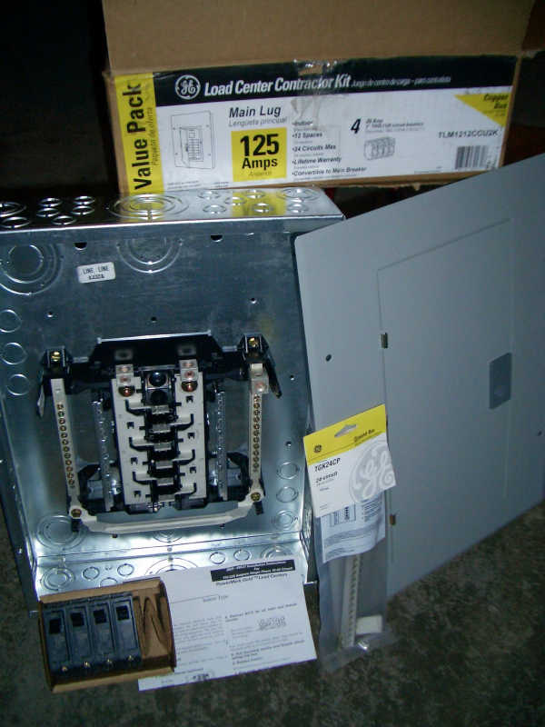

My electrical knowledge is basic at best. After searching around on TBN for some enlightenment, I concluded a 125A 24-space subpanel w/ separate neutral bar was a good choice. I found this GE panel and (4) 20A breaker package for $32 and the 24 terminal bar was $4. I know in the near future I will have a welder and it seems like this should be sufficient. Yes?

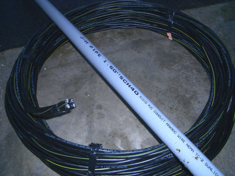

After consulting the book for drop, based on my approx. 80' run from house to shop, 2/0 Awg 4-wire would be fine for 125A. I went with the 4-wire because with the soil here, I didn't care to pound 2, maybe 3, 8' grounding rods in. Bot 90' for $0.95/ft. This IS the right stuff, right?

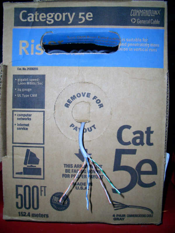

After talking with the inspector, I have decided to run the 4-wire electric service in the 1-1/2" Sch 40 conduit rather than bury direct. Also, I have some 4-Pair Cat5 laying around and think this might be the best way to get a lot of wire for alarm, telephone and computer into a 1" conduit along with the TV cable. If I pull (5) Cat5 that gives me 20 pairs, enough for everything plus a few spares. Sound ok, right?

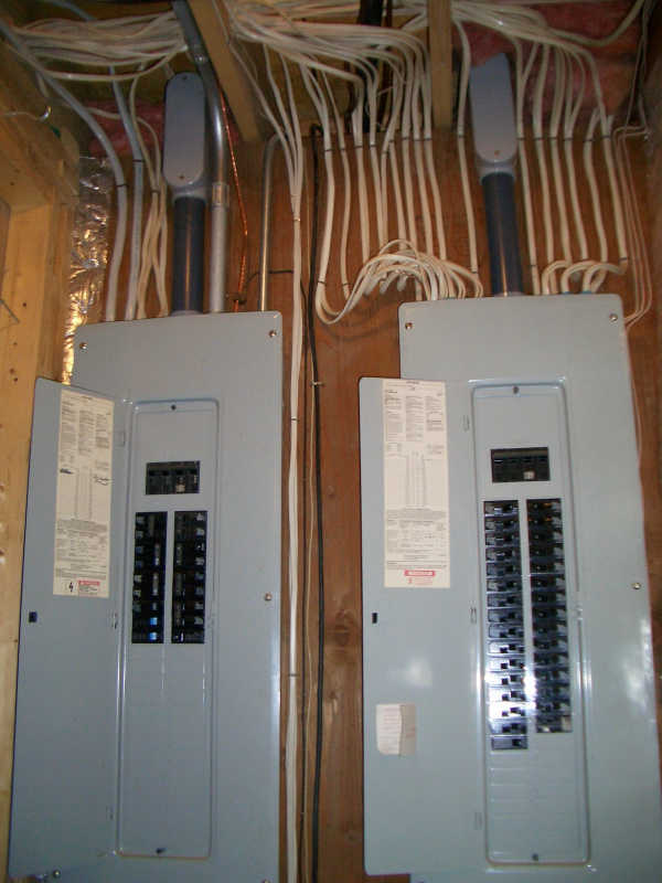

This show the electric service inside on the house end. The new line will enter the house right between the floor joists just inside the existing service elbows at top. The cable TV and telephone enter the house right here as well, and the primary alarm box is within about 4'. That was pretty darn handy!

Suggestion, contact the electrician that will do the final hook up and inspection. Generally I have found them to be more than helpful. I have done quite a bit of reading associated with electrical grounding and this seems to be a critical area associated with installing a generator system. Cheaper and much safer in the long run. Local codes also may apply.

I won't speak to the generator question but the cat5 is good. You can also use it with low voltage (12 to 24 V dpending on distance) to operate contactors so you can control high power from a distance, i.e. turn a light, compressor, etc. on and off. plus everthing else you want, security, phone and the like. Home Depot sells punch blocks and bridge clips that make terminating all that wire nice and neat. Then use the block to pull whatever you want off of it. Also, make sure you terminate each end of your RG on a ground block and use good fittings, might need an in-line amplifier if the signal is weak or ghosty.
Sounds and looks like a nice project. Keep updating.
