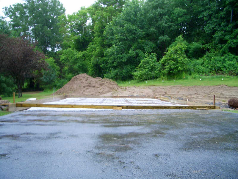

Front side is open on account of the concrete apron. There's about 6" drop from the right corner of the turn-around and the left corner, so that's got to be factored into the design. The 5/4 PT boards will be the break between floor slab and apron.

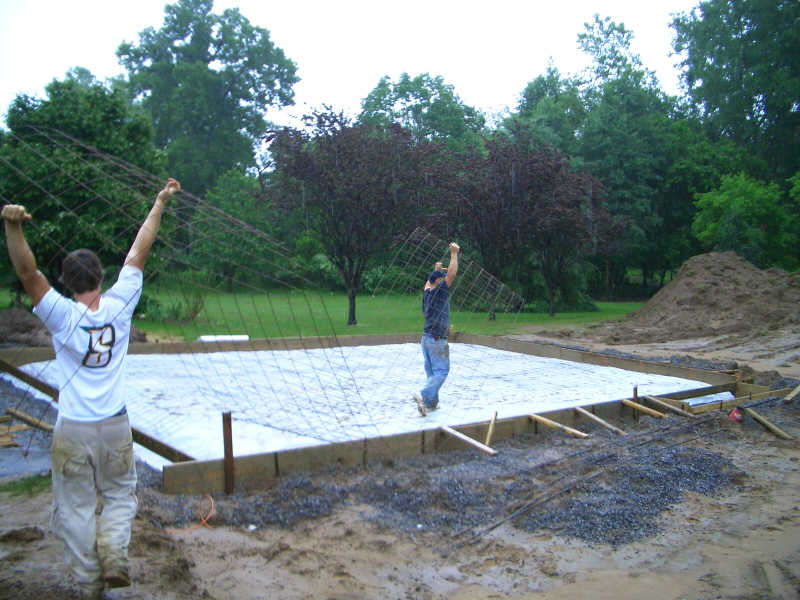

Last of the grid wire going in, really helps to have another set of hands. I'm sure they're wondering what they got roped into.

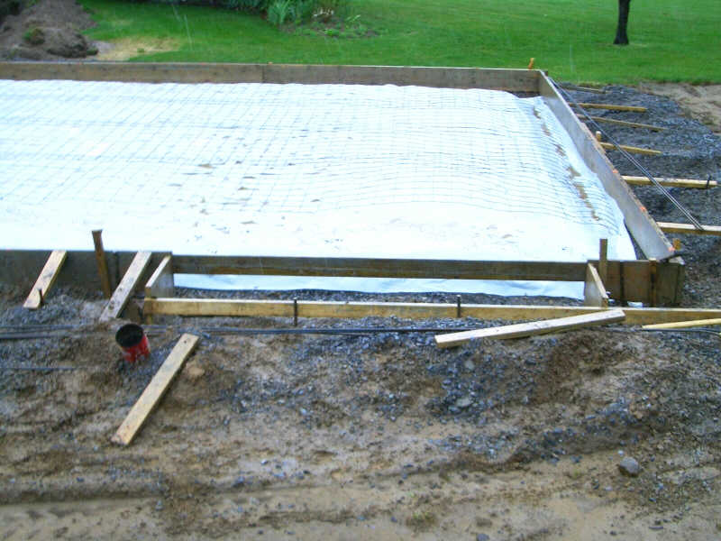

This is the apron framing for the side rear overhead door. Note the PT board being used for the slab to apron break is held down from the top of the slab slightly. This will allow the door bottom to rest on the [higher] slab and prevent water run-in from the apron.

Interesting job on the forms. I've never seen it done like that.
I'm not a big fan of wire, but from what I've read and been told, it's stronger then rebar if installed correctly. My problem with it is how hard it is to keep it in the middel. Most of the time it's down on the bottom, but sometimes it gets pulled up too much and it's right at the surface.
The apron is another new one on me. For such a small pad, why put in the board at all? Why not make it one solid piece?
Usually when something like that is added on to a building, it's done later. Such as porches, walkways and driveways. You just extend the rebar outside the pour to tie into.
What are you using for forms. It sure looks thin. Is it Preasure Treated? If so, why?
Your makeing good progress, thanks for posting the pics.
Eddie
   / So I got a good deal on some trusses...
#46
Pour forms sides are just dimensional lumber, 2X16-12' non-PT. None of the pics show the finished frame supports - rebar and bracing just about every 16" - that should be enough to keep things straight since there is less force pushing out on the forms with this type of 'tapered foot' slab vs a slab of equal thickness.
Love it or hate it, the wire is required by code. Folks around here often fabricate wire grid 'bridges' on site to help hold the mesh up into the middle of the pour. Well, at least off the bottom anyways. Local code also requires (2) continous rebar in the 'footer' portion of the slab, one at top and one at bottom along the thickened edge of the slab. Plus I'll be adding a 3rd rebar about 12" inside and a 2" lower than the top rebar around the perimeter for good measure. I like rebar too. /forums/images/graemlins/wink.gif
The reason for pouring the aprons at the same time as the slab is twofold. 1) get 'er done! 2) too little material to call in a truck for aprons only, too much to mix at home! The slab and aprons actually are all one piece, with the apron concrete tied into the slab with rebar and mesh below the PT boards. The boards simply act as crack control in case the slab really gets to heaving and, in the case of the small side overhead, a water dam. I figured the only thing worse than a crack in your slab is one that goes where you don't want it to go!
Also, having that front apron break will give me some flexibility down the road if I decide to raise that side of the turn around and re-do the apron. It falls off pretty quick as you can see in the pic.

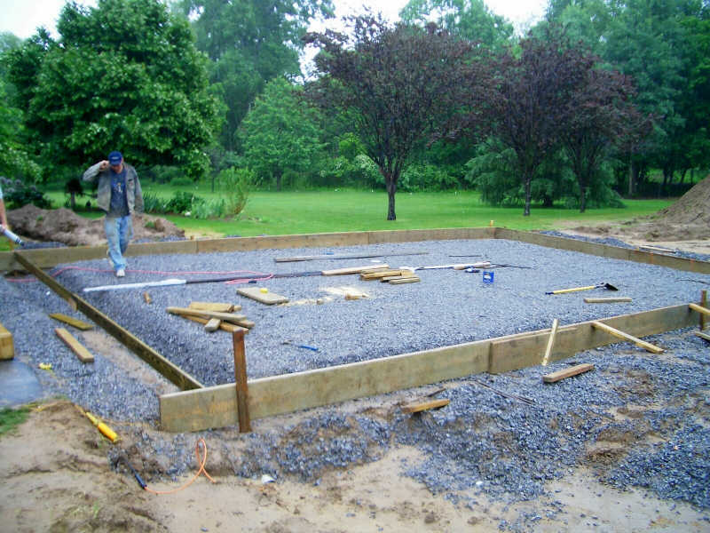

Eddie - here's a later pic of the forms all set and ready to go. Alternating rebar stakes and spiked 2x4 bracing about every 16"-20" or so. It's square, straight and level waiting for the pour. Corner rebar is all bent and conveniently placed for the masons. I want a nice, smooth machine finish so I decided to hire out the pour and finishing. It's tough work and hard to get right so well worth the professional expense IMO.
