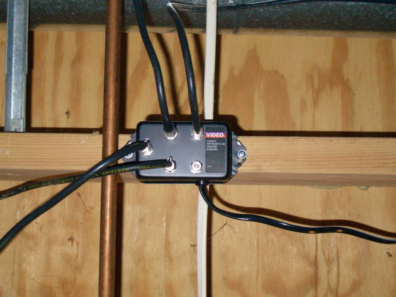

khd - your comment about the cable TV ghosting hit home. Never had this problem before, but I do have a cable amplifier in the new house. As luck would have it, there is one line out left to send to the garage. Will be about a 95' run I guess. Is that long? Here's a pic, no clue who makes it.

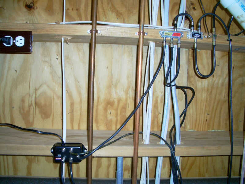

When looking at the cable amplifier, I realized what a spaghetti mess I have in the house. Main cable goes to a splitter, then one side to the home office for a dedicated high speed internet access, the other to a 3-way splitter. Two line outs go to exercise room and kitchen tv, the third to the amplifier. The amp line outs feed the family room, master bedroom and basement rec room. We have elected not to connect the CATV outlets in the kid's bedrooms. /forums/images/graemlins/wink.gif

Radio Shlock sells an amplifier similar to the one in the photo.

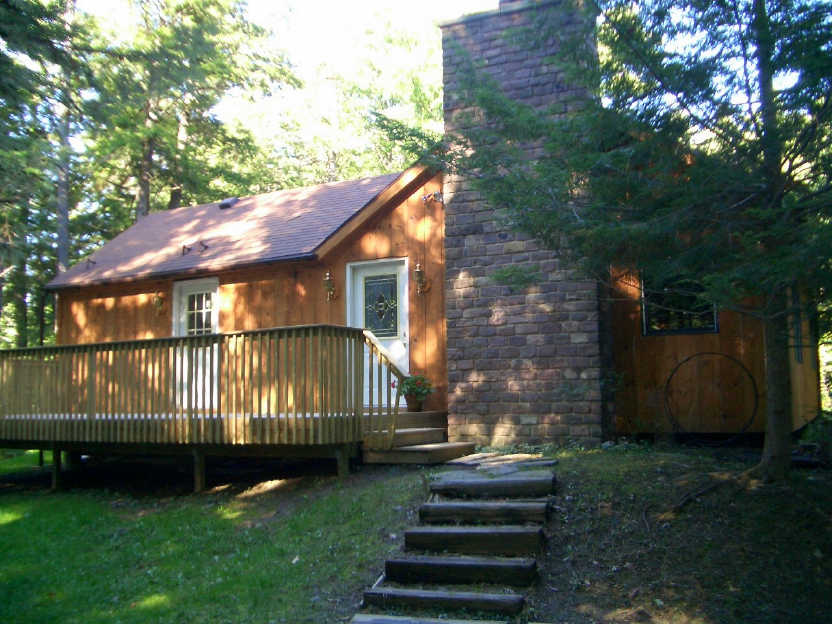

Farwell - seems like anything I ever put in conduit ends up wet, I don't know why either but water finds it's way into the smallest of holes it seems. I thought about using up some switches/receptacles leftover from my recent cabin renovation project (pic), but decided to use industrial electrical components. Thanks for the 20a receptacle tip.
