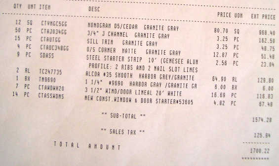

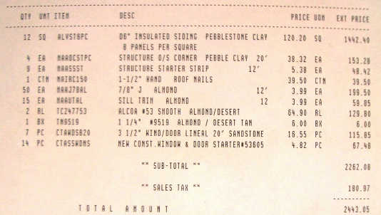

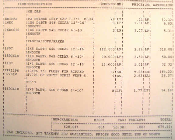

I ordered the doors and windows today, but need to make a decision on siding. Narrowed the choices down to:
1) Cedar (horizontal 6" exposure) - $628.81
2) Certainteed Monogram Premium vinyl (double 5") - $1,574.28
3) Hardee Plank cement siding (horizontal 6" exposure) - $1,625.10
4) Certainteed Structure Insulated vinyl (double 6") - $2,262.08
Pro's to vinyl are 'set it and forget it', both cedar and Hardee Plank need initial and periodic staining. Price to install vinyl is approx. $55/sq and Hardee Plank $110/sq. Is it that much more time intensive to put up HP? How much is cedar install compared to these?
So... ESTIMATORS - do these materials estimates look/sound correct/complete for a 24'x34'x9' - I didn't expect the cedar to be so much less?
Cedar estimate attached

Monogram double 5 estimate

Insulated double 6" materials
