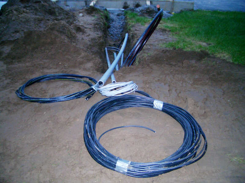

The water line is in - I ended up with a 1" water supply, mostly because the 1/2" was $14/100ft while 1" was $19/100ft and the 1-1/2" was almost double that @ $35/100ft. The electric service conduit is in and 4-wire pulled. Also got the data, etc., conduit in and pulled and the middle of the trench backfilled. Left both ends open for inspection.

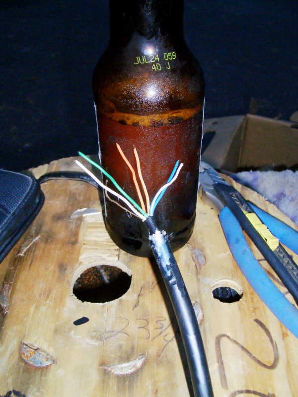

I got nervous after seeing Farwell's comment re: running unshielded wires so I scrounged thru the junk pile and found some shielded twisted 3-pair direct burial and decided to pull that in my 1" conduit in case the non-shielded didn't work. Funky wire, has a vaseline like goo inside the first sheath.

I was able to get (1) RG for cable TV, (5) Cat 5 twisted 4-pair and (2) of the shielded twisted 3-pair thru the 1" conduit with a little wiggling. I figure I can use the shielded for telephone and computer and the Cat 5 for alarms, misc. I like khd's contactor idea, maybe turn on the block heater, trigger the overhead door to open and fire a remote start for the tractor...

dh, don't forget that the shielding doesn't do anygood unless you ground the shield. Sorry in advance if you already knew that.
