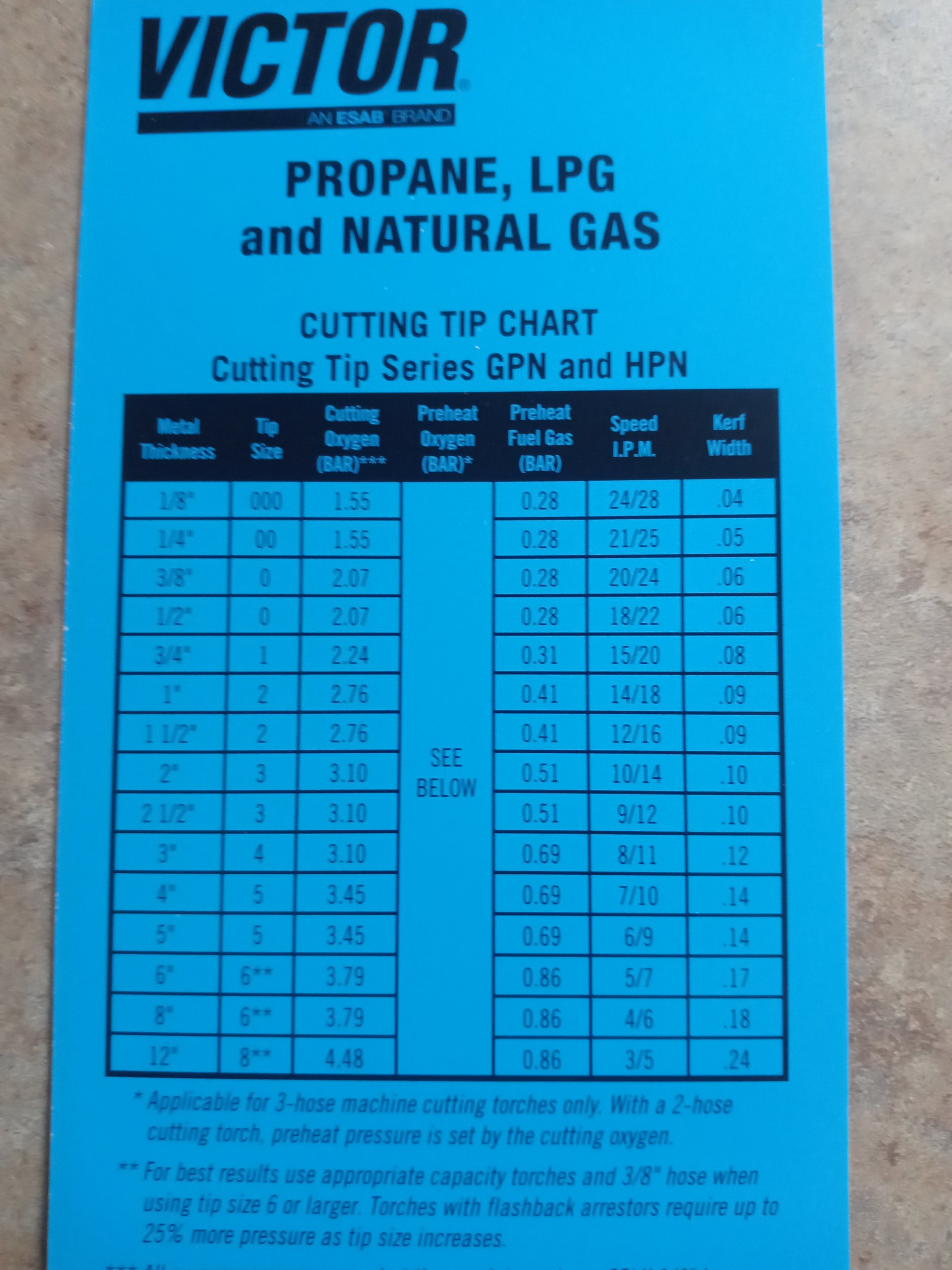

   / Some basic torch advice #23
First post but here's victor for acetylene
   / Some basic torch advice #24
and propane
