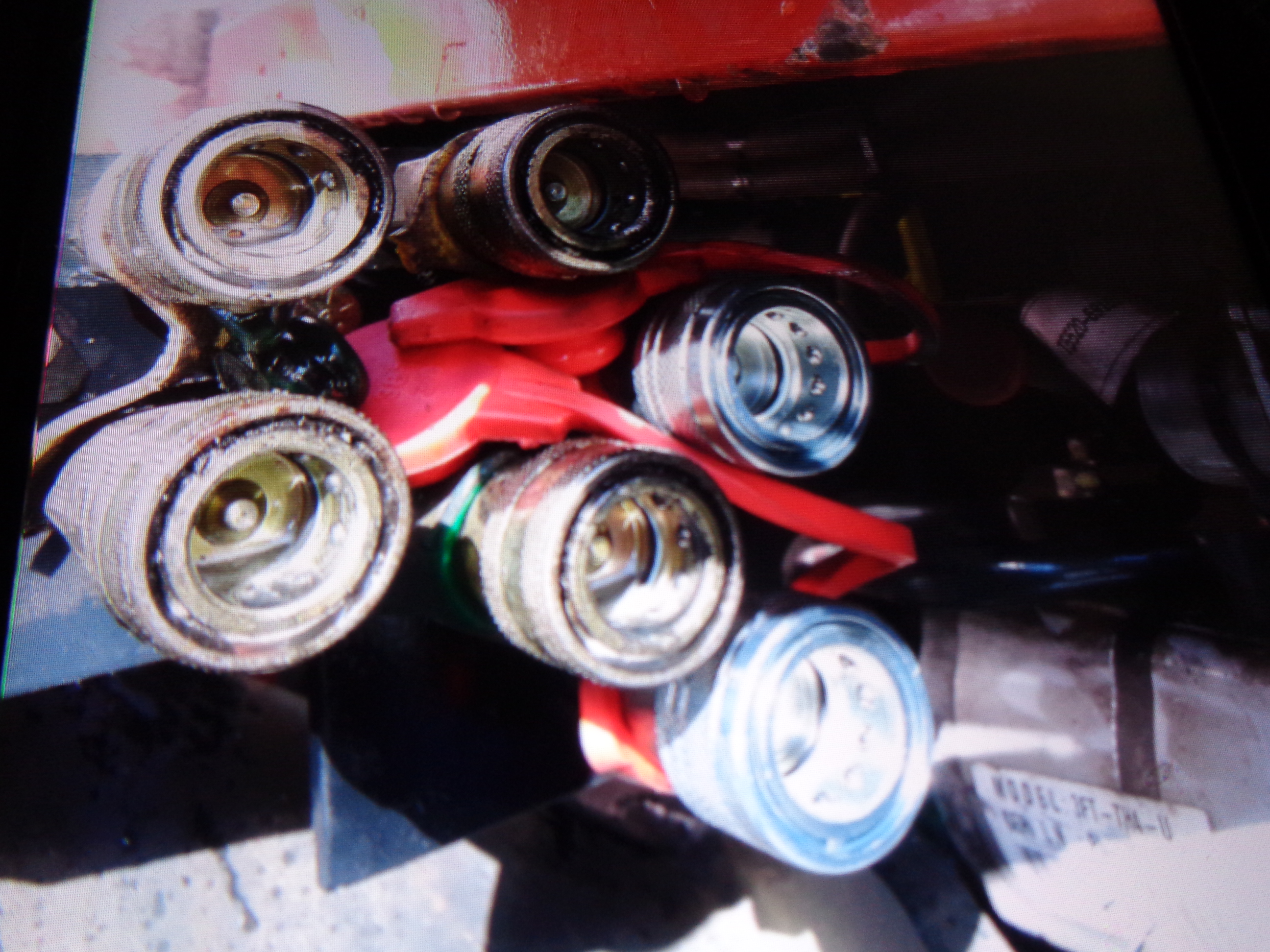

I decided to go the cheap route using the rear remotes. I bought my hoses from Discount Hydraulics and the fittings from Surplus Center. Total out of pocket was around $250.00. I don't see me using this very often and decided to spend the extra money towards attachments. I bought a stump grappel bucket and a 72" Skid Pro rock bucket. I made a bracket to attach onto the loader hydraulic disconnect bracket. My 3rd function disconnects will go there. Eventually I will make a front bracket for the grapple disconnects on the loader crossbar. I'm waiting for two reducers to come in this week for the grapple bucket hoses.

Loader disconnect bracket.
