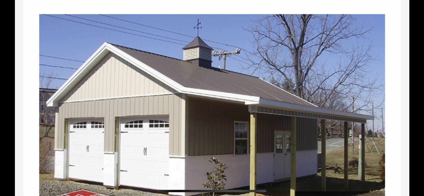

I’m switching back to more of a smaller cabin approach. Got feelers out on a 24x(32-36)x10 cabin with a couple pole barn builders, that have done residential.
Similar to this without garage doors, on a slab.
Might just do metal ceiling with blown in insulation, and tongue and groove wood interior walls.
Then if we decide to move there, will build a larger house later and could use this as a shop. View attachment 810522
