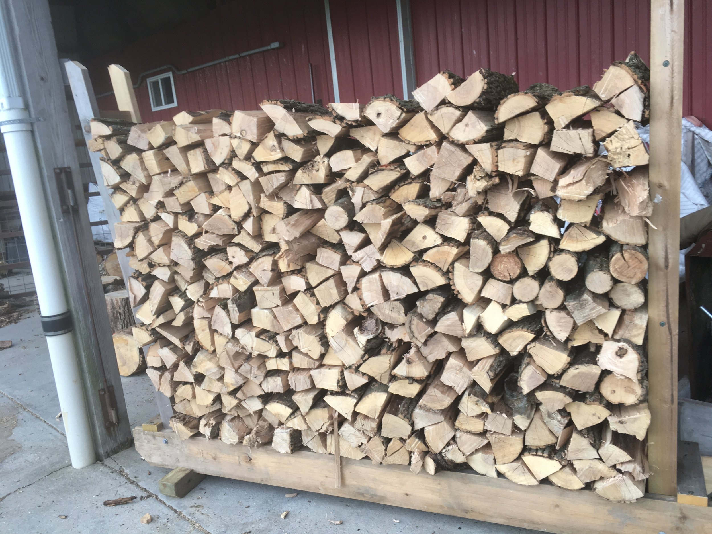

Here is a couple pictures of how I process about 6 cords I use to heat my shop building.
in the field I cut logs to multiples of 16” long and with a grapple bring the logs to my processing area where they are cut into 16” rounds and pushed into a pile with my FEL. At this point, they are split and stacked on folding racks each rack holding one face cord. From that point each full rack is moved to a covered storage area to cure.
