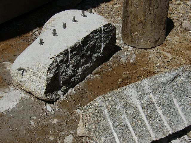

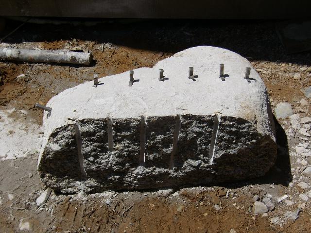

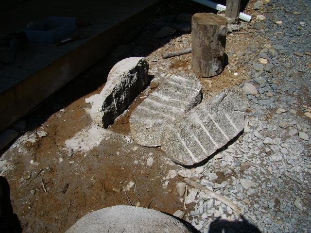

I have just started into making small rocks from larger ones. The only tools I have are a hammer drill, feathers and wedges and an angle grinder with a stone cutting blade.
It's kinda neat when a rock splits approximately where you wish.:D
The center piece will be used as one of a series of steps down to a lake front.:D :D If the owner approves!:confused: :confused: :confused:

That is pretty neat :D
Looks like you can get a pretty accurate cut.
I think I would just be reaching for the explosives :D :D

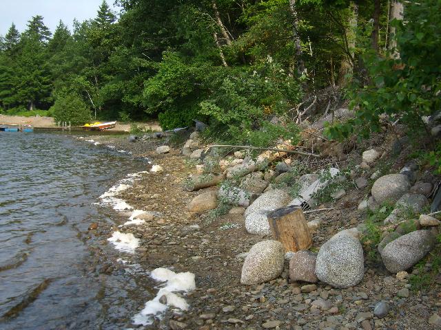

The rocks you did see need a few more brothers and sisters and then they will be used to make a set of steps leading from the lakeside up to the level of the lakeside house.:D Maybe next week there will be more pictures.
I'm doing some landscaping work on a lakeside cottage/house. There is also a boathouse and woodshed to build!:D

Egon, I've split lots of foundation granite. I only drill about 1/2" deeper than the length of the wedge. I think you're spending more time drilling than you need to. My pneumatic drill bits are only 3" long. MikeD74T

Egon, I'm not knocking your work at all, you're just doing more than you need to. The advantage to shallower holes, besides being quicker to drill, is that the 1/2 holes at each edge can be removed with a set leaving a smoother edge. MikeD74T

Thanks Mike. Next time splitting I will try shorter holes.:D :D :D It will also make it harder to lose the feathers down the hole as I have been doing!
There are many old split rocks around here. They all show short holes.:D :D
I was using the long holes as some of the rocks are not even and I was thinking a short hole would spall off thinner pieces rather than getting a clean break.:confused: :confused:

Long holes or short holes. It all depends on weather you're splitting quarry granite or conglomerate granite. Quarry Granite can be split with short holes because the grain is uniform, while conglomerate granites' grain is not uniform and should have deeper/longer holes, and you still may not get a uniform/smooth edge.
