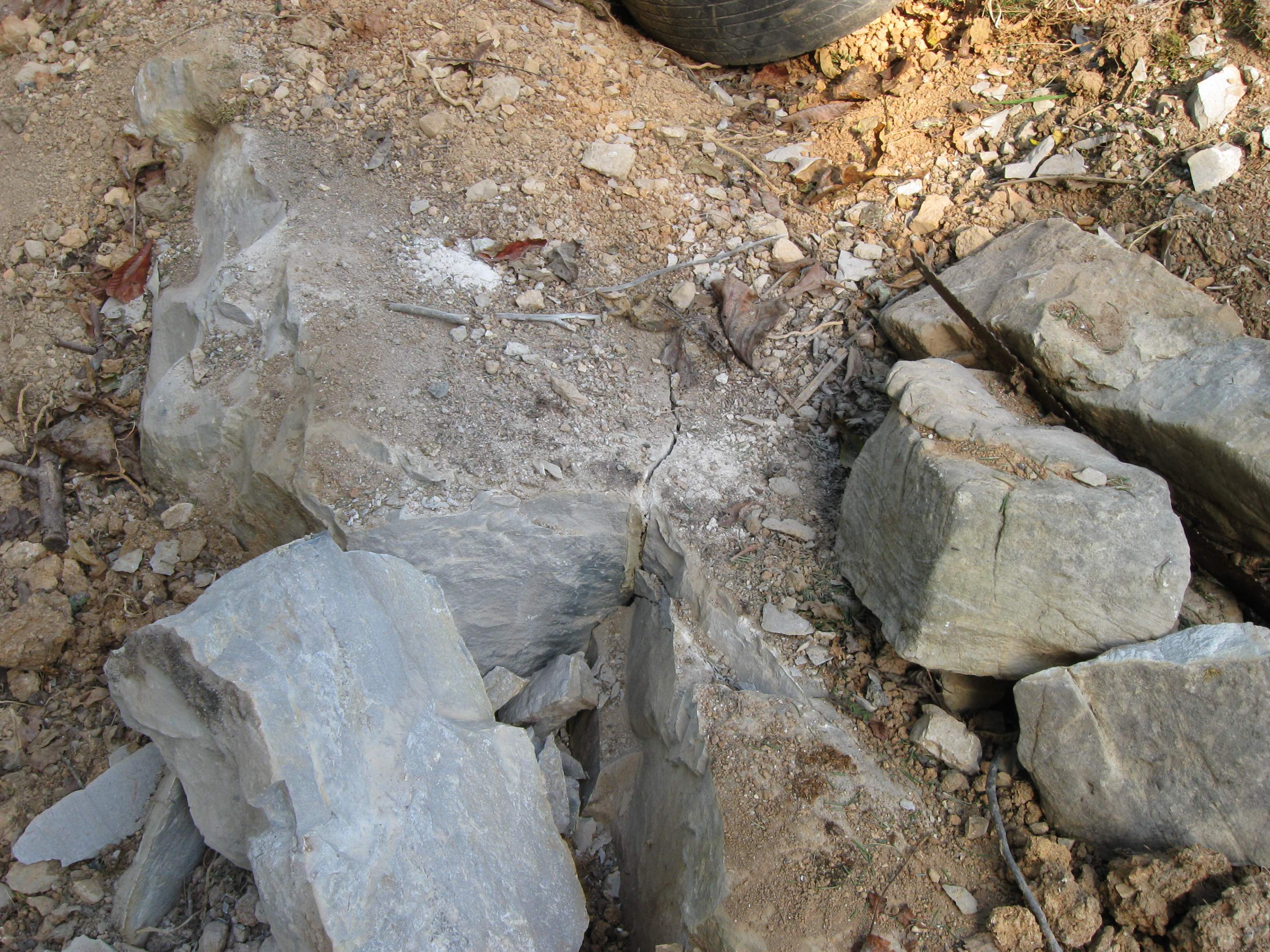

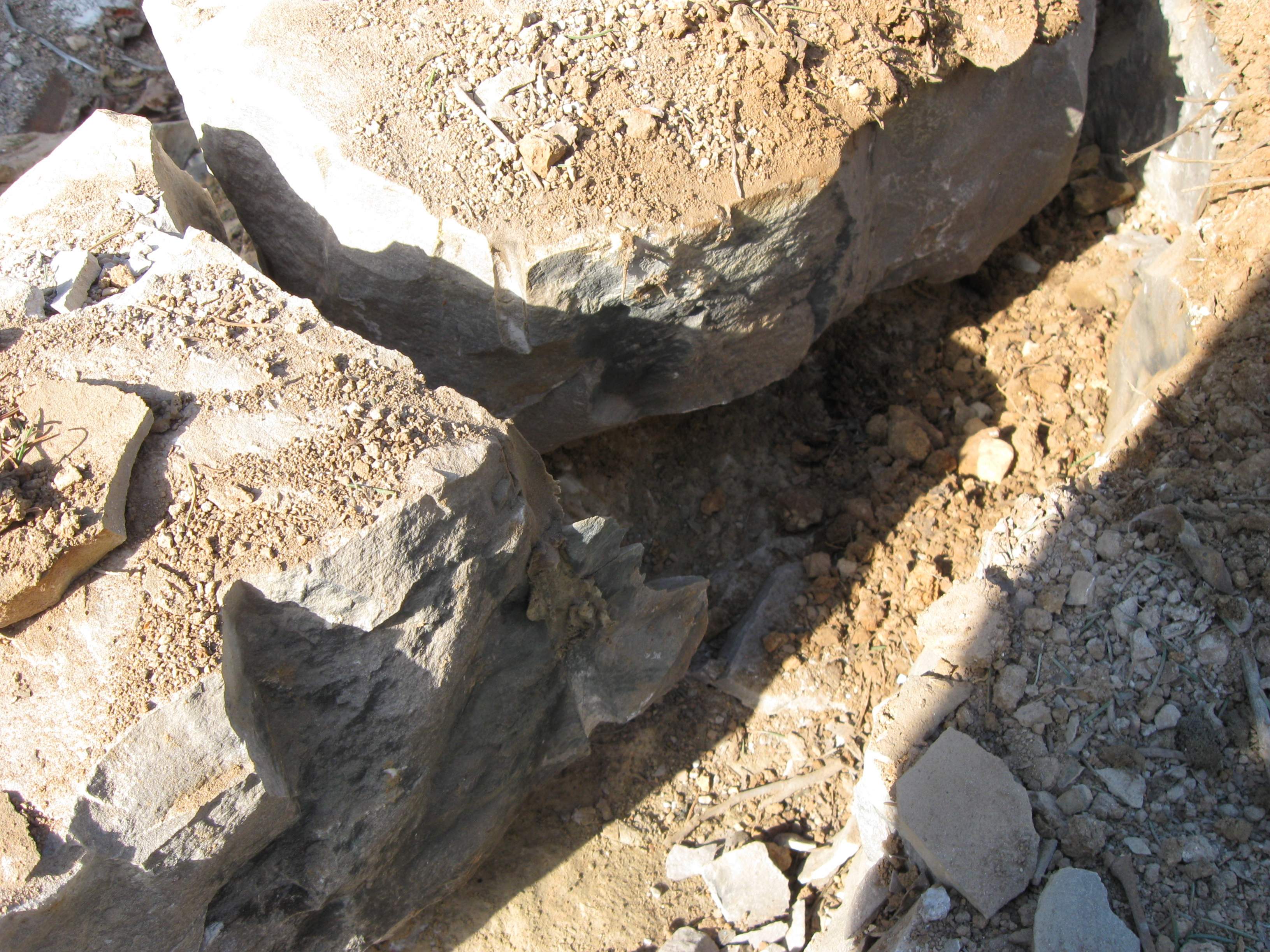

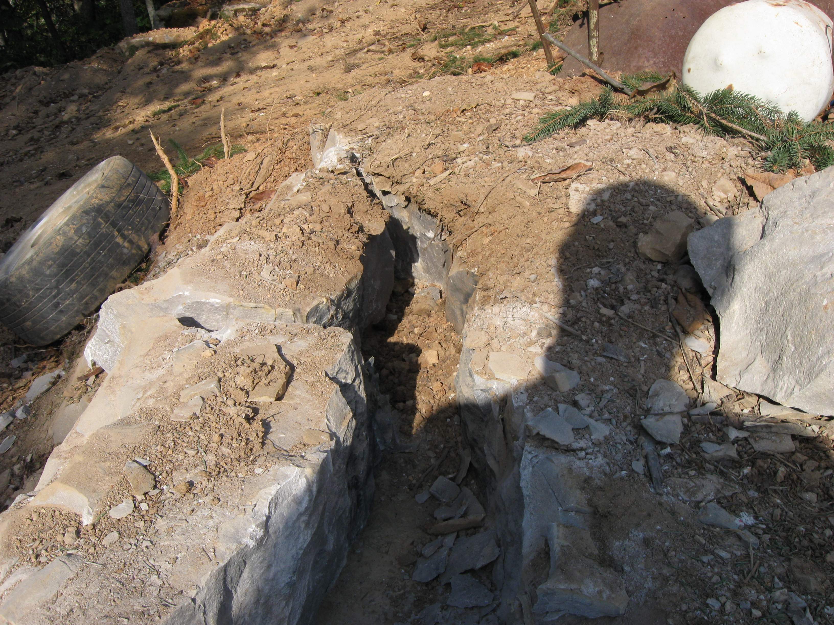

I've added some pics below that show (1) largest rock, (2) medium rock, and (3) rocks I can manage with rented 14 ton excavator. My JD 5325 is shown in each pic for scale. As I said before I have 6-8 rocks I need to make smaller so that I can move them with excavator....Gary
Well last week I had a contractor out to show me what they could do in a 1/2 day at $100/hr. His equipment is a rock drill and a hydraulic wedge. The larger boulder in my first pic had 16 holes(30in deep) put in it and the wedge generated long cracks through the boulder. That one took 3 hrs to do. Then I had him do 2 rocks of ~20K lbs. Each rock received 3 holes but one was harder than the others and took longer to drill the holes. One rock split real good but the other is questionable....won't know until I take an excavator to it. At the moment I am pleased with the results. In the near term my plan is to rent a 20ton excavator and dig these and other rocks/boulders out for burial under a driveway. I have a agreement with this contractor to respond within 48hrs if I need additional rocks split while in the possession of the excavator. Watching the rock drill at work left me with the feeling that better to have someone else do it.....it would probably rattle my fillings loose.........Gary
