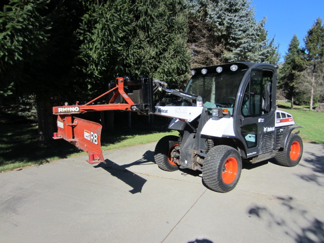

That is why I bought the ssqa to 3pt adapter, so I can put the 3pt attachments on the front.

A true necessity for a toolcat.
