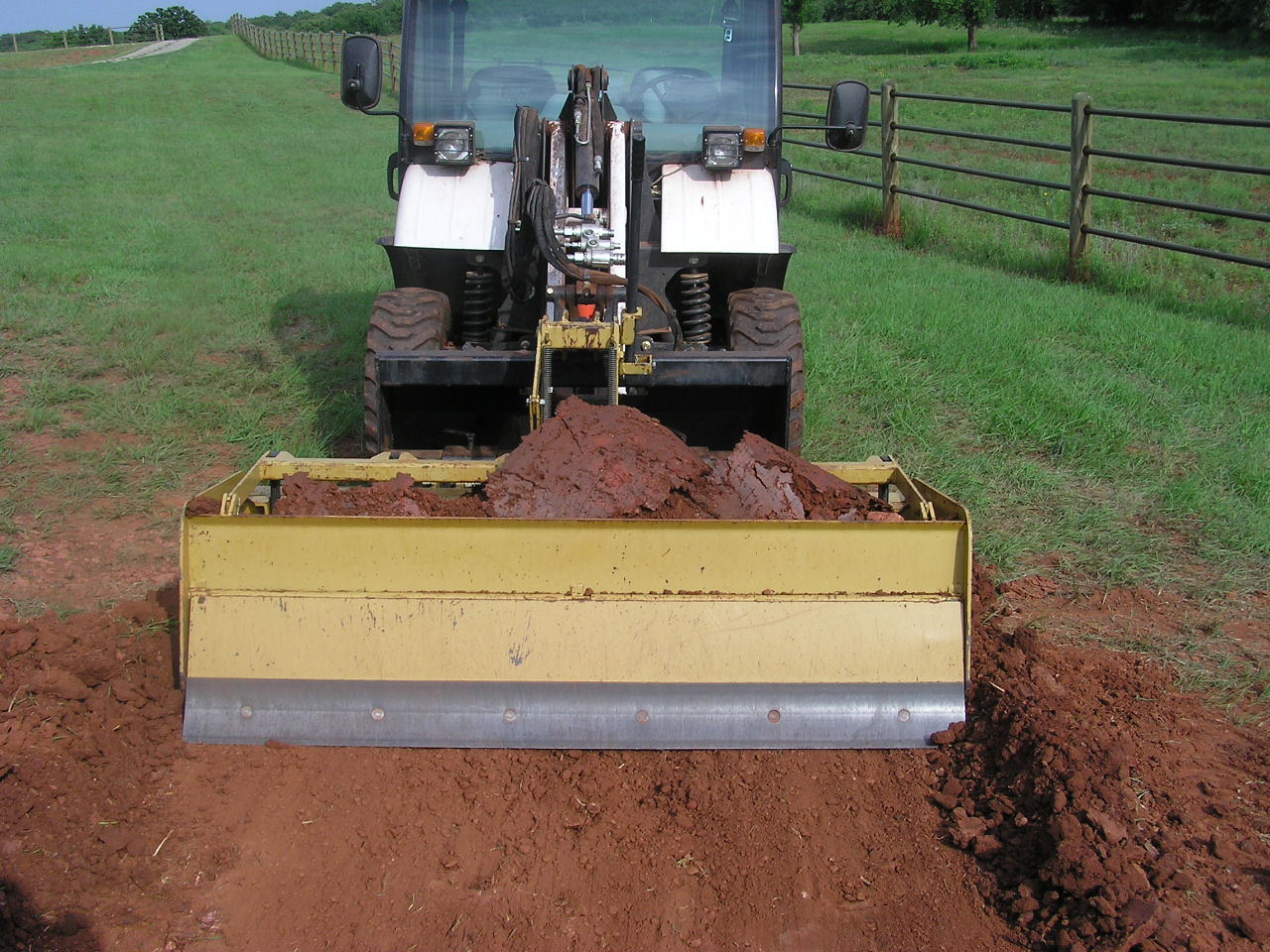

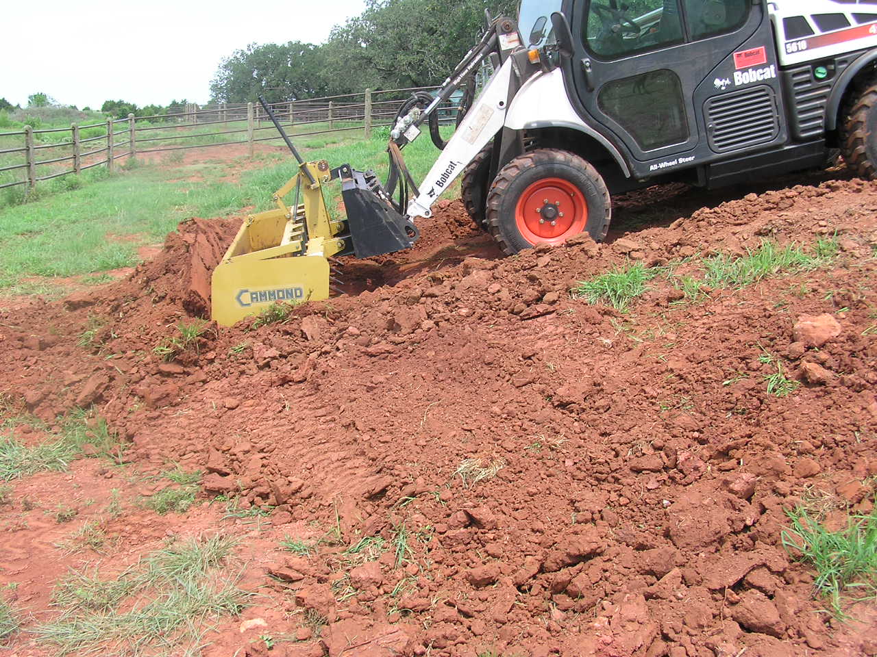

Only thing I gained is it's built strong enough that I can push dirt.
/ SSQA Front Blade #29
....and...if you only float the plow, the loader frame weight stays on the front tires so you can steer better.[/QUOTE

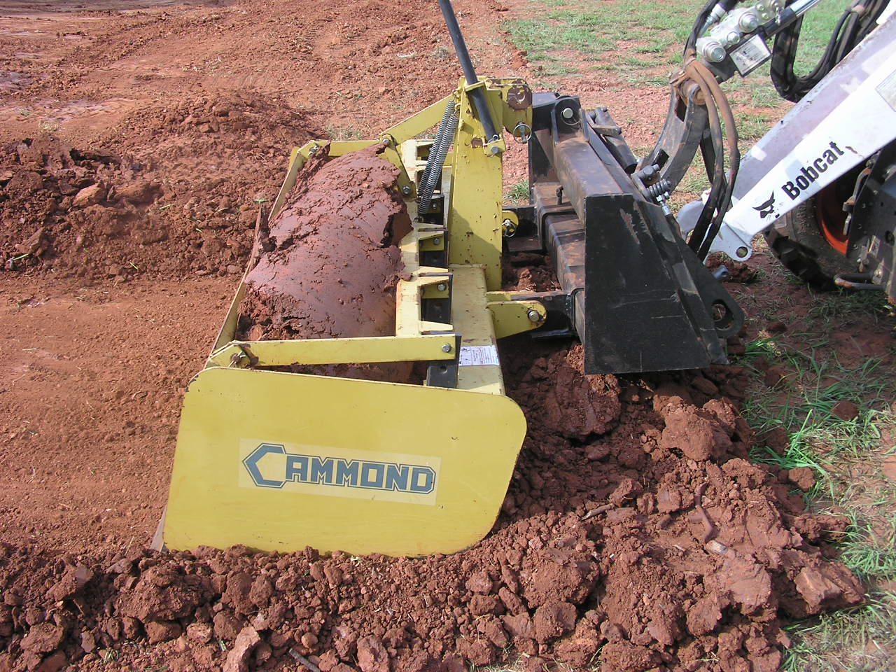

That is why I bought the ssqa to 3pt adapter, so I can put the 3pt attachments on the front.

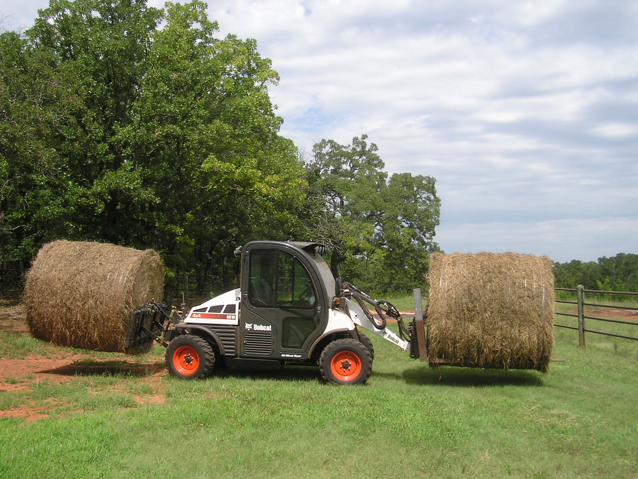

A true necessity for a toolcat.
