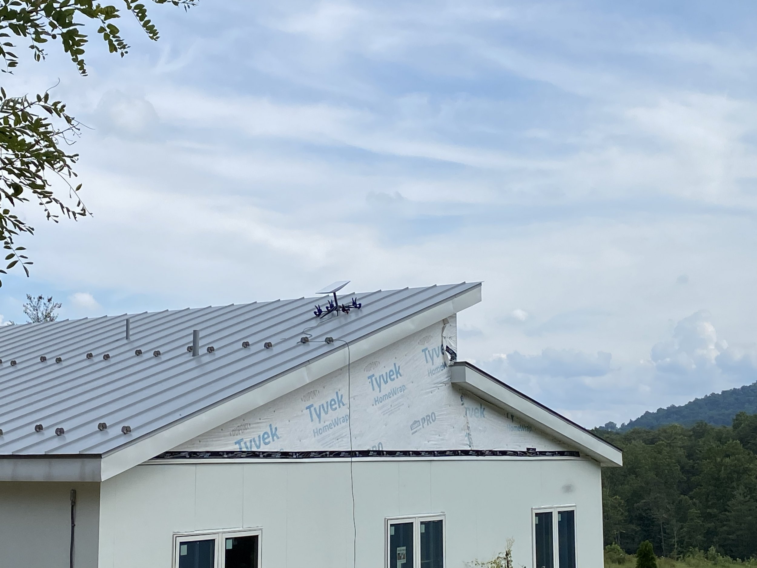

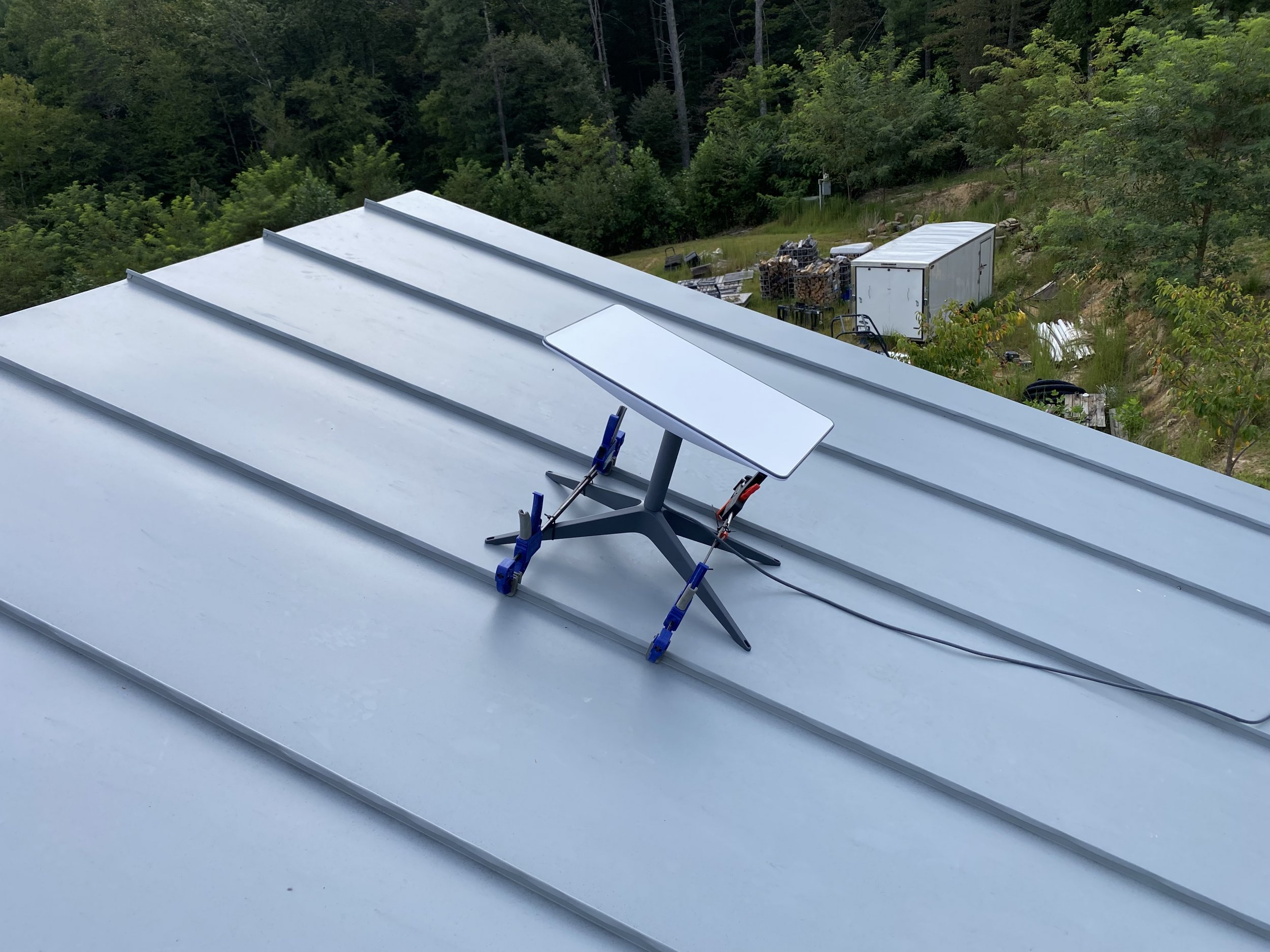

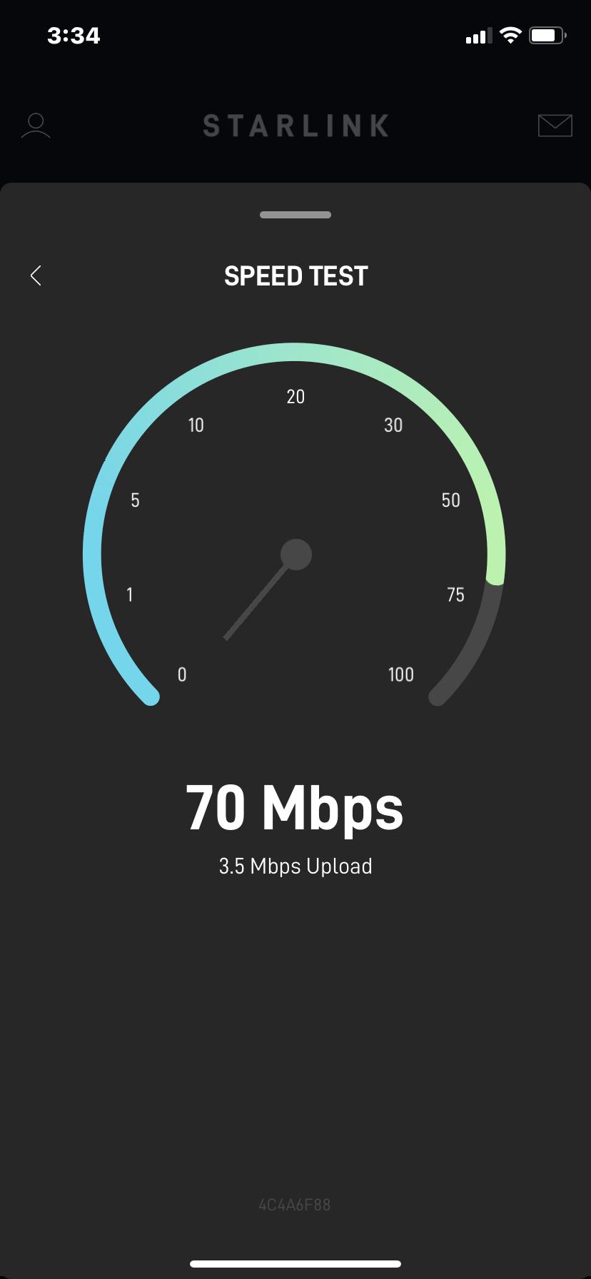

Well, I fabricated a highly sophisticated temporary mounting system and after a few technical difficulties, we got it up and running. My speed tests range from 13-70 Mbps. I am letting it collect data for a few hours before I take it down.
That’s awesome. At that angle I don’t think the trees will be a problem.

Before I left tonight, I took some stat readings.
It did give me reduced speeds during peak hours ranging from 10 to 33. With one spike of 63.
The modem is sitting on the floor in the spare bedroom and I was still able to use the internet on the back porch and in the master bedroom. Depending on performance once we are there , I may get a mesh router. But I have to say that I am ver pleased with this performance so far. The location appears to work so I am hitting the easy button and getting all the mounting paraphernalia ordered quickly.
/ Starlink #2,938
Your obstruction page looks pretty good. Normally there shouldn't be repeated 'no signal received' or other disruptions, so keep an eye out for that. Even though the obstructions page shows hardly any red, that is more 'shadow' than I'd expect, so it could be that there still are some sight issues.
