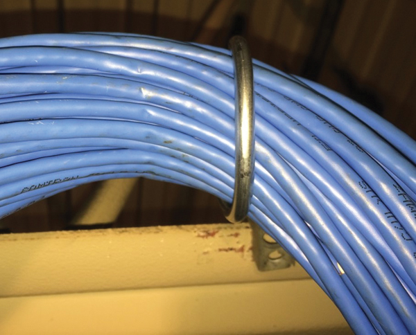

One thing that I would check for are failing or failed Ethernet cables, and make sure that the Starlink cables have not worked loose or corroded. An Ethernet cable can have its capacity permanently impaired by tightly bending it just once. (Tighter than a 1" radius, i.e. a greater than 2" diameter bend for stranded, a 2" radius, 4" diameter for solid wire. Starlink cablesand staples/hooks/edges are notorious for causing issues; using plastic ties, or plastic preformed cable mounts is better practice in my view.)
More here on issues generated with poor supports, like hooks or staples;
This person says that for high performance cables it can go up to 10X the radius.
Bottom line, don't kink or bend the cables tightly, and be gentle when pulling the cables.
