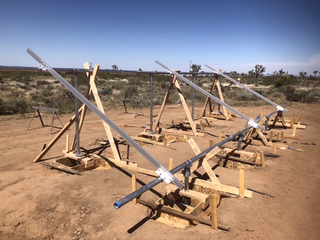

I poured footings today for my 5250 watt ground mount solar project. Being a retired licensed general contractor, my intent was to do this project completely myself. I found out that San Bernardino county will not allow an owner/builder do solar even though they can build a whole house legally. I think that solar is dangerous because once the panels are exposed to the sun, they are generating electricity and that could be dangerous to a novice builder. My license is inactive since retirement so they would not allow me to use that either. I found an electrical contractor to sign off on the plans for a small fee and I will still be doing the project myself.
The original design called for drilled piers, 24 diameter by 4 feet deep. Eight of them. That is a lot of footing but I am in a 120 MPH wind zone. No trees or buildings to slow it down here in the desert.
Because of the permit issues, it took me a month to get a permit. Then Covid hit and the only driller within 50 miles that could do 24 holes shut down for an unknown period. I had to keep going so I had a friend with a backhoe dig the footings. While he is a skilled operator, there is a limit as to how small a 4 deep hole you can dig. Now I had to form all the footings. I could have used sonotube but that was $500 and the closest supplier was 50 miles away. There are some drawbacks to living in isolation. :laughing:
Concrete for the drilled piers would have been about 4 CY. My footings took about 4 1/2 CY.
Tomorrow it is strip forms and backfill and grade around the footings to flush them out. Then start panel installation.

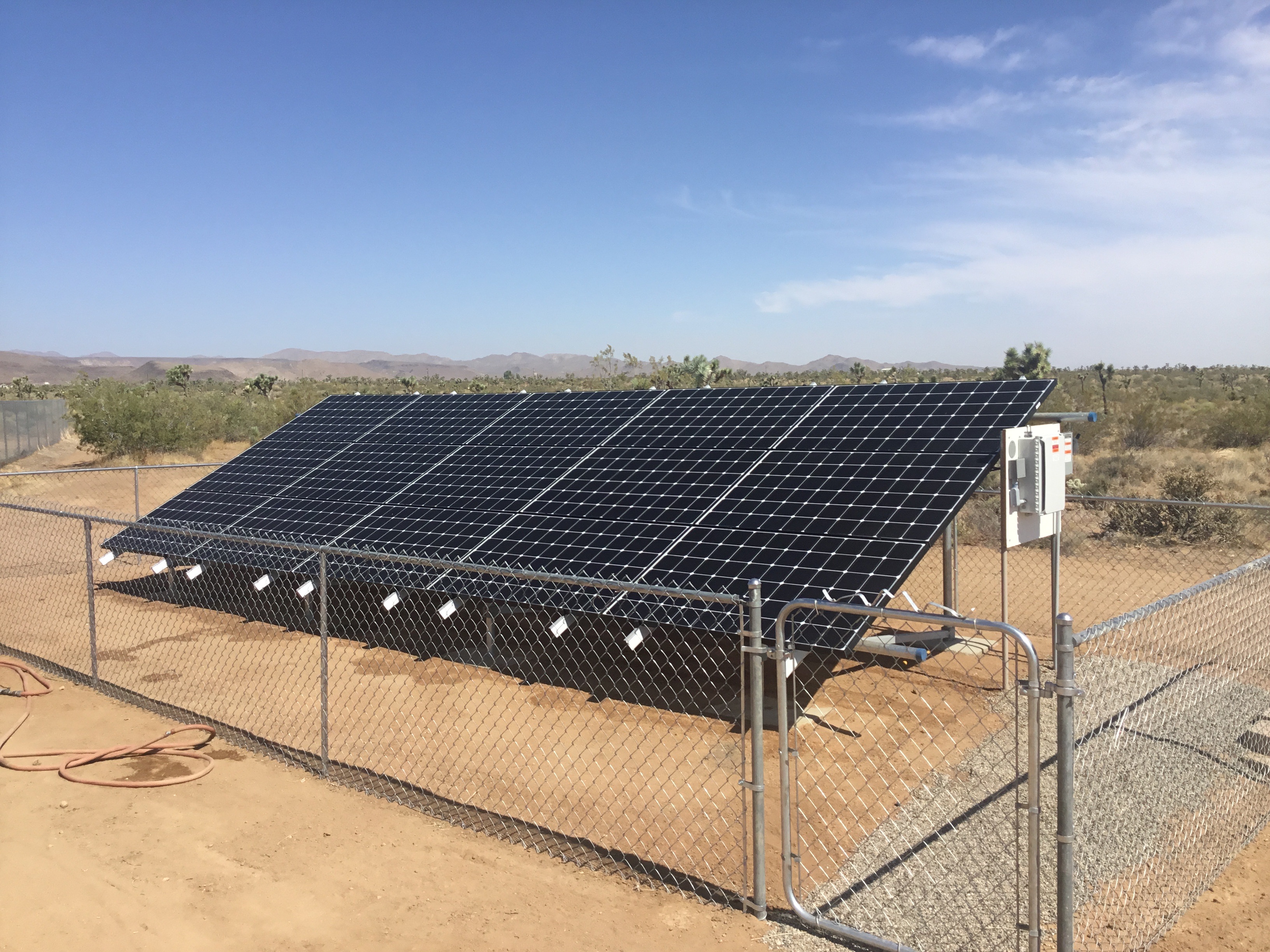

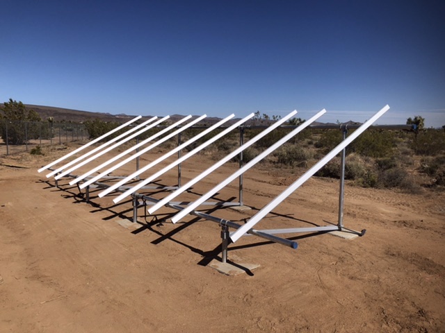

Making progress! Slow going working alone. Actually got the cross braces installed and all the rails up. AC wiring strung and one panel installed before the wind picked up to 25 MPH.

Finally got my PTO in Monday. Right now with swamp coolers running I am producing more energy than consuming. BUT as temperatures and humidity goes up in the next couple of months and I have to switch to air conditioning I will fall behind. Based on my current production I should produce enough excess energy during the 9 cooler months to offset much of the summer consumption.

Being a general contractor, I installed the whole system myself. I got several quotes before I started and they were in the $27K area. My 4.7 kW AC system (5.2 DC) is producing right at 30 kWh per day right now. My final cost was right at half that amount (considering no cost for myself). Payback should be about 4 years.
