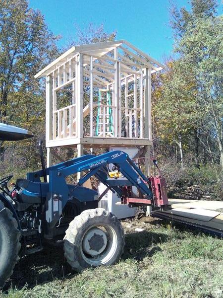

This mornings progress. I brought most of the materials needed to finish closing it up down this morning. I framed up the last wall and built the roof. This pic was taken while I was down cutting the first two sheets of plywood for the roof. They are up and the rest of the pieces are cut but I am going to need a helper to finish the roof so I am home waiting for my father to get here and then I will take the shingles and a ladder down to seal up the roof permanent.

You'll have to come up w/name after that much work.

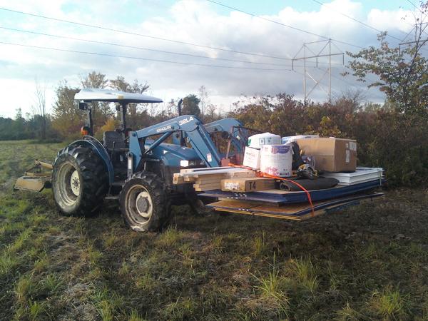

Front tire little soft?
I have gave up trying to name things. It is just going to be called "the tower stand on my field" and everyone will know which one it is:)
The front tires are set to a pressure I like for general farm work. There were 12 sheets of OSB, 4.5 sheets of plywood, 2 windows, a 50 pound box of 16 sinkers and a 25 pound box of roofing nails as well as a half box of soffit, all my tools and the insulation. So there was more weight then I would normally have up there. If I plan to do a lot of loader work I add air to the fronts but for general work I don't see any advantage of running high pressure and this year has been all general work as its been way too muddy to do any amount of loader work. In fact I took the bucket off after last winter and will finally put it on for this winter when I am done with this stand.

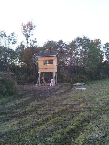

So I am done for the day. I have to find the rest of the shingles as I am about 10 shingles short with what I brought out:rolleyes:. My dad finished the roof after I had done 90% of the plywood from working through the roof rafters. He also did the drip edge, felted the roof and shingled everything we could. One wall is completely covered with OSB and the other wall is half covered. I am happy with the progress today though.

Wow - That is Awesome work - How does a guy with a hurt back build that roof? - I'm guessing you are standing on a ladder with a nail gun. Still, it'd seem difficult to hold boards in place and secure them - Especially when you have a hurt back !
