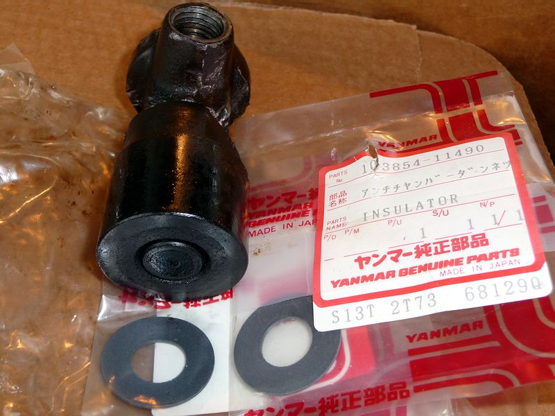

Hmmmmmm... the plot thickens:
http://www.hoyetractor.com/DESIGNS/injector-parts.jpg
I dont seem to have any of these items under my injectors unless the are attached to the head in such a way that they dont come out.
Here is what you are looking for. I went out and dug through my misc parts box and took a picture for you. Yanmar calls the fiber washer 'Insulator'.

So has anyone order the item 34 ^^ and had an issue placing them? They almost seem to small so its hard to get them to line up over the hole.
Are you saying you ordered the insulators, but not the gauge adaptor. With too low compression, you are fighting a lost cause without some engine work.
