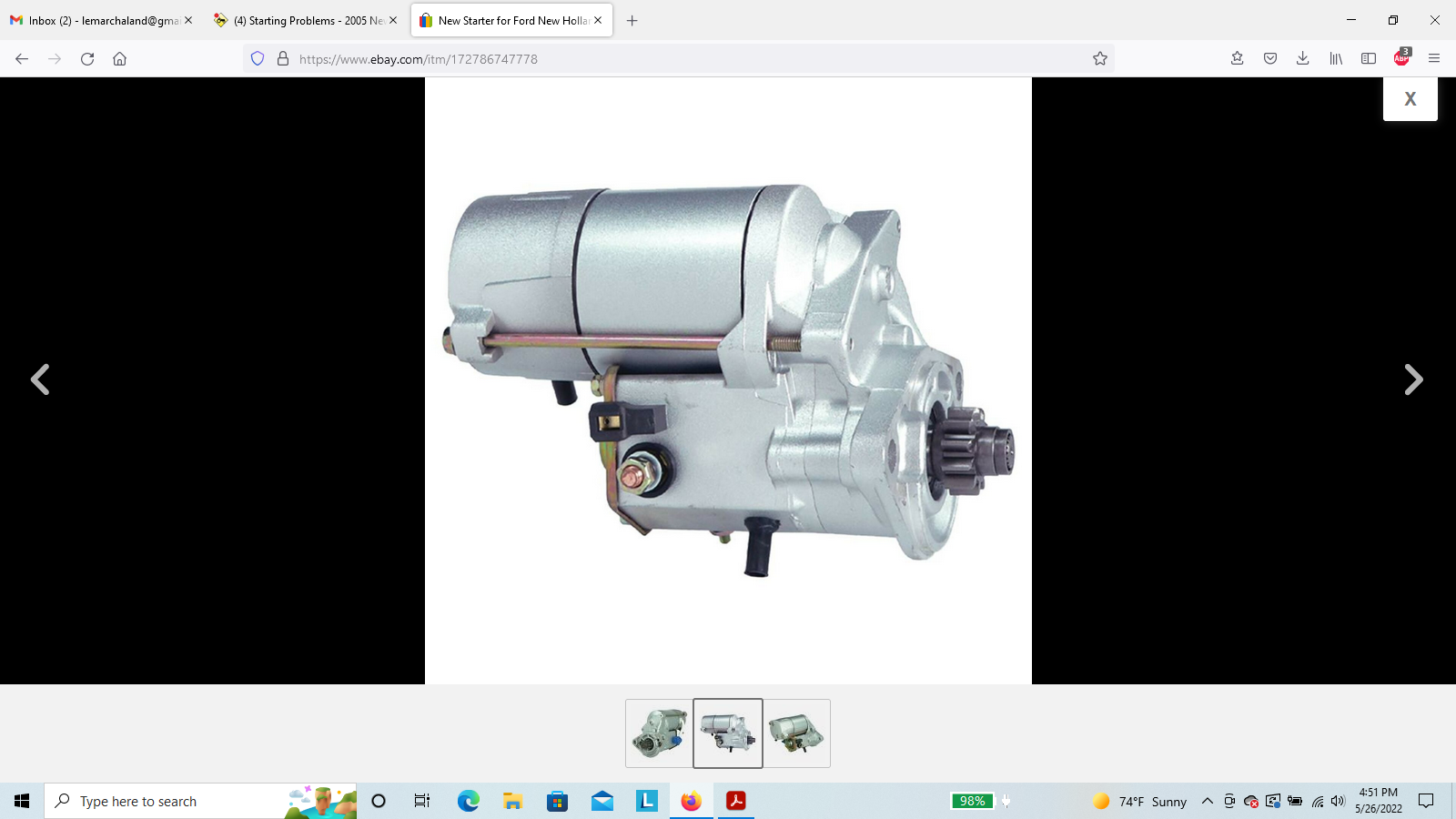

Does this look like your starter;
If so I'll assume the battery lead fastens to the large stud that is visible, with a small wire and connector to the black connector.
The black connector should be from your switch or a starting relay to energize the solenoid.
The solinoid is the back portion that the wires attach to.
Do you have a test light, if so with the test light going to the smaller terminal does it glow brightly with the key turned to the start position.
If it doesn't glow good and bright your not getting power to the solenoid. If it does your starter should crank the engine.
If it doesn't crank but the light is on brightly,
the repeat the test with the test light on the large terminal it should be on bright immediately, try to start and see if it dims.
It should dim and the engine should crank.
No light bad battery cable, light doesn't dim likely a bad solenoid, if it dims with no crank a bad starter.
