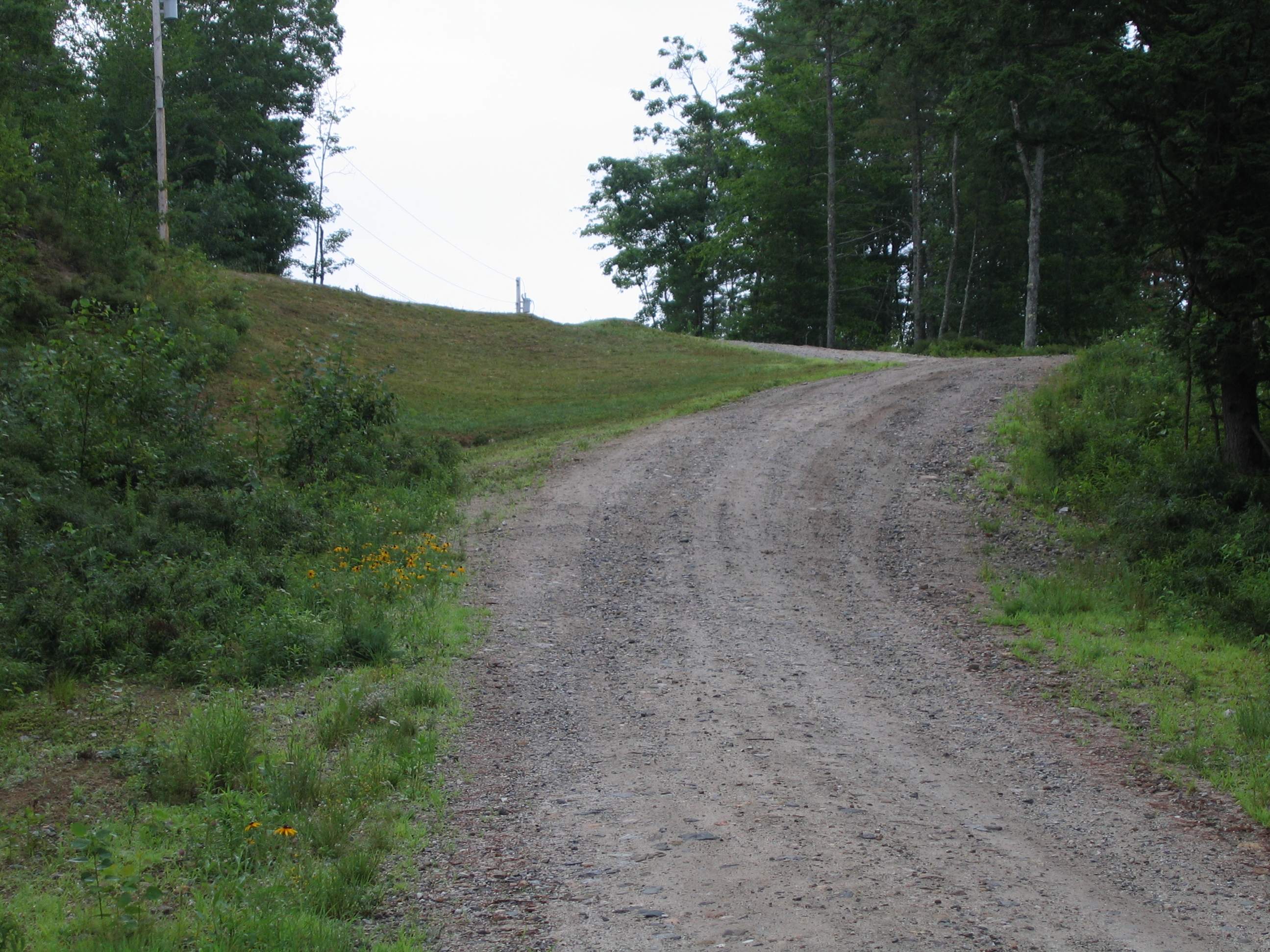

Here's the driveway..............

Good base of Crusher Run to start. wait a month or so, get it well packed and then add the Ashphalt Gridings on top.
if you already have a good base, just go with the Grindings

Here's ours..............Topsoil was stripped, shale base added, 57 limestone topping, ditch on uphill side with rip rap....................
   / Steep gravel driveway advice #10
Jim that ditch is a thing of beauty great views also. Looks like you were dealing with runoff from above more than anything. As far as the drive, that isn't near as steep as what I was dealing with. There reaches a point that whatever gravel you use if it is steep enough concrete is the only thing that will stand the test of time.

Mark, Thanks. Original ditch was deteriorating at a fairly quick pace and therefore had to reditch and add riprap to slow water and keep erosion in check. There's still alot more drive that you can't see in the pics which is fairly steep in spots. A bit dicey in the Winter to say the least! :)
