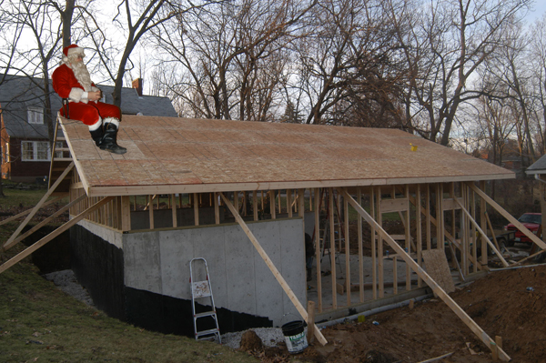

I would get some diagonal bracing up before roofing. I would use osb on your two exposed corners. I don't trust the bracing with all the weight and potential wind.

snaped this picture early this morning as the sun was comming up. I think he was waiting for me to build a chimeny so he could get in to the garage.

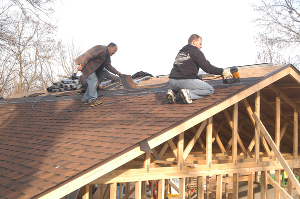

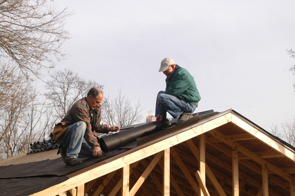

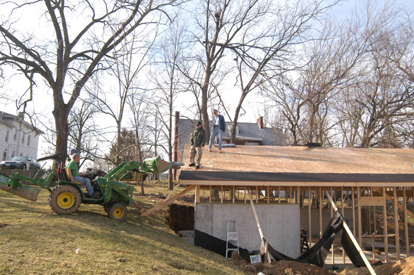

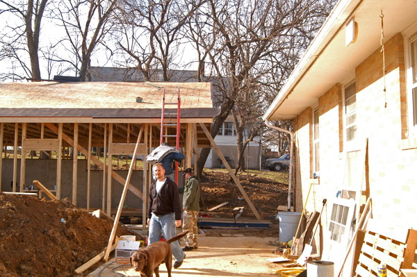

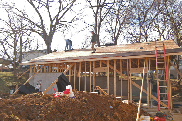

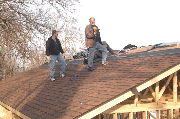

well here is what has been done to date:
1st rain is comming in on Fri night.

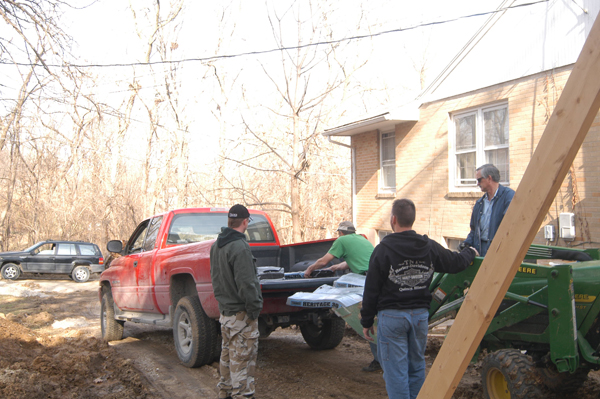

I got 3 squars up on the roof, one bundle on the back of my brother. Then I came up with the ieda of saving some time and got my tractor out. That was better.
We got the 3/4 of the east side shingled and the other side papered. Going to hit it early and hope to have it finshed by 3:00 or so. We are not fast, my brother in law as 14 square he could put down in 6 hours. But the roof needed alot of prep today, some blocking on the rakes then the paper and drip edge etc. The lumber company brought a left later that brought the 42 bundles up all we had to do was walk it down and stack them at the top.
I got lucky, I started today thinking today I would do this alone. The neighbor saw me and came over to help, then son in law came over, then my brother. I took advanatge of the help and put them to work. In the past I helped my brother roof his house so he took pitty, the neighbor I help build a shed remove trees and bulid a play house and shed. What can I say my son in law thought he better help his father in law or maybe my daughter told him to help. But all in all it heart warming to know people are there to return a favor.
Tommorow better pictures of the what we have finished, we worked until and past dark so no pictures of the nice half finished roof.
Roger

Not to rain on your parade, but you are taking an awful chance putting the roof on, with all its attendant weight, without any plywood or OSB on your sidewalls. You have no lateral stability built into your building. I'll bet your building shakes a bit when you walk across the roof. If you have a wind storm come up, you may have a big problem.

Thanks for the note. Your right, shortly after the pic were taken but after the all the roofing was put up on top, one of us started talking about the movement. We did put bracing on the studs running down the garage length. it to the shake out right then and there. If my friends show up some will roof while others will start on the boxing. Thanks for the pointer.

I brought up the point of corner bracing a week ago before he started roofing. I have seen where entire framed structures have fallen due skipping this little but very important step. Trusses fall like dominos, often killing the carpenter.
Be safe, it will take all of 10 min to sheet the corners.

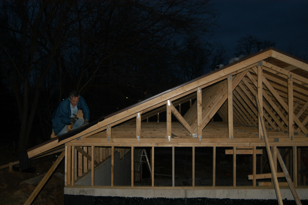

Well we got the roofing on up to the peak, I had to make a choice to run the roofiing just short of the peak or take the time to cut the last strips 3 inch wide on both sides then run the shingles up. I knew I was going to run out of time if I filled in all the gaps, so I ran up to the last row, folded over the tar paper and tacked it down and placed bundles over the crown. We are gong to have 3 days of rain this weekend. So next week I will put on the ridge cap.
Tomorrow I will run boxing if I can work under the over hang on the sides and when I get help the front and back.
Now any thoughts on when to take down the braces out into the yard as I do the boxing. The side braces are on the inside so I will leave them on until the boxing which is 7/16th of a inch.
thanks
Roger
