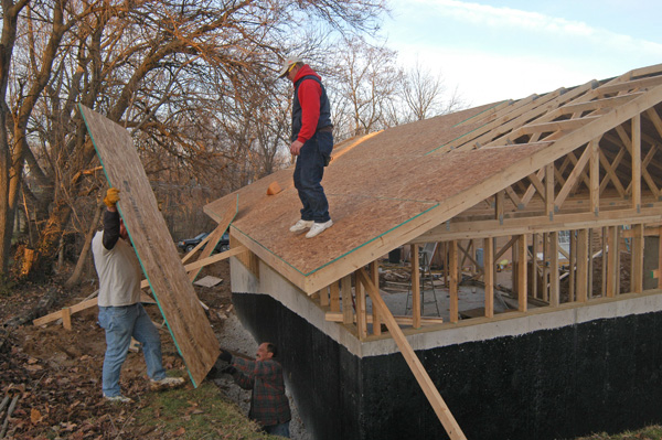

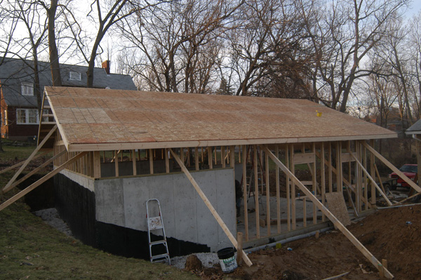

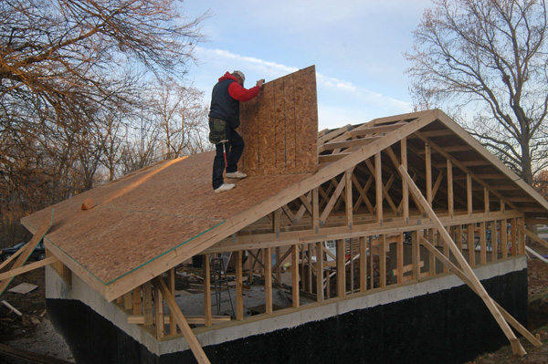

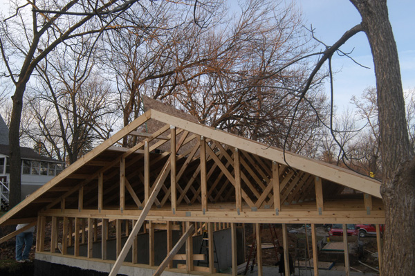

Well two days of progress and reality checks:
Tuesday we placed and set the trusses then Friday we built the rakes and put up the fascia broads.
After that I said I could handle the rest and the brother in-law job was done. Well not really. He help me set the rakes but he told me to go around all of them this morning and put in more nails, he was there to get me going, he had his own garage he is building at the same time, so he is there to help out on the harder things.
This morning I could not get the hang of sitting on the outer gable and leaning over to nail. It is two foot reach out in space. He came over and stood on the rake and bent over and did the nailing. Not me I would fall off from the thought.
Once that was done he asked lets see you get one sheet up and set on your own. 10 feet up, and ½ osb. Well not. I could not handle it tried a later tried slipping them up from the ground. Well he took pity on me. I cut and packed them he drop and nailed the corner. So tomorrow I will chalk lines and start nailing.
We put up 42 sheets in 3 ½ hours. It was a made rush cut carry and lift, place and nail.
So once again I found out I am not a framer. Or not a framer up on trusses. I built the walls not trouble I could walk around on the wall setting up the trusses but ask me to bend over and out on a 2x4 forget.
The picture of the roof that looks like it is at ground level is from the back of the garage that is dug into the hill.
Well I will soon be doing the boxing and back filling. I hope to have it roofed by next Saturday, have to work Tuesday- Friday.

   / Step by step photos of new garage #89
Roger,
Nice job. The framing looks really nice and the decking is great. Did you put clips in between the sheets to keep them seperated? Sometimes it's hard to see in the pictures if you did or not.
I forget if you mentioned what your using for siding? I'm also wondering about the soffit under your eves at the end?
The reason I'm asking is the space between you purlines that create your the overhang do not have any blocking. It's not a structural thing, but it sure helps with putting up siding. If you are going to cover those purlins with something, than that space wont matter as the sideing will end flush with the soffit.

Well its 3:00 in the morning, slept for 2 two houea and woke up with camps in the legs and back could not sleep. Might have something to do with that darn garage. When I started this project at night my hands were so sore I had a hard time typing, After todays work they were fine, got them in shape now only if my back, calfs and left foot would toughen up I might be in good shape.
Eddie, yeap we put a clip on every 2 foot,
Glad you asked about the blocking, I am going to brick the front up to the gable then us vinyl siding there and the eves. Maybe brick the other side with the most exsposed wood and the rest will have siding So are you saying I need to block it to help run the siding so it will not sag.
