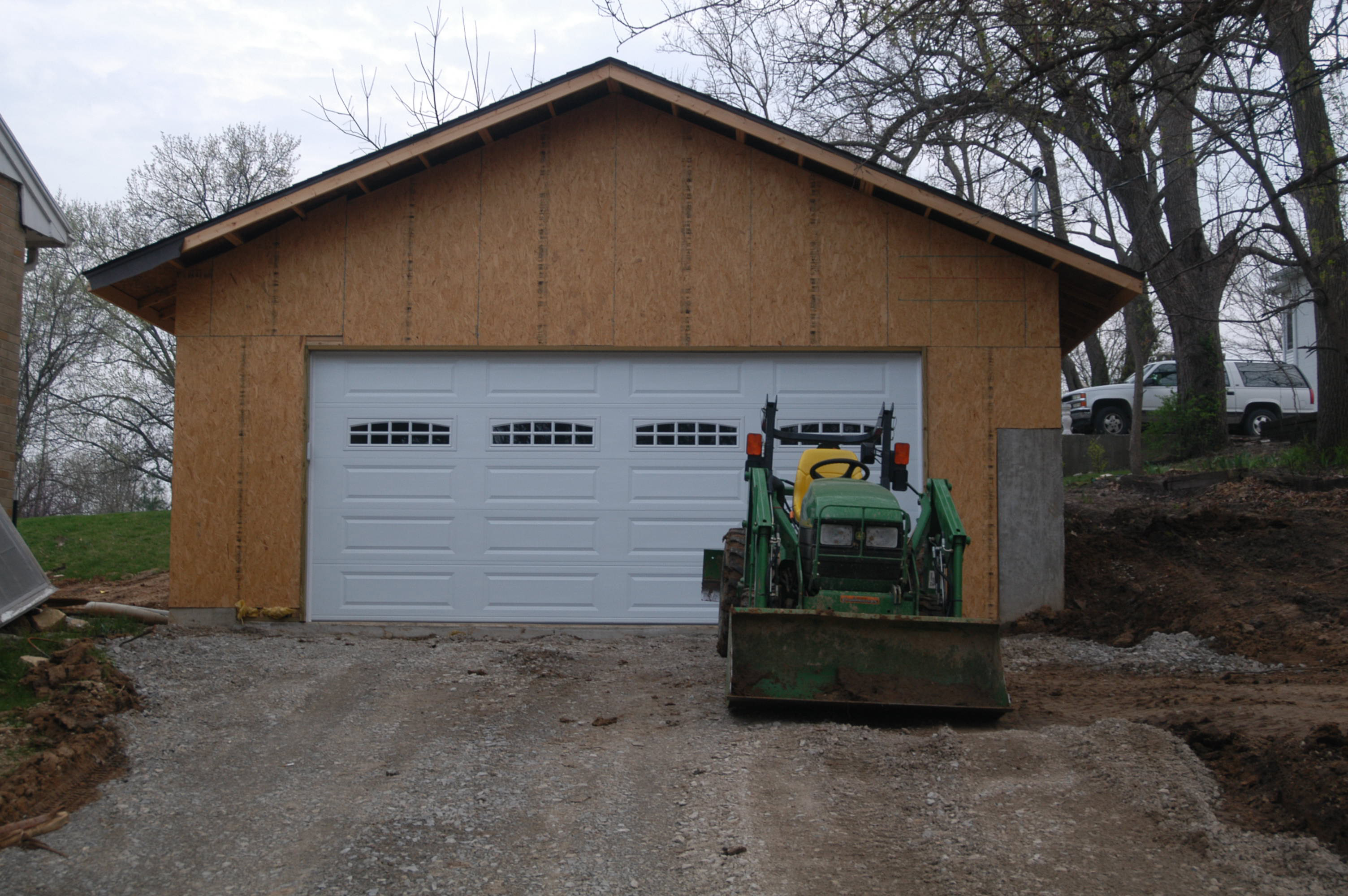

Well the other day I widen the drive by about 6 feet to the right of the tractor. I have to add another layer of gravel then form it up for the concrete.
Question how wide of a apron should I have and how long (back to the street) I was thinking of course as wide as the garage but not sure how far back to keep that widith before going back down in size of the gravel I have now.
Right now up by the garage it is as wide as the garage going back some 16 feet.

Sorry folks posted 2 of the same photos one sized and the other not sized.

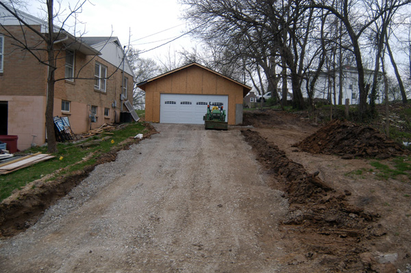

here is a full view of the drive and my messed up yard. Need to get it cleaned up before the neighbors yell
roger

Looking good!!:D
How much do you think this project has/will cost when you are done?
