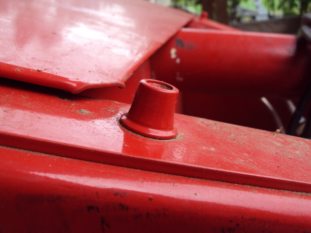

I need to remove a metal plate from the tongue of my MF 1734 round baler. It is held on by 8 carriage bolts, the heads on the inside and the threaded ends pointing out. Instead of normal hex nuts, the bolts are secured with cone shaped nuts which I have no idea how to remove. They were screwed on and tightened with some sort of tool. I'd like to get them off without using the sawzall. Any ideas?

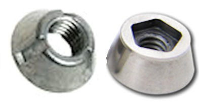

Does it look something like either of these "security" nuts ?

Like the one on the left, about 1" in length, but without the notch -- nothing at all to grab onto. Will post a picture tomorrow. Thanks

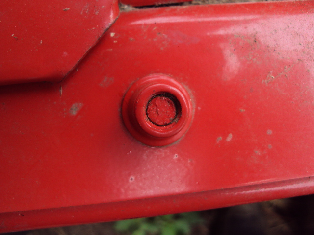

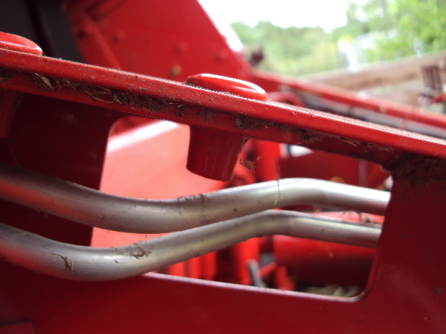

Here are some photos: side view, top view and how the nut & carriage bolt look together. As you can see, there's nothing to grab onto: there must be a special tool to do this...

That type of nut has a driver attached to it for installation. When the torque for the nut gets to the correct range the driver will break off leaving a tamper resistant nut. They can be cut off with a grinder & replaced. I would replace it using a locking nut to make sure that it doesn't back off.

It's hard to tell from the photo ... But I would say the fasteners are either Huck bolts or Magna-grip lockbolts. Either type... the only way to remove them is to destroy them. Grind or torch them off.

Hosspuller is correct. They are Huck pins and collars and the only way to remove them is with a torch or grinder. The grooves you can see if any are not threads they are grooves that each one makes a complete circle around the pin. The tool used to affix these are hydraulically operated. The tool is shaped similar to hand drill (lots heavier, depending on size, 1/4"-1" that I have used). The collar fits on the pin loosely with about 2.5" of the pin past the end of the collar and the tool is place over the collar and will grab hold of the pin and pull while squeezing the collar. The pin has a groove cut in it that should be just outside the collar. When the correct amount of pressure has been applied the end will break off.
Great fasteners if you don't plan on taking them apart because unlike a bolt the won't work loose.
The next time you are sitting at a RR crossing waiting for that darned ole train to get out of the way, look closely and you will see hundreds of these pins and collars.

Those are Huck Bolts. http://huckfastening.com/lock-bolts/c6l-c120l.php
I remember using those at an iron works building frames for bulk hoppers back when I was fresh out of high school.
The collar is swaged on to the bolt by a hydraulic tool, not threaded.
The tool uses the end threads to pull the pin into the collar and compress. When the asssembly is fully compressed the part of the pin in the tool snaps off at a designed recess in the pin. They are much quicker to use in manufacturing than bolts, and more reliable.
