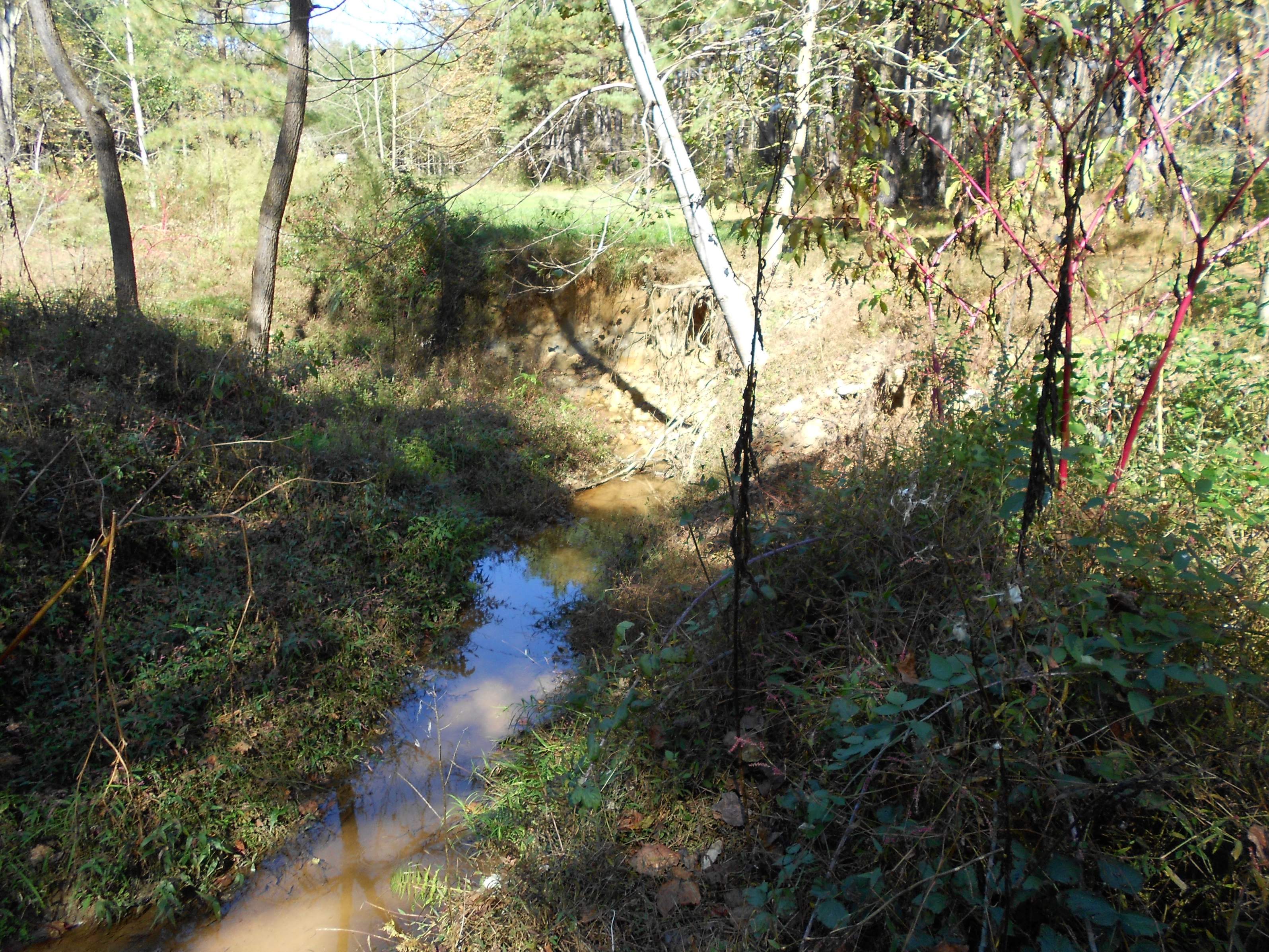

I failed to take any "before" photos, but this shot from downstream illustrates how bad the bank erosion was on one section of the project.

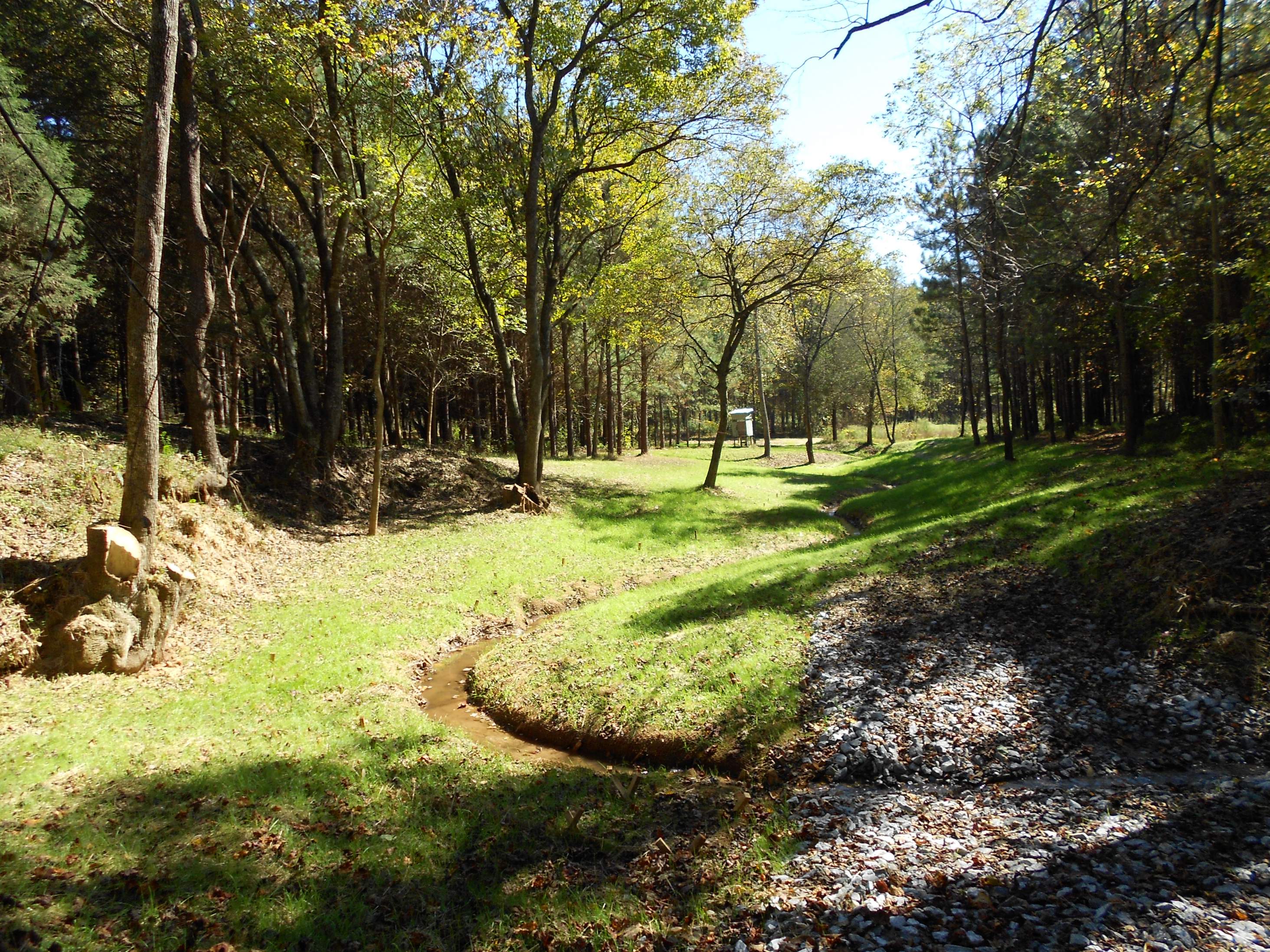

Here's a shot (looking south) of the beginning section of the project.
There was a three-foot drop off to the stream within about three feet of the stream crossing. I felt safe crossing the stream with my RTV 900, but I wasn't about to risk it with my utility tractor. I had the contractor redo the stream crossing outside the EQIP cost-share agreement. He regraded the crossing, and installed geo-textile fabric and three-inch stone.
A bank cave-in (four-foot drop-off) had cost me several loblolly pines from the plantation tract on the right-hand (west) side of the stream.

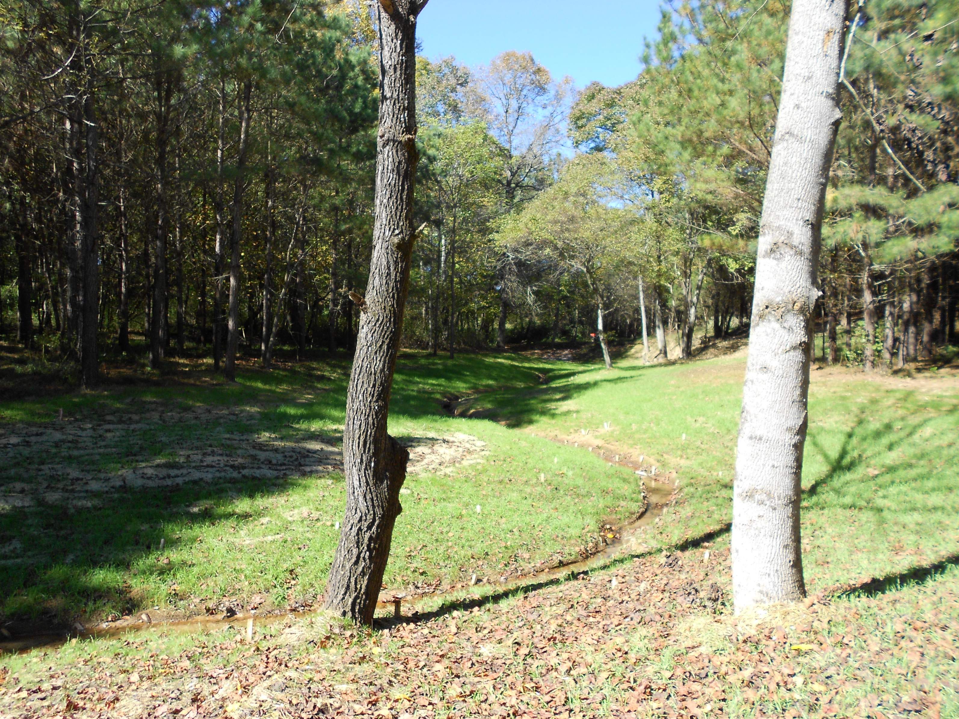

Here's a shot facing north, about 200 feet from the start of the project.
There was about a ten-foot drop-off in the vicinity of the shadow of the walnut tree's top. It would have been just a matter of time before I started losing pines from the plantation tract on the east side of the stream.

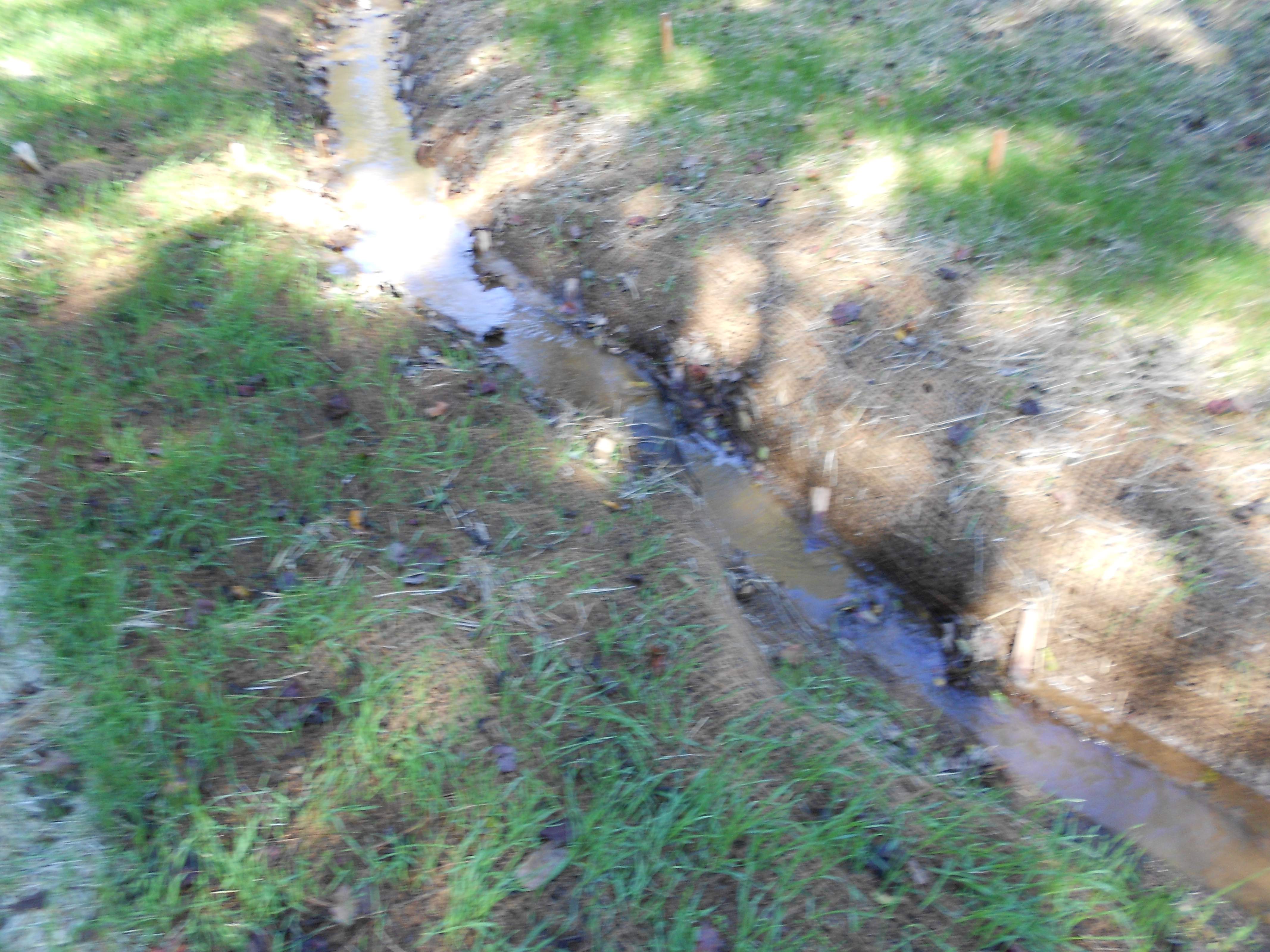

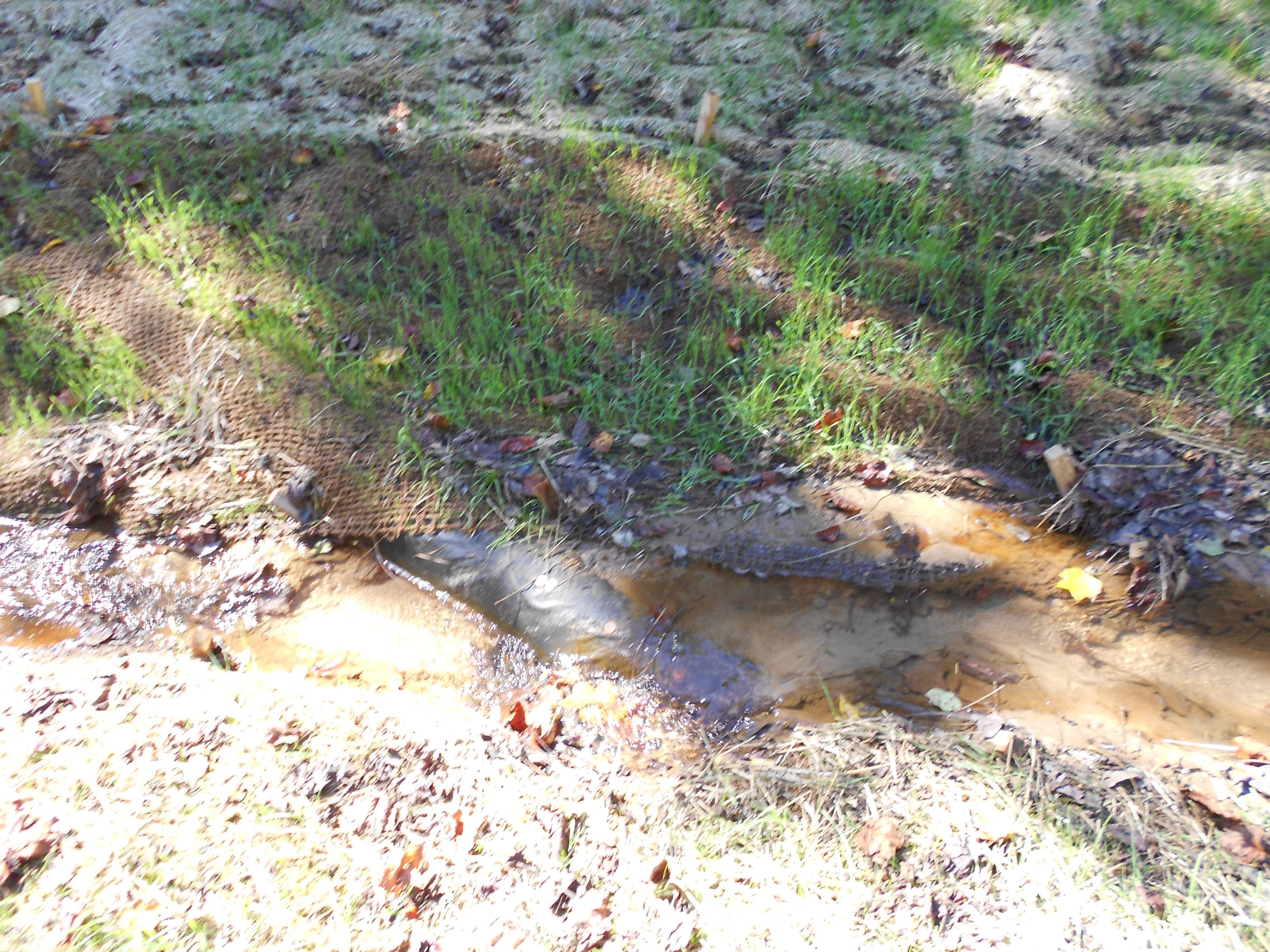

Here are shots of a log vane and a rock vane that also show the coconut netting. The log vanes are hardwood logs (sycamore in this case) that the crew wrapped in a thick plastic.
