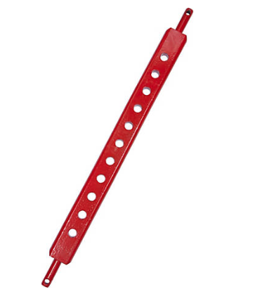

Working Draft 1.1
CROSS-DRAWBAR Screen Shot 2018-10-18 at 5.06.48 AM.png CROSS-DRAWBAR​

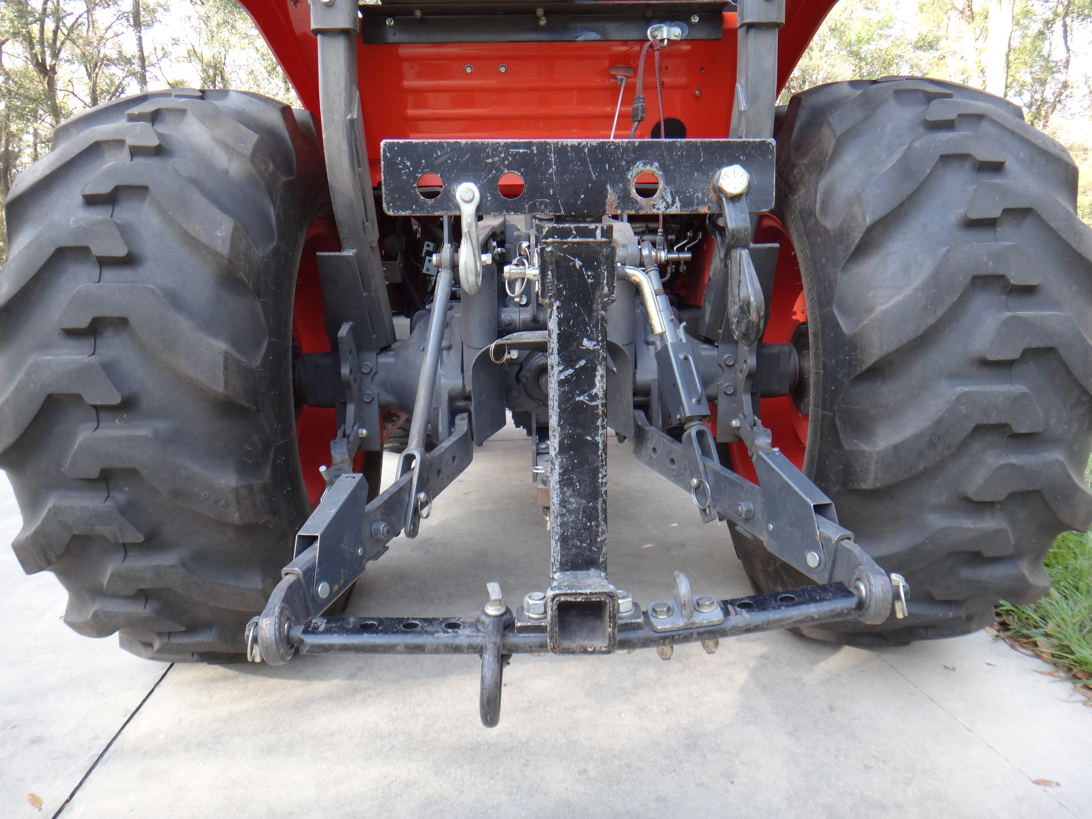

A tractor cross-drawbar mounts through the "bullseyes" integral to the left and right Lower Links of the Three Point Hitch then secured with lynch pins. An inexpensive fitting, known as a drawbar lock, Photo #1, couples the cross-drawbar and one Lower Link to prevent the cross-drawbar from twisting/turning on its axis. Alternately to a drawbar lock, a substantial vertical component, Photo #2, is bolted to the cross drawbar, adding a Top Link connection and a receiver hitch at the base. A third option is an integrated, triangulated cross-drawbar, Photo #3, which includes a Top Link connection. Option three is the high value hardware.
Cross-drawbars are readily available in 20" width for subcompact tractor, 26" width for Category 1 compact tractors and 38" width for Category 2 tractors. Cross-drawbars accept accessory clevis and bolt-on installations. Several attachments are visible in photos. Mild steel is used for cross-drawbars so they bend, gently, rather than fail catastrophically under a heavy load.
A cross-drawbar allows elevation of pulled loads using Three Point Hitch hydraulic power. With 4" to 6" of elevation loads are unlikely to encounter obstructions either stopping the tractor or driving the tractor vertical if the operator in not alert.
(I once had a Deere 750 vertical, towing timbers from the rear/center drawbar.)
With loads elevated less of the load is in ground contact, decreasing friction of the load against the ground and preventing the load from plowing dirt. In some circumstances elevation permits heavier loads to be pulled.
Photos #4 - #6.
The disadvantage of a cross-drawbar is its integration with the Three Point Hitch, a weaker connection point than the tractor frame/chassis. An imprudent operator could damage the Three Point Hitch with imprudent loads or imprudent operation. With loads perpendicular to a cross-drawbar substantial strain is placed on perforated, mild steel bar. Most cross-drawbars in use for some time show distortion but remain functional; mine included, Photo #2.
Any time you are pulling a load with a tractor, the load is trying to pull the tractor over backward. The Three Point Hitch relies on "tongue weight" (mass of the load bearing down on the Lower Links) for vertical stability. The Three Point Hitch does not include a latch to prevent unanticipated upward movement of the Lower Links, cross-drawbar and a wheeled load. Photo #7.
Sudden reversal of tongue weight may occur as cart load is pulled up a slope, over uneven ground, if a cart is inadvisedly loaded at the rear first rather than the front or center first, or if someone steps on rear of the load, shifting weight distribution to the rear. Caution with two-wheeled drawn implements is also advised, for identical reasons. The potential for load upset, tractor upset and human injury is there.
The Three Point Hitch and optional cross-drawbar are designed to pull heavy loads at or below rear axle height, over level ground, with minuscule risk of a backward upset. When the cross drawbar is raised above rear axle height, the potential for a backward upset increases. Always position Lower Links and cross-drawbar at the level of the rear axle or as low as conditions permit.

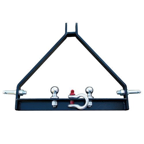

Photo #2 ~ Omni Mfg., LLC, Deerwood, MN Combo Draw Bar Trailer vertical component. (2/2012)
LINK: Combo Hitches - OMNI Mfg LLC
Photo #3 ~ Triangle Cross-Drawbar Hitch

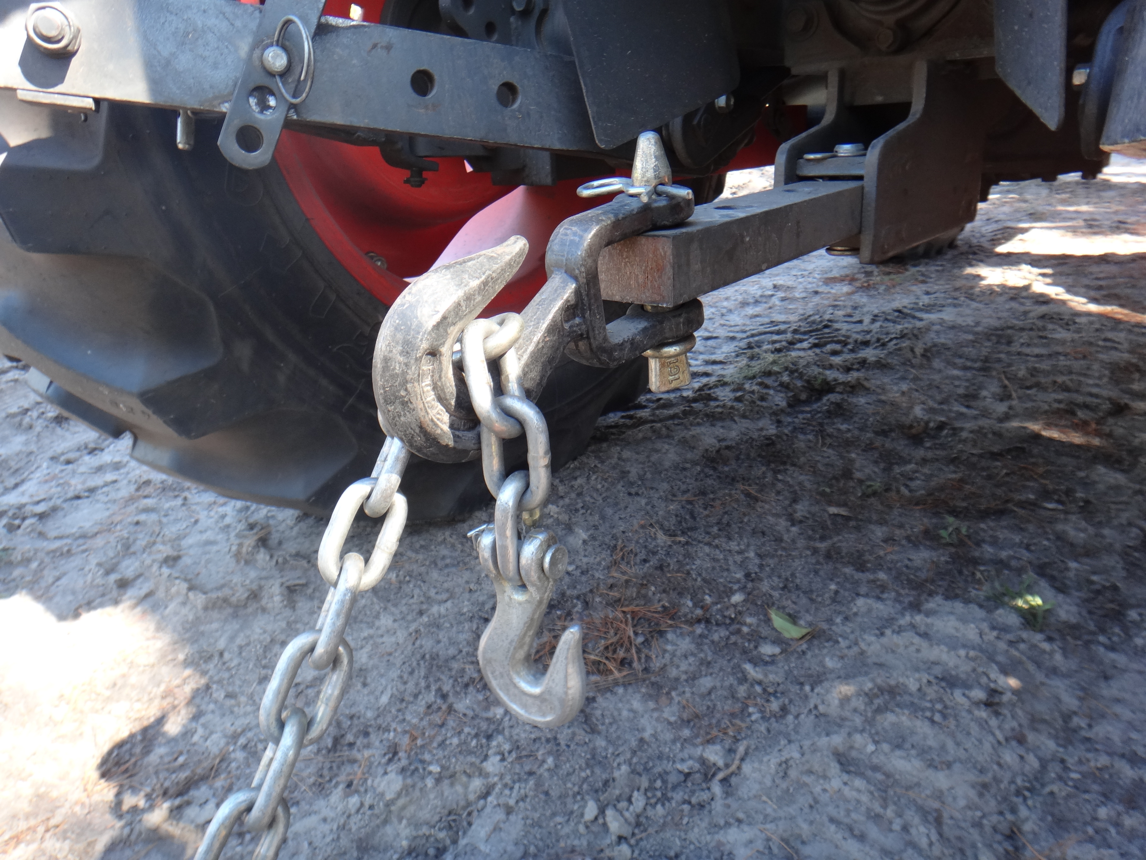

Living on land that has some very steep slopes and having the load slide back while climbing one of those slopes caused an increase in drag, coupled with a reduction in traction as the rear of the trailer started dragging and the drawbar went from pushing down thru the 3pt to lifting thru the 3pt. The resulting loss of traction caused me to spin all 4 wheels as I tried to climb up the hill and the dropped rear of the trailer dug in deeper when I tried to back down the hill. I was stuck. With a steep drop off to the left and a steep up-slope to the right, turning wasn't an option, either. I was stuck, but good. I put the brakes on, placed a log behind the rear tractor tires (unless I'm on level ground I don't trust the parking brake, especially when the trailer is trying to lift the rear axle). Convinced that the tractor-trailer combination was adequately immobilized, I climbed into the trailer and moved the load forward until the rear of the trailer lifted off the ground and the 3pt dropped back down. I was then able to climb out of the holler and back up to the level field. I chained the hitch (pictured) to keep the hitch from lifting, should the load ever shift again. It does this very effectively. What it doesn't do is change the lifting force applied to the 3pt by the trailer when the load shifts aft, which reduces traction (and braking). As a former truck driver, I am ashamed to admit that I was guilty of the basic offense of "Failure to Secure the Load". More attention to trailer load management & less reliance on hitch band aids are my take aways from the experience.
-Jim

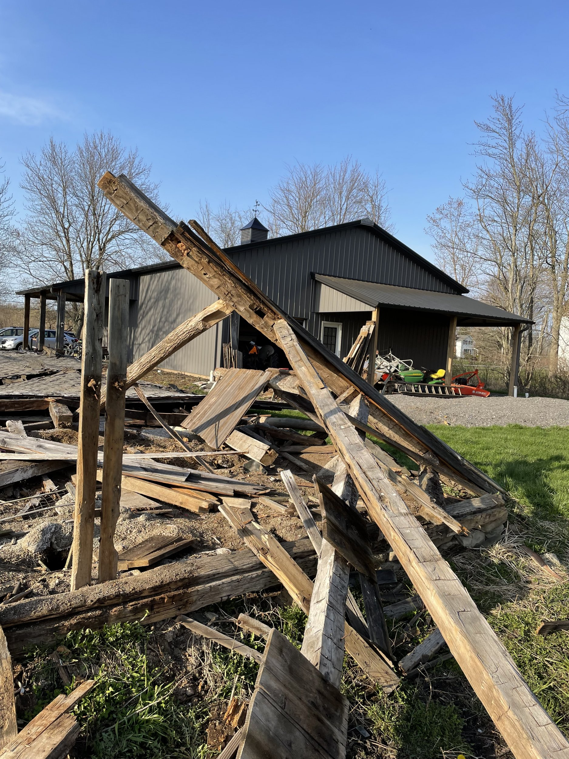

I just pulled down an old 36’ wide x 46’ long x 16’ wall barn, that my great great grandad had built in 1883, using the cross drawbar hitch on my JD 4120. I used a 1/2” wire rope thru a snatch block, attached to a big tree on the other end to double my pull.
It dropped very easy, with the tractor in the lowest gear. The cleanup is going to take me a while. 4 layers of tar shingles on top of two layers of cedar. The chestnut roofing boards and oak rafters under that is in pretty good shape. I am going to use that, and some of the 6” and 9” square hand-hewn posts and beams to build a big woodshed on the back of my new pole barn.
I would have liked to save that old barn, and another twin to it that I dropped a couple years ago to make room for my new pole barn, but the roofs and foundations were shot.
