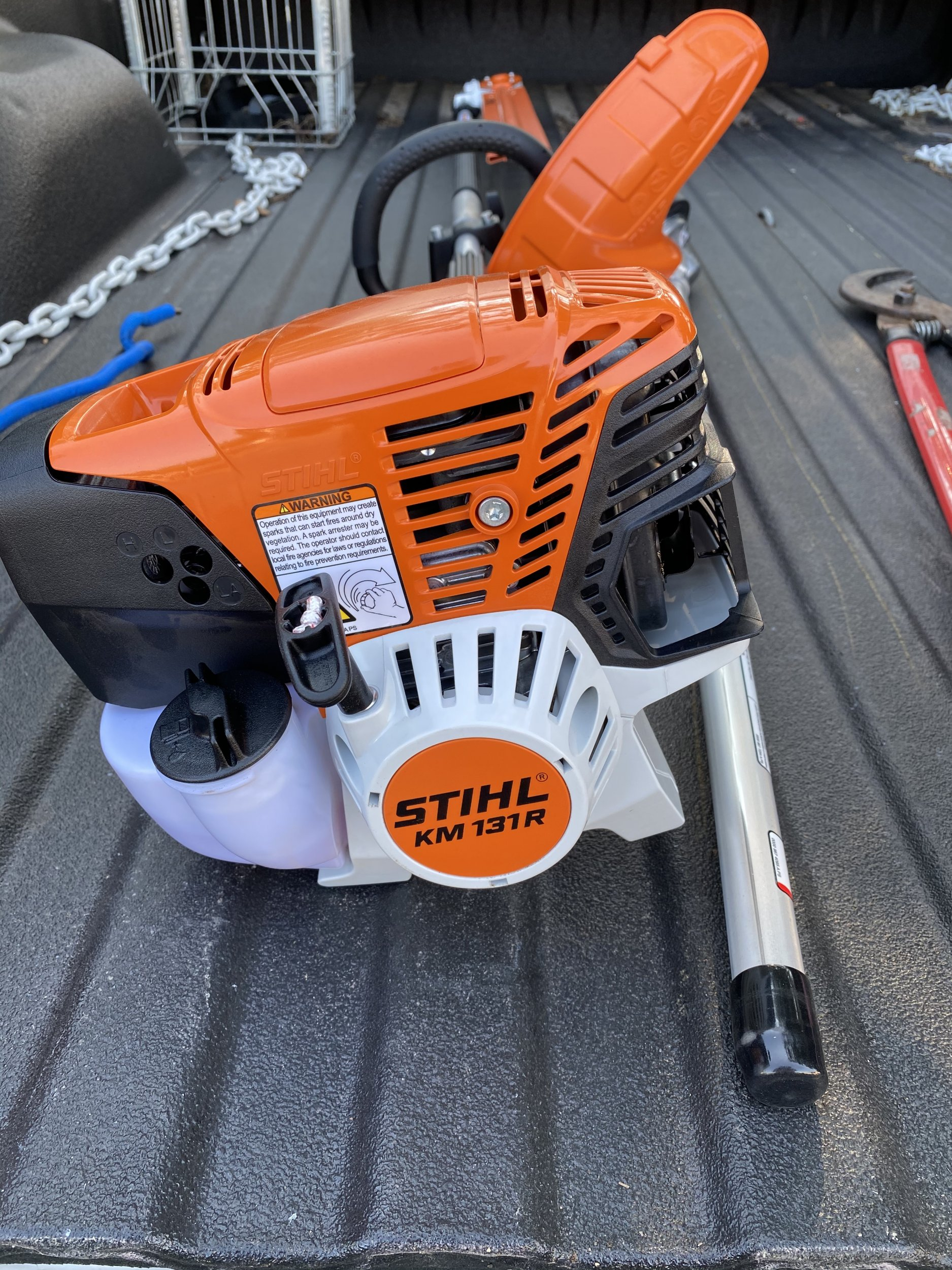

But, ...... just a couple weeks ago I bought a Stihl Kombi Motor powerhead KM 131R. This is a dream machine!
I bought the Hedge trimmer and string trimmer attachments with it. It’s powerful and so versatile. I just went today and bought the straight shaft edger attachment. I have used a McLane edger for 30 years and it’s a good powerful machine but this Kombi Motor with the edger attachment is so much easier to use and transport than the McLane. I used the string trimmer on the FS110 sometimes for convenience instead of dragging out the McLane but this edger attachment is much easier to use and does a much better job than a string trimmer.
I was skeptical that the attachment would work as good as the McLane but it’s every bit as good on the drive way and sidewalk I tested it on today.
I was skeptical that the attachment would work as good as the McLane but it’s every bit as good on the drive way and sidewalk I tested it on today.View attachment 705079

Two bit, please post a review in the Kombi KM 131 thread.
I just posted it. I had been thinking about those for years and as a result of your review thread decided to pull the trigger on one.
Anyone needing a strong String trimmer, hedge trimmer, pole saw, edger, etc should consider a KM 131R.
