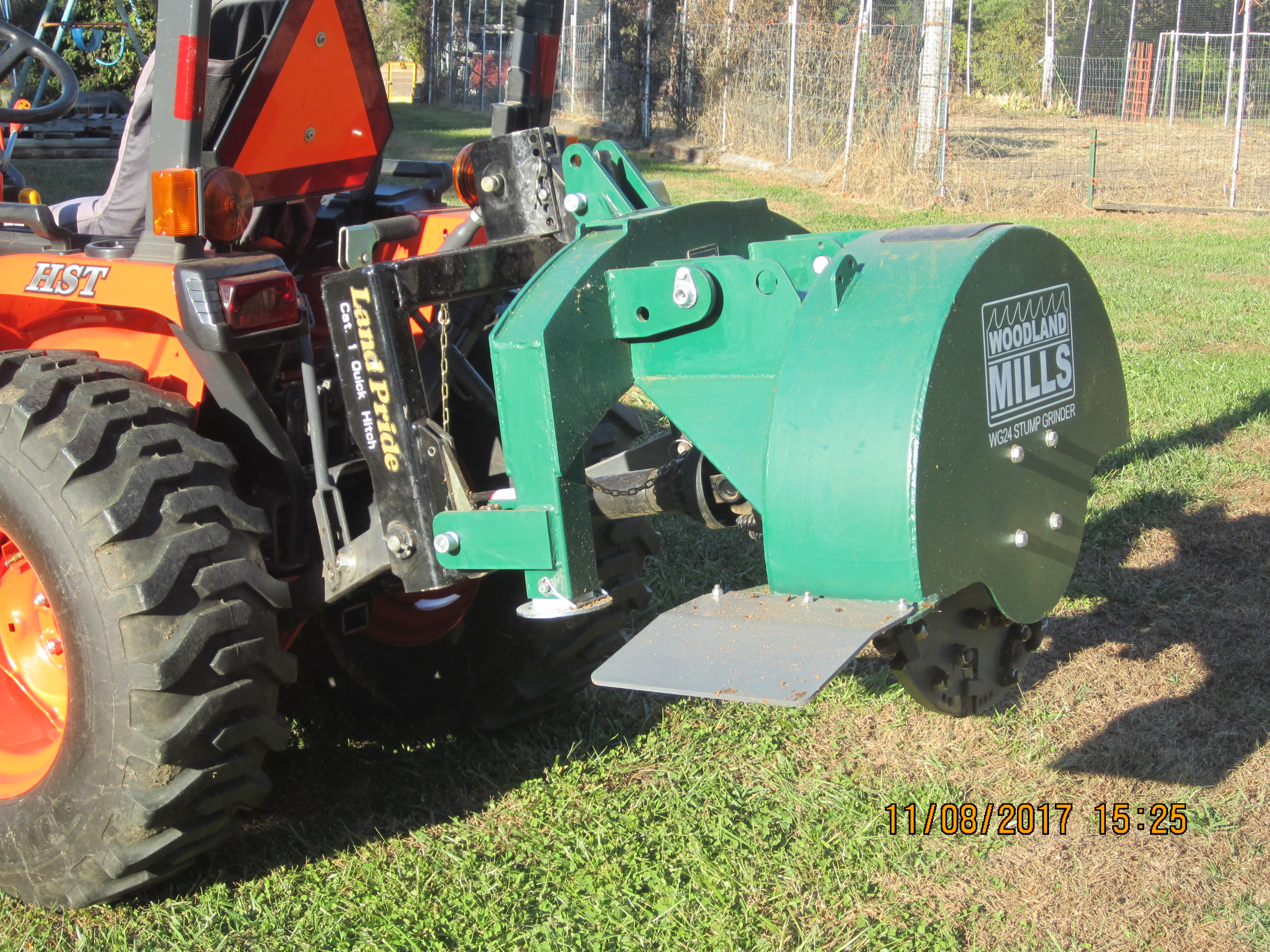

I'd be looking at the Woodland mills grinder, it's a bit more money, but it looks to be better built than that one and comes complete, ready to go...
I have one, and I don't use it on a tractor with the whiner transmission, my tractor is gear drive with creep gears...
I ground 32 stumps with it the other day...
