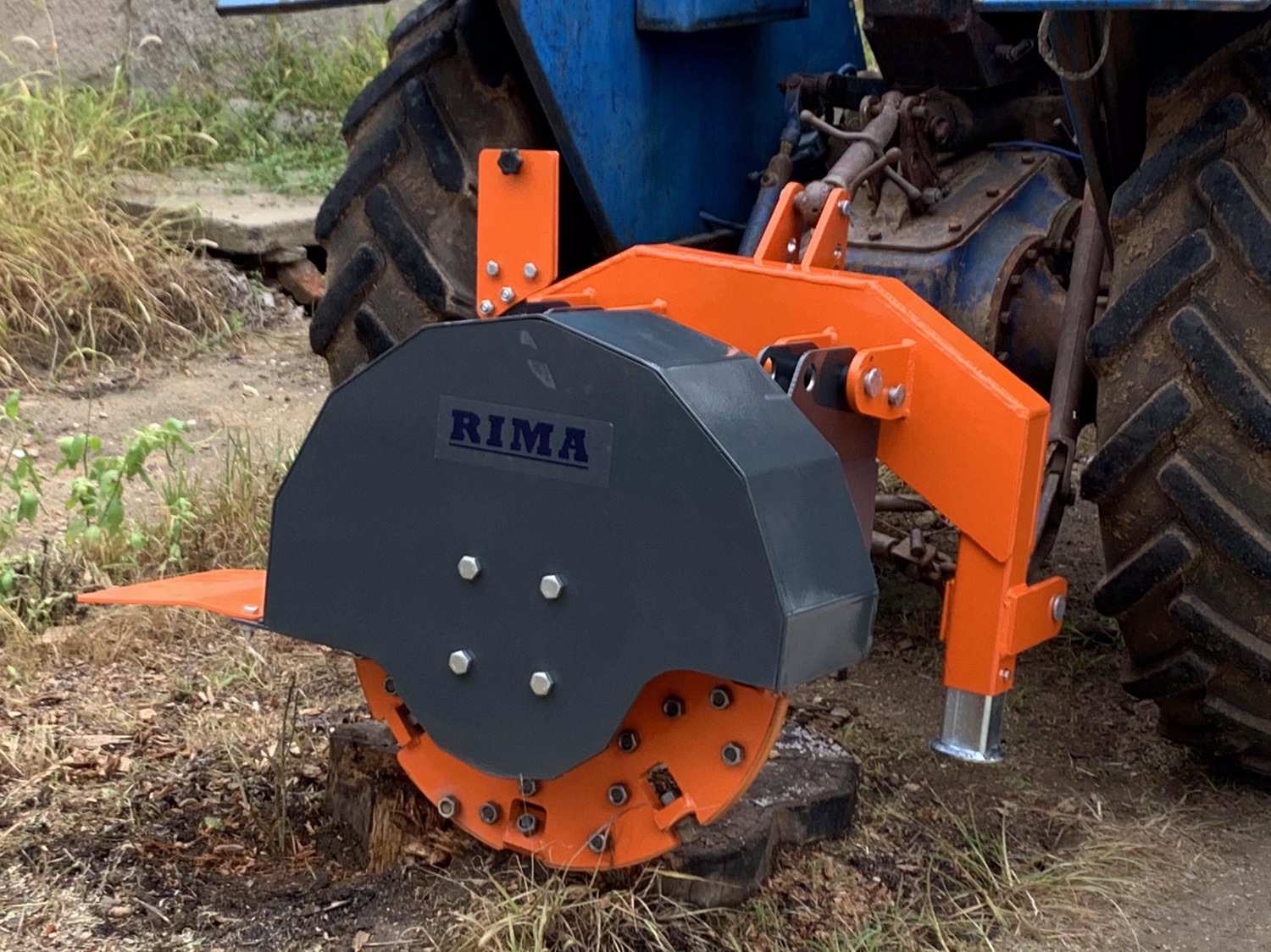

Mr. JCoastie, based on your initial use, what are you finding your average time for grinding - let's say an 18 to 20 inch diameter stump?
Mostly Southern pine here ... if it's a fresh stump of that size, it can take upwards of 15 minutes. If it it's old and dry, it could be under 5 minutes.
Oak and some other varieties here can be a real bear and take upwards of 20 minutes. Almost all of mine are on a hillside so I have some extra grinding to do to get the change in elevation right so that my bushhog will not dig in and get a stump strike later at some point.
