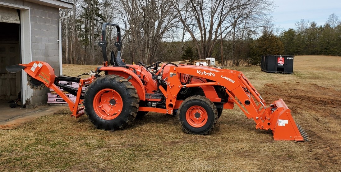

Mr. Steppenwolf, is that a tooth bar on the MX, or a bucket with welded on teeth?
Any chance for a picture of that?
Also, would you be willing to share a rough cost on the LP stump grinder?
I just received a quote for grinding ~20 stumps at $1800.
At ground level, they are from 3 to 6 feet across.
Surely we can turn it into a DIY project!!!
/ Stump Chipper #66
It's a tooth bar... I believe a Titan, 380 bucks installed. ( 72" Bucket 23TF Tooth Bar) . The stump grinder was 5k... and was a year old model, the new are supposed to be 6K. :confused2: I have about 120 acres of woods and wanted it for obvious reasons. It sure does work good.

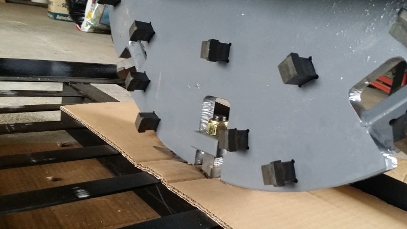

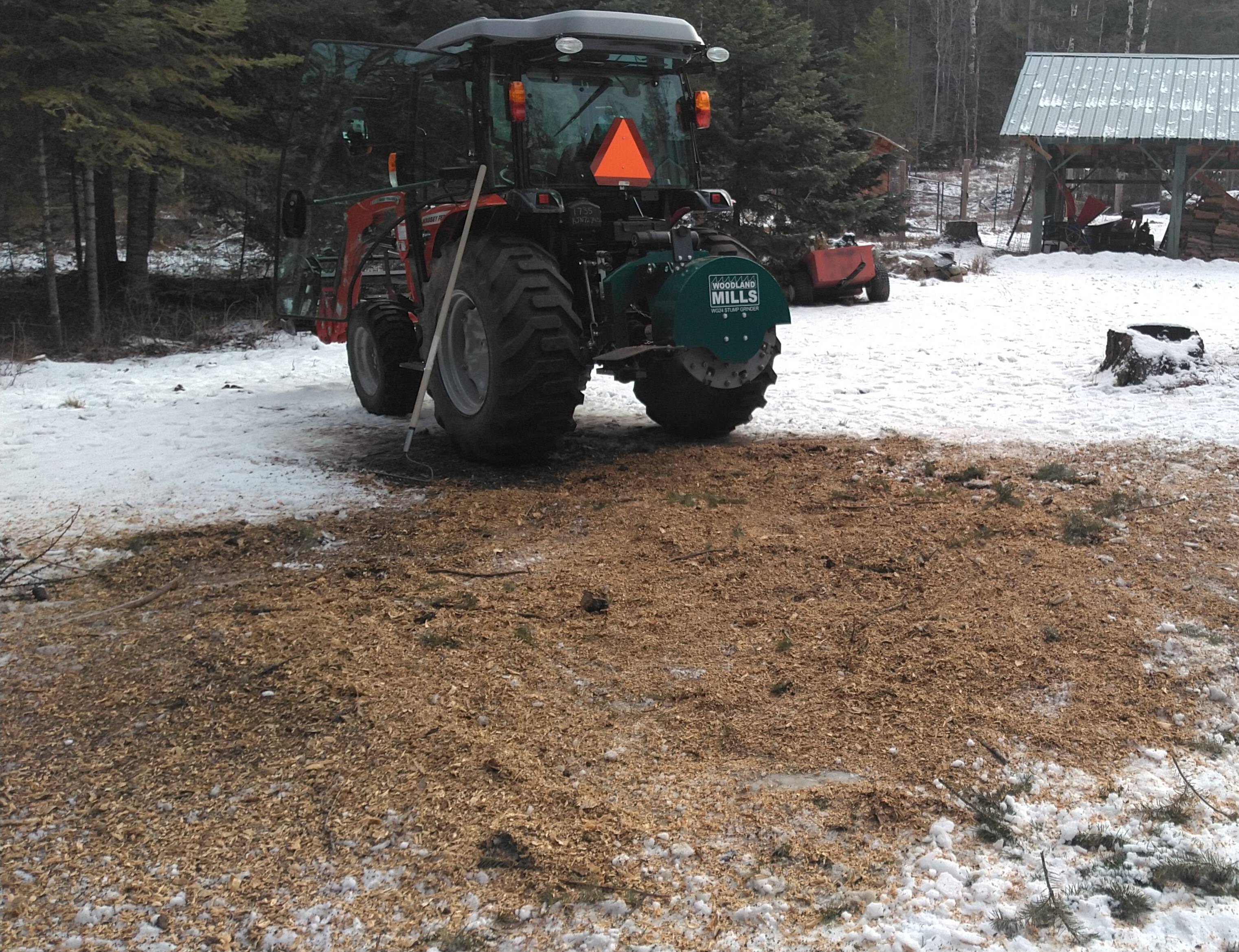

wound up buying the woodland mills WG24, it was delivered Monday, a week from order to delivery.
Been eating up stumps for 3 days now, it works well. Figured I'd lube it up this morning, and damn zerk broke clean off when I removed the grease gun on the bearing closest to the PTO. That was a 4 hour delay to get the old one out, and a trip to town to get a replacement from TSC. Be careful with that one. It's an M6x1.0 zerk.

Mr. JCoastie, based on your initial use, what are you finding your average time for grinding - let's say an 18 to 20 inch diameter stump?
/ Stump Chipper #72
I got a WG24 a couple weeks ago and it's been pretty awesome.
/ Stump Chipper #73
mostly long needle pine here, soft and quick. So a stump that large may be just 2 or 3 minutes with my 40hp tractor.
I think I take larger bites than I should, but it works well. No rocks here either.

It looks nice and heavy built and the only difference apart from the curved woodland design is the grease able pins but if I would do it again I probably would get the woodland mills.
