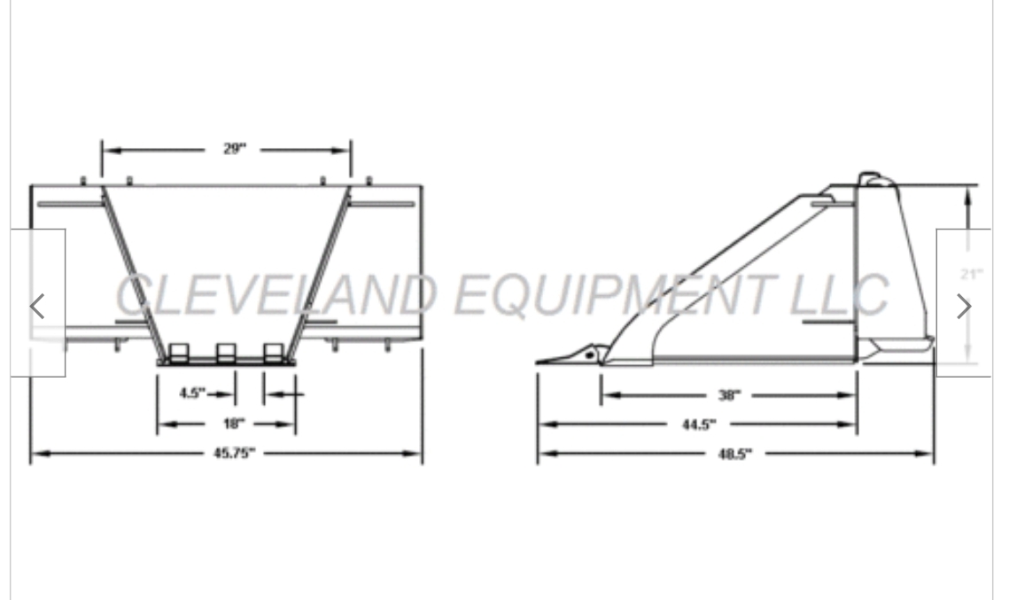

Had one on my tractor. The problem is the bucket bottoms out at the end of its travel length. It's as if i would have to dig a 4' wide ditch when I need just a 16" width one just to make room for the tractor tires to ramp down so the bucket can reach 2' deep.
That's exactly right, dig it as wide as the tractor and get it done, with little expense... It's easy to back fill the ditch!

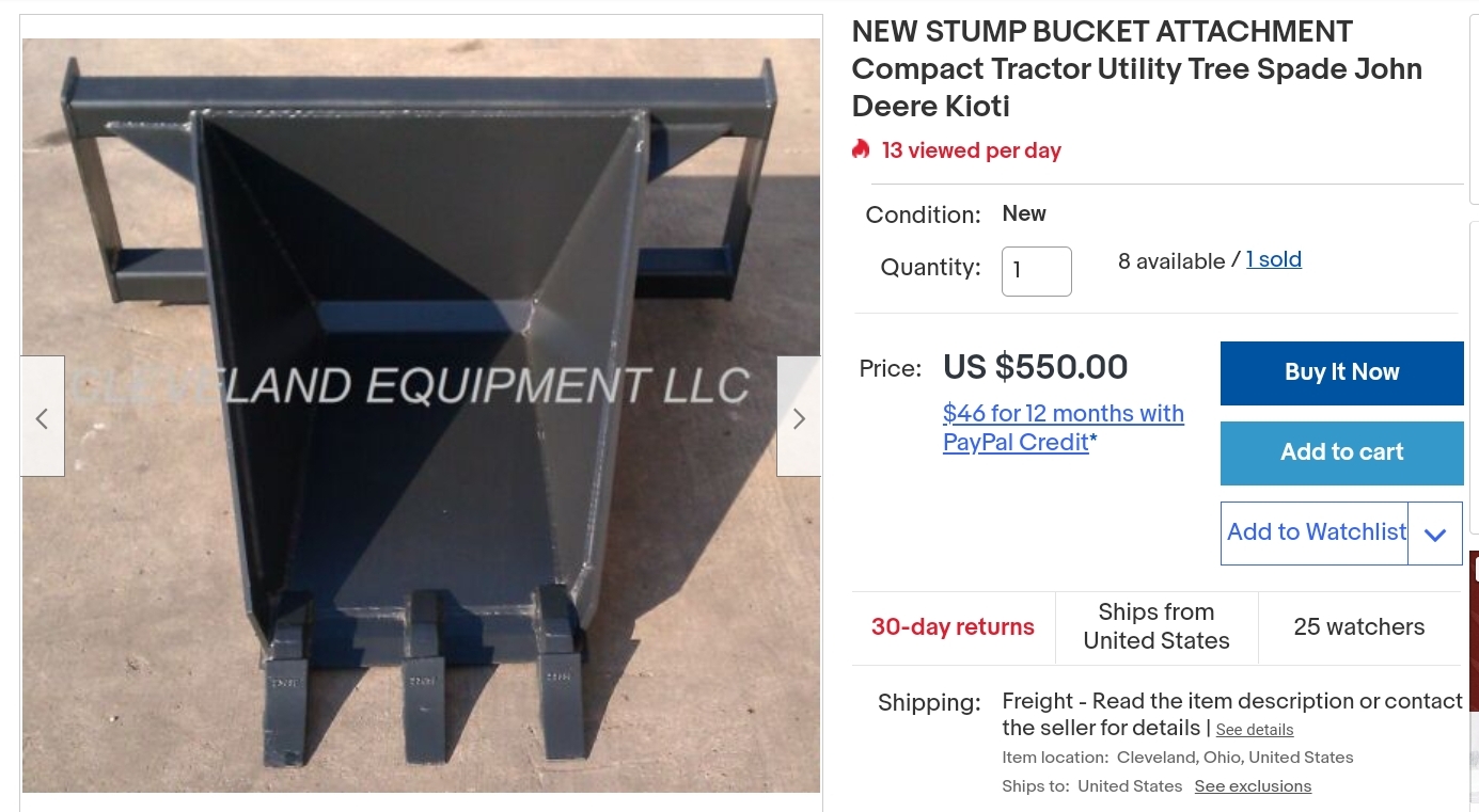

So it went like this: Renting will cost around $299. Finding and purchasing a "narrow" stump bucket say $500 or more.
What I did: bought a quick attach plate on amazon 5/16" thick with Prime incentive came to $115 tax and shipping included. Went to my local welder and bought 1/4" steel plate that he will cut the shapes I want (bottom, back and sides- $85)
Welding...perhaps $20 in electricity. primer and paint...$25. So for about $245 and my time, I'll have what I want to dig a ditch, bury a duck or dog and remove stubborn over growth.
It all came together so thanks for everyone's input.
