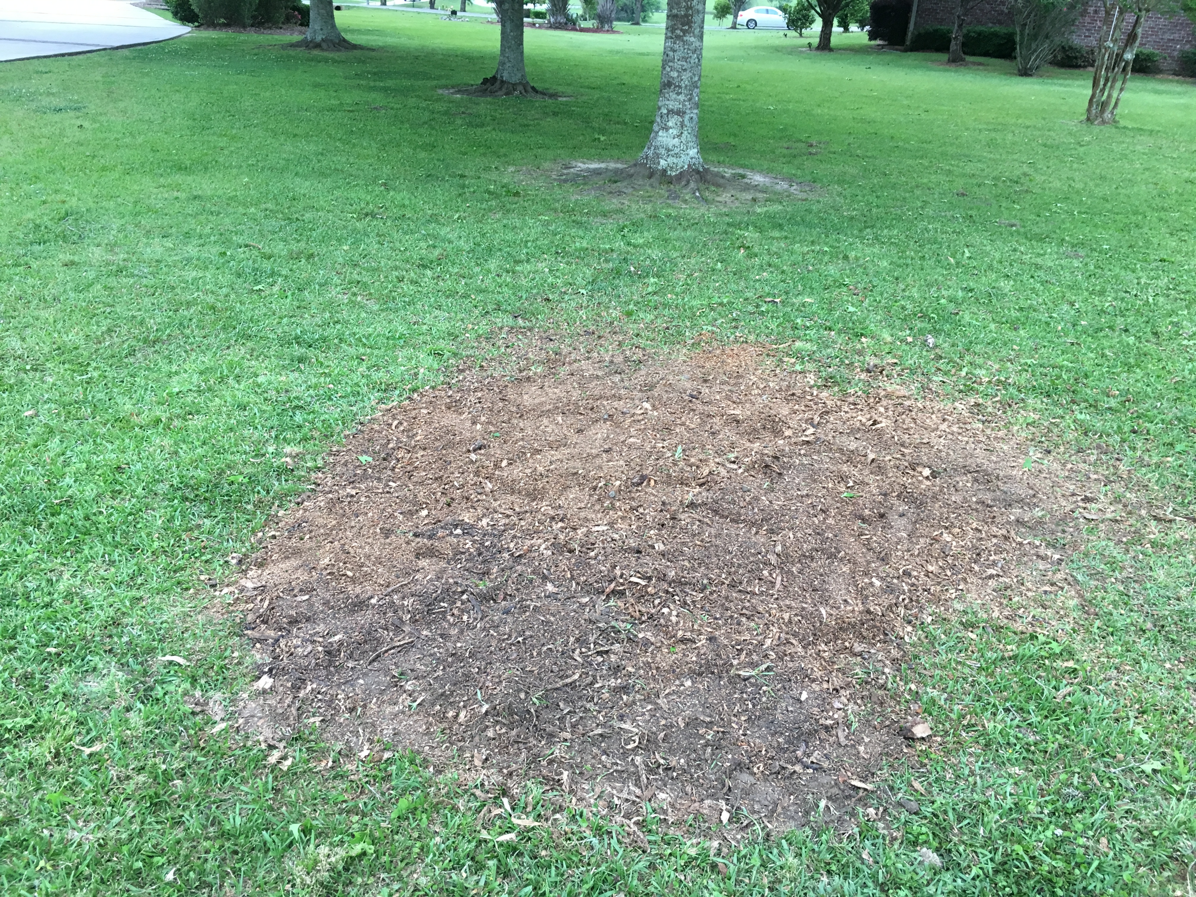

I picked up a lightly used WG24 late last summer. I had around 30 stumps of all types and sizes. I put it on the back of a JD955. I found it worked very well. It takes some getting used to, and no, my neck would not be happy after 8 hours of using it. But it was great for my use. Simple, easy to mount even without a QH. It gets down around 5-6 inches, plenty for seeding or sod, not enough for footings. I have used the Vermeer 3 wheeler with the 25 hp Kohler. That's much slower and an absolute pig to use. And renting it is not cheap either. I cut these stumps over a couple months, it was nice to do it on my schedule, not the rental companies. :)

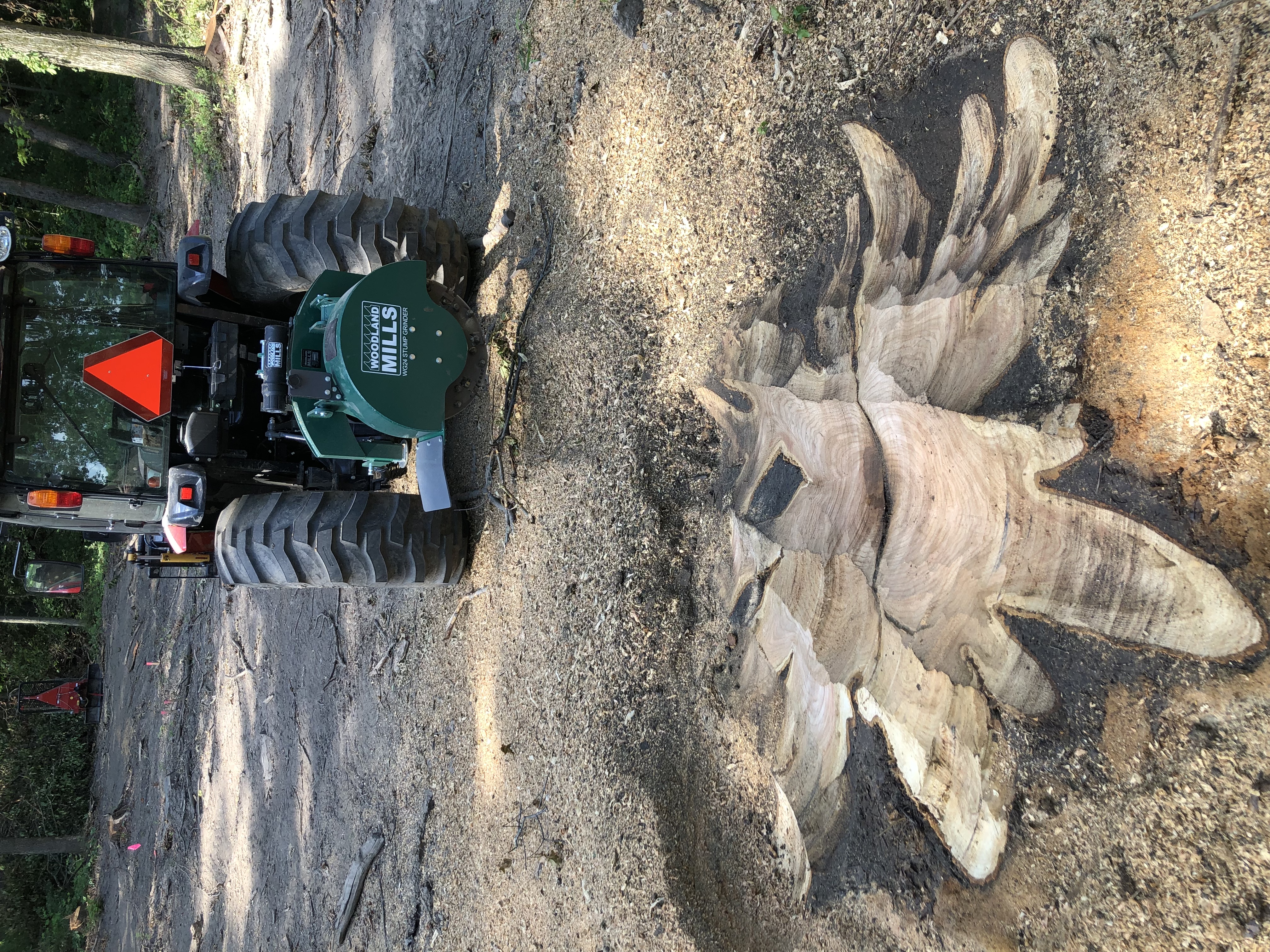

Used the WG24 to clear out some large rock hard oak stumps from a clearing job this week. I also chipped 3 dump trailers full of chips with the WC88 chipper. I am extremely pleased with both machines. The stump grinder is an absolute beast as soon as you get used to it. Not sure how anyone could complain about these units as they are extremely well made and perform great. The driveshaft twisting is either due to cutting the shaft too short (as appears to me from the pictures above) or operator error. If the shaft length is correct and the ship clutch set correctly then taking too large of bites or/and moving too fast. I drove 30 minutes each way to a job this morning and ground 3 large oak stumps and was back home 2 hours from the time I left:) The creep speed, shuttle shift and e-PTO on the M7060 is the cat's meow for this grinder.

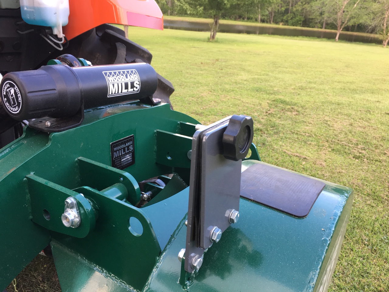

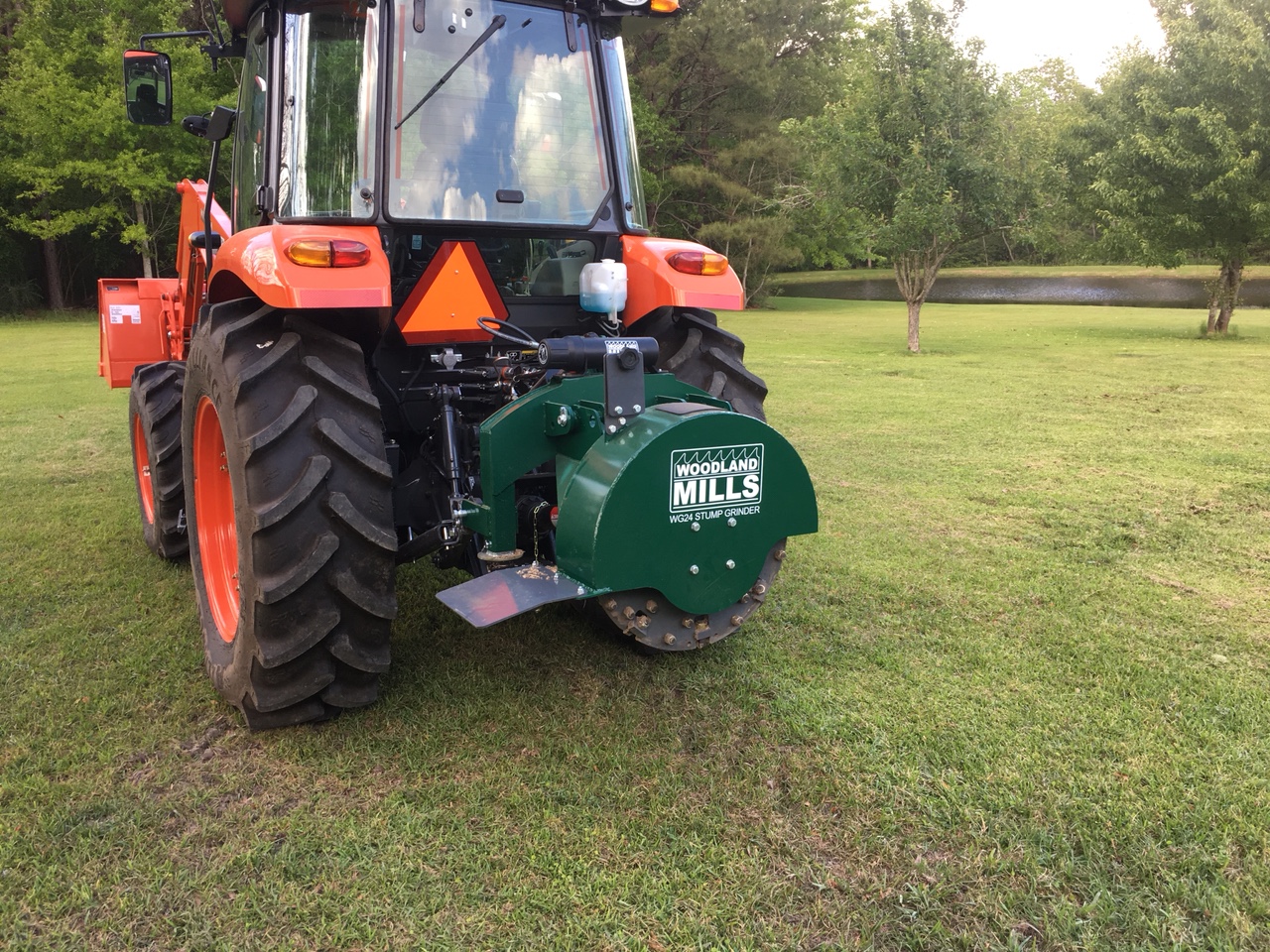

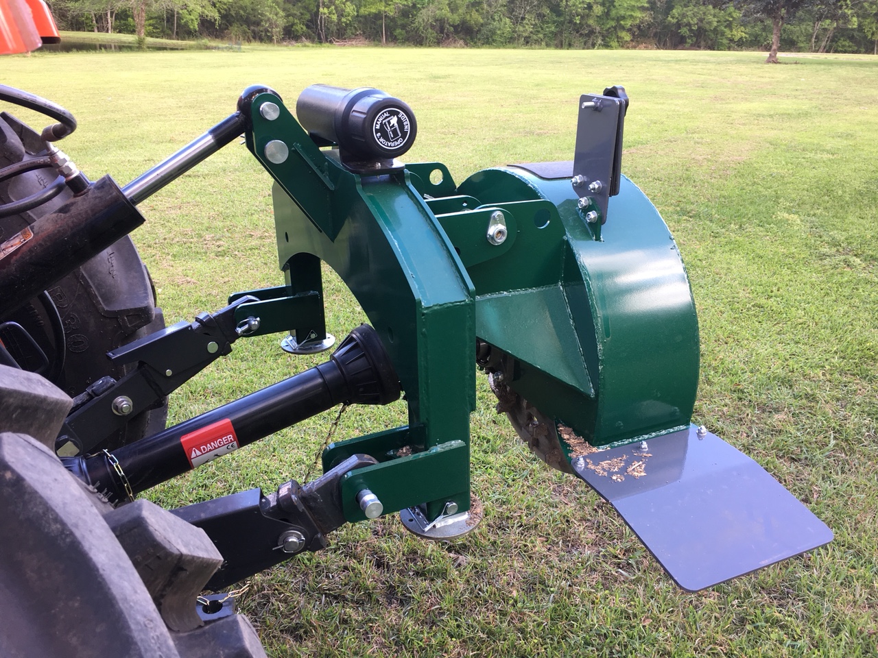

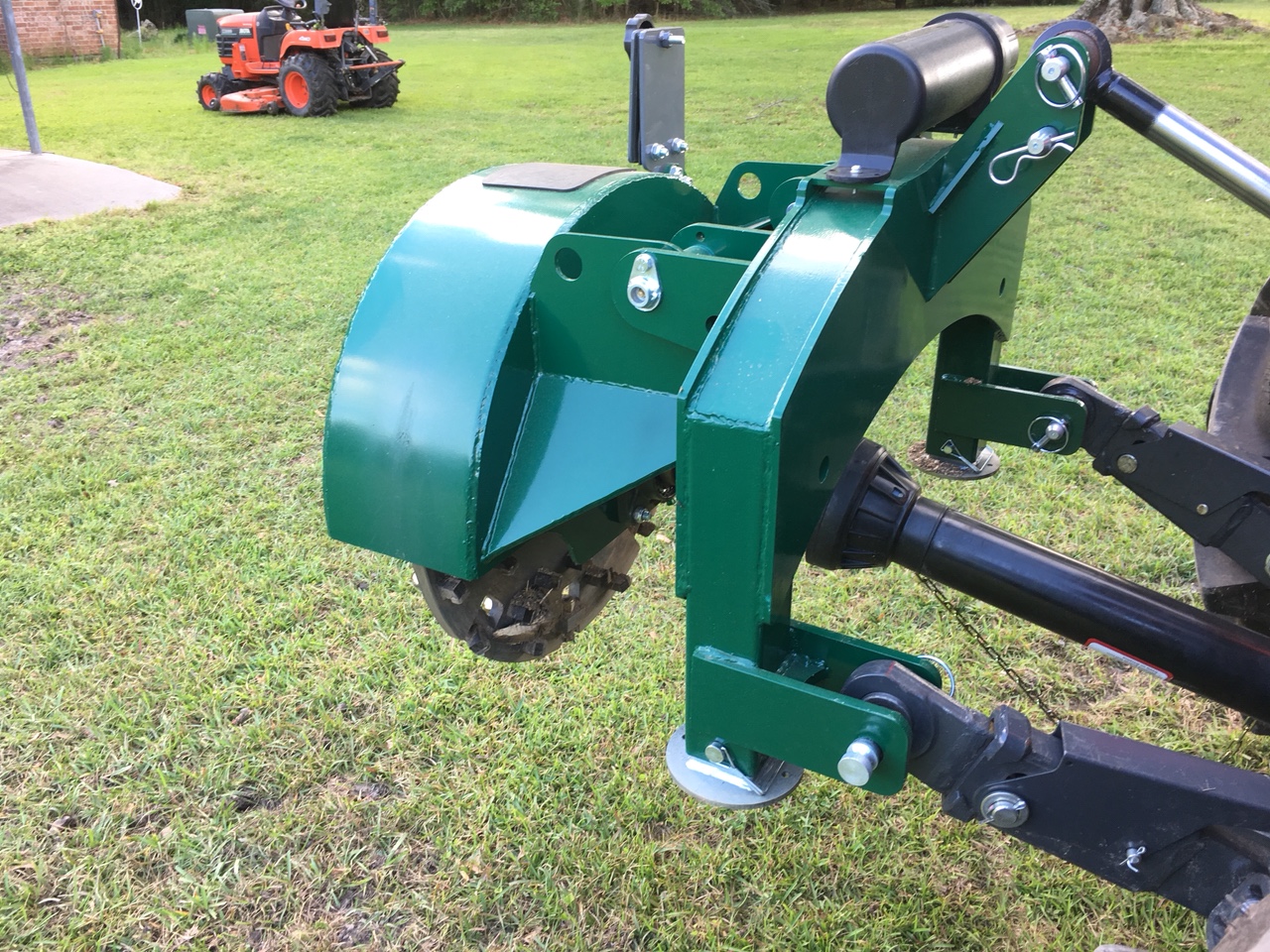

Well I have had the WG-24 for a good while now and it has been excellent! I think it is easily the best value stump grinder on the market. I have used it up until now on my M7060 and although I was very happy with it on that tractor I shortened the PTO shaft and tried it on my BX 2200 with only 15 PTO HP just to see how it did......totally impressed! I actually like it much better on the little tractor as you can see better and maneuver quicker and easier. I have used it enough to know how to best operate it so I can grind a stump just as fast, if not faster with the lil BX. Woodland Mills says you need 20 PTO HP minimum but the BX has less and it will still take a full bite each pass, just keeping the travel speed as slow as needed with the hydro pedal. It is also even more comfortable as I can throw my right leg over the rear fender to sit sideways and run the hydro peel with my left foot. I will probably add some padding for my leg on the fender since in the coming months I have literally hundreds of stumps to grind. This is one of the best attachments I own.
