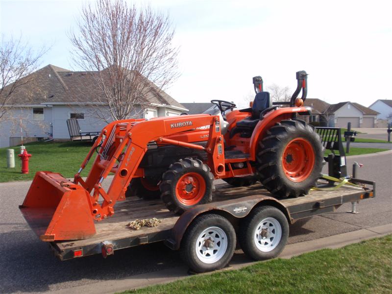

I need to do a couple upgrades to my trailer this spring. I have another thread running on fork pockets and I think I have that sorted out OK. The other one is the fenders. The ones on there are getting pretty rusty and cannot handle being stepped on, even though I do it at times (sometimes unavoidable). This is the double axle trailer in my avatar, 2x 5400lb axles, 15" wheels (IIRC - I don't have it handy). I would like fender I can safely step on. 2 questions:
1: Are sturdy ones available out there pre-made? etrailer had nothing for duals
2: I can bend/weld up my own but what thickness steel is thick enough but not crazy thick? 14 ga? 12 ga? 1/8"? I'm not sure if I can brace them in between the axles/wheels for support, but it may be possible.
Looking for some guidance based on others who have similar setups that are sturdy enough to stand on. If I bend my own they will be simply angled, not curved. I could add a front apron with a curved cutout for the wheels perhaps. I suspect I will end up making my own.
And any other advice welcome.
Thanks

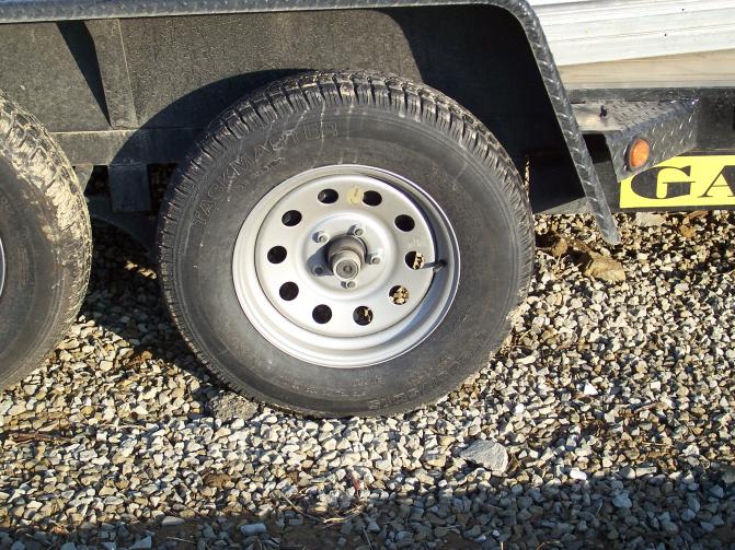

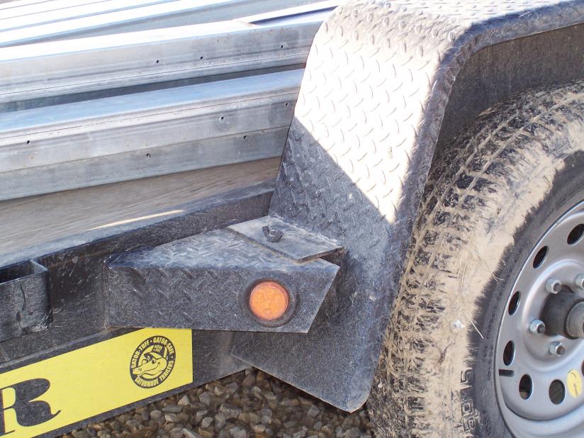

I was cleaning up one the computers here at work and found a couple of pictures from when I first bought my trailer. Ironically I had a couple of pictures of the fenders on it. In the first picture you can see the tab the holds the fender on the trailer. On the second picture you can see the diagonal brace that supports the outside edge of the fender. BTW, that brace comes off with the fender because it is attached to the inside of the fender, that whole back plate comes off with the fender.
I like this idea.
I have two brand new custom axles sitting in my garage waiting for me to get time to put them on my tilt trailer. I'm pretty sure that the new axles will make it so I need new fenders, too (more drop to these new axles). I'd love to get some sturdy fenders I can stand on that are easily removable. That wing not concept looks like a good one.
/ Sturdy trailer fender?
While it looks interesting for those times when you need to remove the fender (I don't seem to have that need), I can't help but think the wing nuts would vibrate loose in short order.

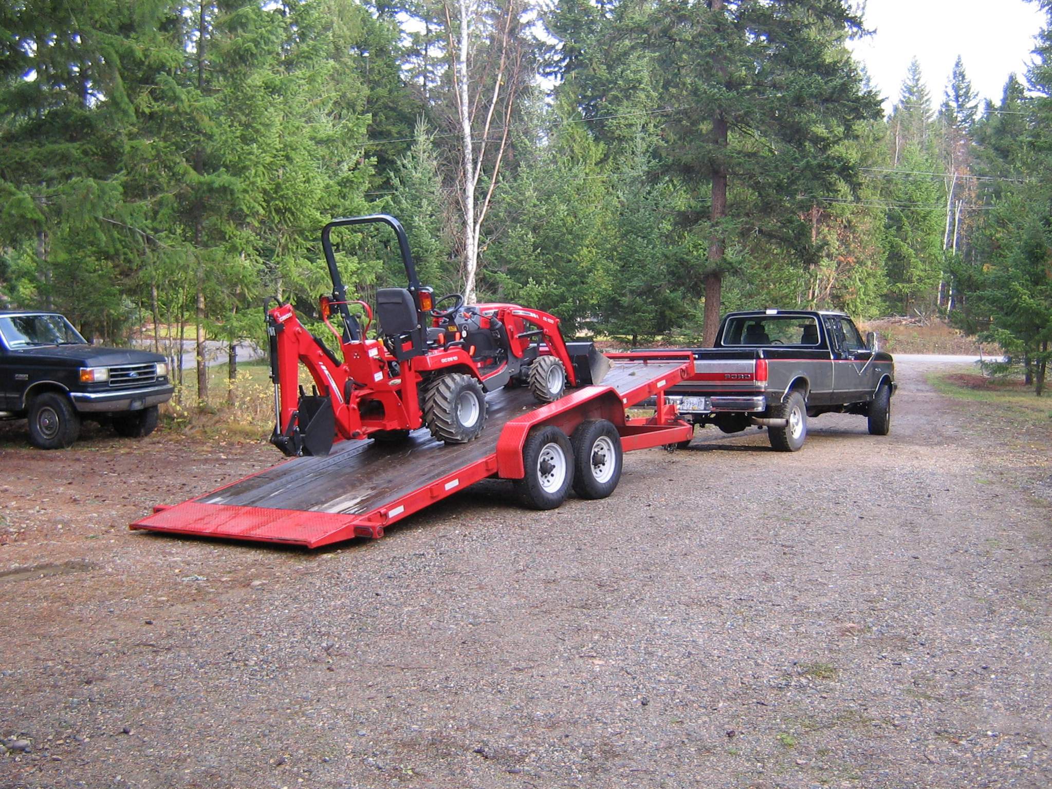

This pic might give some of the information you want. They are welded on and made of 1/8" checkerplate. I've added an angle brace on the driver's side in the centre between the wheels so that I can stand on it without any bending and plan to add another to the other side it works so well. Sorry, I can't take better pics right now as the trailer is under 3' of snow.
#12
Not2old - thanks for that. I like the setup. What did you do for a brace? I'm thinking a gusset of the same diamond plate material would work for that.
