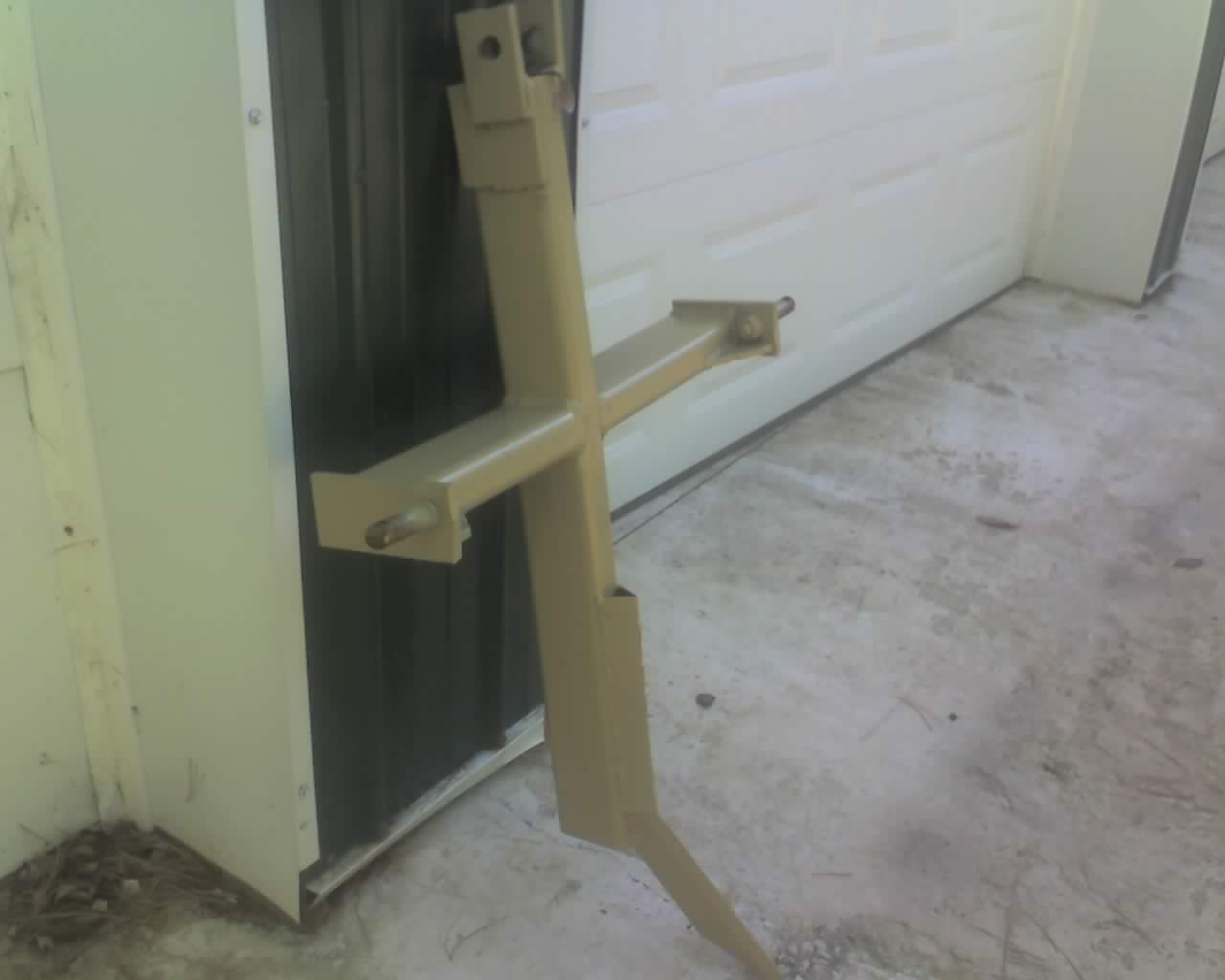

I have no first hand expierence but I still fail to see how a shorter toplink will give more bite.
The shorter it is, the closer to perpindicular (90 degrees) to the ground the blade becomes. Since a 3PH has NO downforce, wouldn't that make the bite less. Wouldn't the closer to parallel it becomes probide more bite?? Same as a blade, 50 degree agle from the ground will provide a better bite than say 70*
   / Subsoiler Qs #14
The subsoiler's tooth starts out at a very shallow angle that's close to horizontal, causing it to tend to ride along the top of the ground. Shortening the top link causes it to dig in deeper/ harder.
   / Subsoiler Qs #15
I guess I can understand that. Going from 90 degrees being perpindicular and 0 being horizontal, typically the lesser the angle the more the bite, but ONLY to a point.

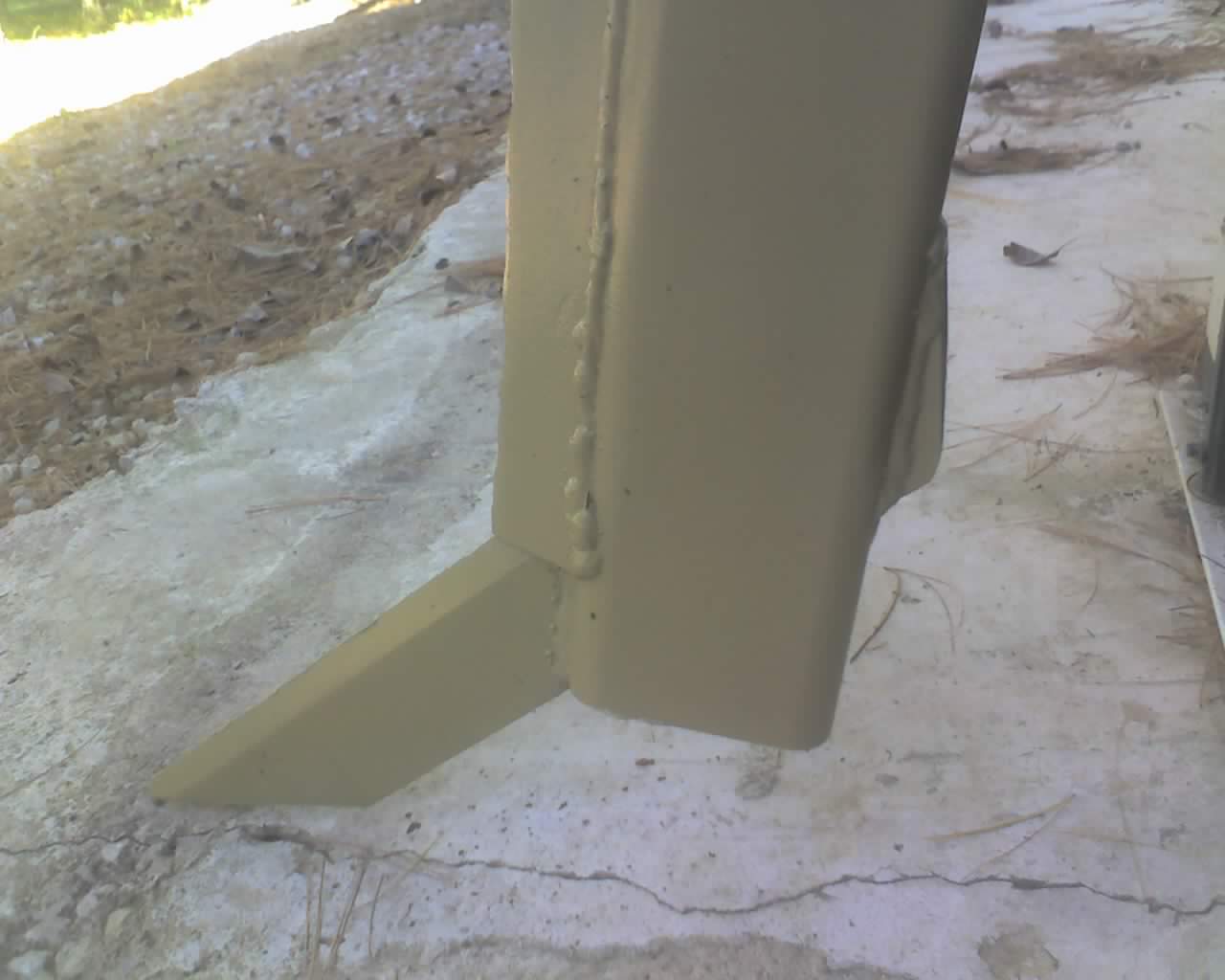

I wasnt taking into account how low (near horizontal) the angles were on a commercial subsioler. My homemade one has a steeper angle, so lengthing the TL DOES give me more bite. But then again, I dont consider mine a subsoiler. It is more like a ripper that I use for mainly two reasons. Cutting roots when digging stumps and busting up hardpacked clay to make FEL work easier.

I thought I did pretty good though making that a few years ago with just scraps that cost me nothing. Even the Pins I turned on the lathe from free scrap. But after reading the "your time is not free" thread and considering it took me ~ 5 hours to make, I guess I should have just bought one for ~$200 bucks. As it stands now, I am $250 in the red on this baby. But the sharpened edge probabally slices roots better then a TSC one though.
