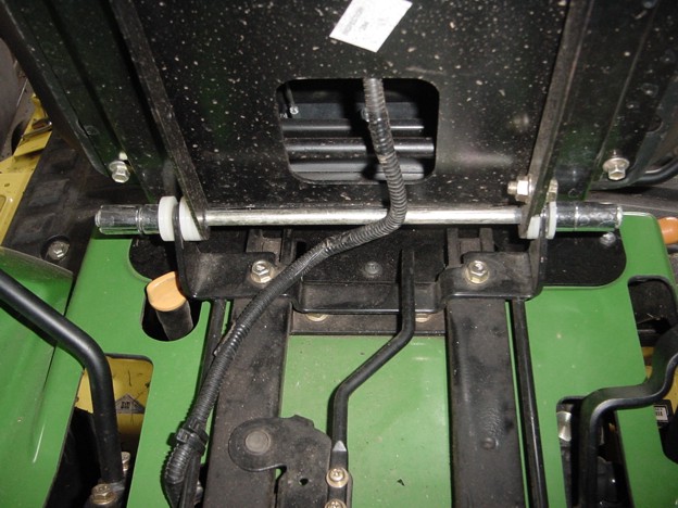

Here's a picture of the seat pivot pin on my 2210.

Hey Ira have you looked at the Special edition X seat yet? Did you get how I think you can mount the seat with very little mods?

Jim,
I think I understand it a little better. I also got an exploded parts view of the seat from the dealer, which also helps. Problem is that if I buy it and can't get it to work, the dealer won't take it back. Guess I could always try to sell it on the board at a reduced price if that happens.
I will probably order it next week sometime.
