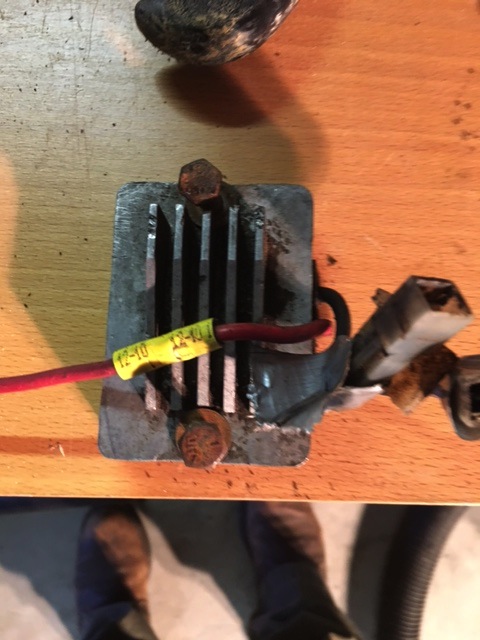

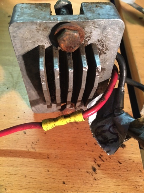

#17
I believe this is a solenoid. It has a red wire that goes to the starter. Was wondering where I can find a replacement. It is attached to the inside of the of the tub by the starter. Image.jpgImage 1.jpg
Thanks

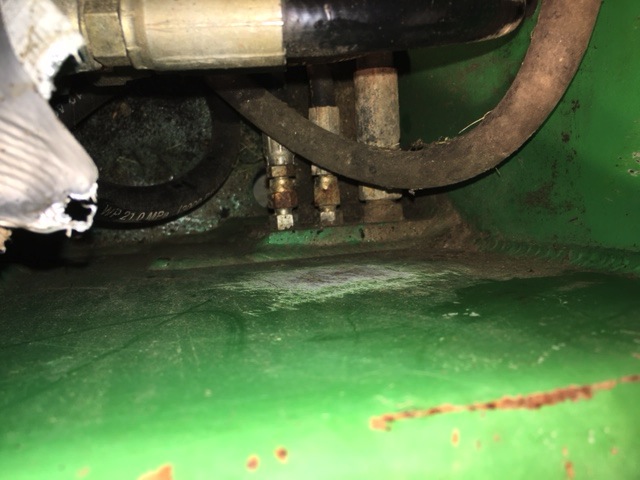

#18
The one hose coming off the oil cooler is a piece of cake to swap out, however the second looks like it is going to be a real headache. In the front lower left hand corner of the tub there is a manifold of hoses that tie into the reservoir. This hose appears to be on the bottom row under these here in the picture. I am guessing I will have to take all these hoses off to get to the one I need to take off.Image 2.jpg

At a sticking point with one of the cooler hydraulic hoses. It is in the lower left corner of the tub at the reservoir. There are five other hoses. I removed the hose over top of it and one to the side, however I still cannot get a wrench on the fitting. The male fitting of the hose I removed is in the way. Are there special wrenches for this? Real tight spot and afraid if the I were to get a wrench on it, if it slips I will mess up the threads on male fitting directly above. I agree 1000% with you Tim, hard piping definitely would have been better in the tub.
