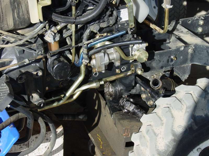

Just back from the dealer can't belive what I saw. Here is what it takes to change out the oil pan.
Here are 4 pictures and let me warn you all, it is ugly.
George

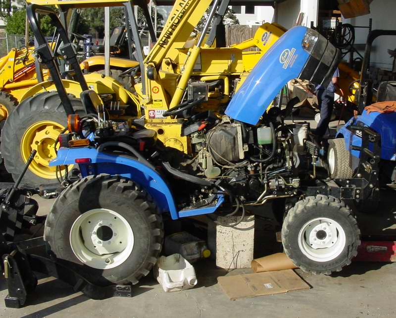

Picture 2 of 4

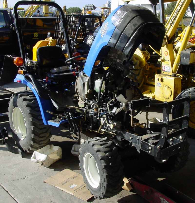

Picture 3 of 3
Anyone sick yet?

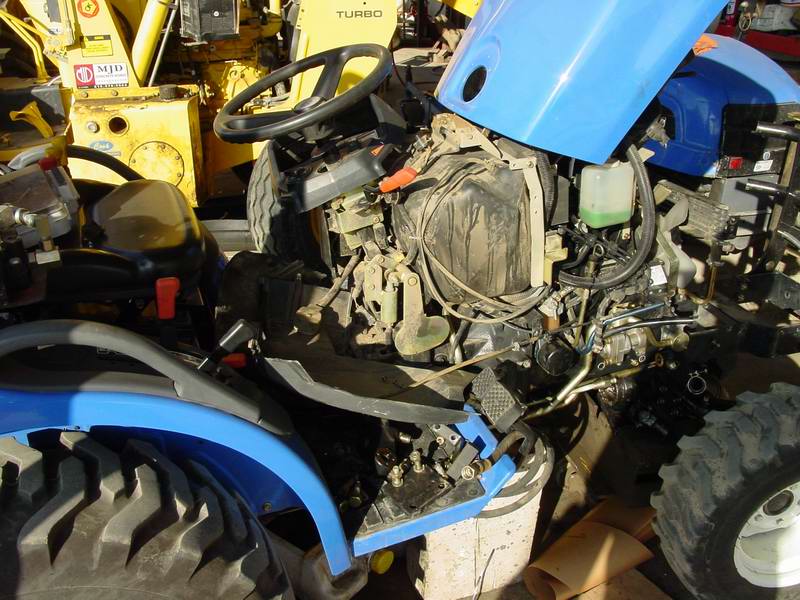

Picture 4 of 4
Excuse me I have to go throwup /forums/images/graemlins/frown.gif

I write this with great sadness, how can a good piece of equipment have so many problems and turn out to be such junk. Looking at the pictures it really does look like a pile of junk. I guess the service manager was right about it taking lots of time to replace an oil pan. Salesperson was just blowing smoke up my butt. As you can see from the pictures they had to remove the loader and the loader brackets, take out the battery, radiator, drop the drive shaft expose the steering column and remove the front part of the frame, just to get the oil pan out. I really am in disbelief how difficult a task it is to replace the oil pan. What you can’t see in the pictures are all the parts and hardware scattered everywhere and the dusty environment it is being disassembled in. The strobe system is a mess and the additional electrical cables are a jumbled mess. They even had to remove the exhaust system to get to the oil pan.
The service guy just shook his head and said “it shouldn’t be that hard” Turns out it used to be a whole heck o lot easier to change that out years ago.
I told my dealer if you split it keep it. My salesperson says the New Holland Rep will be here in early December and that I can meet with him at that time. I asked for a loaner but they have none, I asked for a new tractor and they said that would be up to New Holland and it would cost me money (lose of sales tax and down payment ect.)
Service manger is competent and assures me it will be assembled correctly and to my satisfaction but he did admit they end up with spare hardware all the time but they try to put it together good as new.
I wish New Holland was a member of Tractorbynet so they could take up the torch and see it through but it looks like I am dealing with a big corporation that talks the talk but has no intention to walk the walk. All I want is a New working TC 24D nothing more, nothing less.
So for all who own a TC 24D please go out right now and check that sleeve and make sure it secure or you too will be posting photos of your tractor in intensive care.
George
