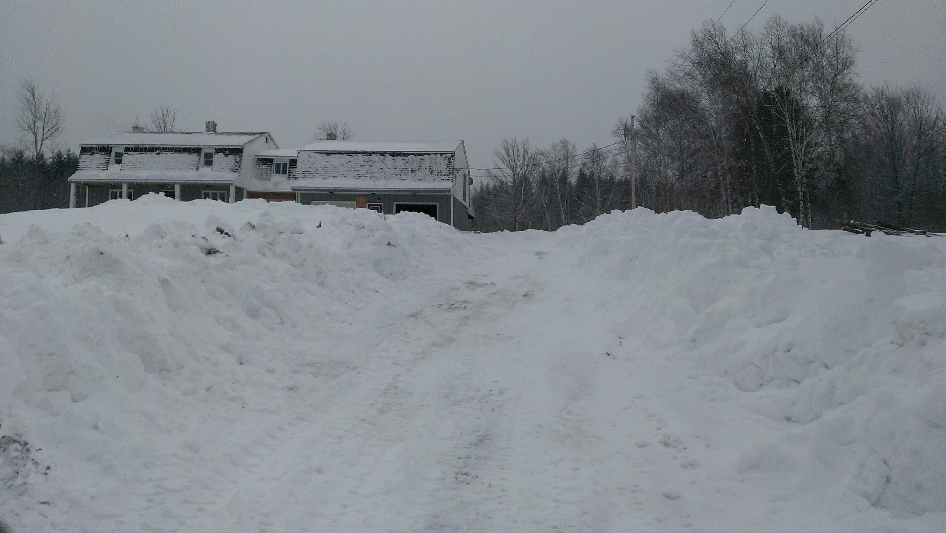

Yea, slow winter so far. Last year we got pounded with snow for sure! I get a ton of drifting at my house. My plow truck died halfway through the winter last year and I had enough and said it's time for a tractor!!!!! My neighbor and his Kubota bailed me out the rest of the winter. Here's what one of my two driveways looked like after pushing it back.
