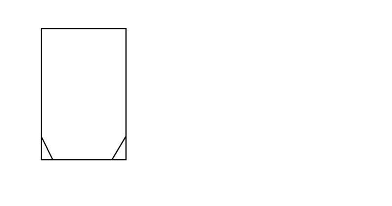

Could you fab a chute for the tailgate of your dump trailer, to neck down the rear of your trailer from 7 feet to 4 or 5 feet so everything would dump into your 6 foot bucket? Something like this? I'd think plywood would even work for a temporary solution.
