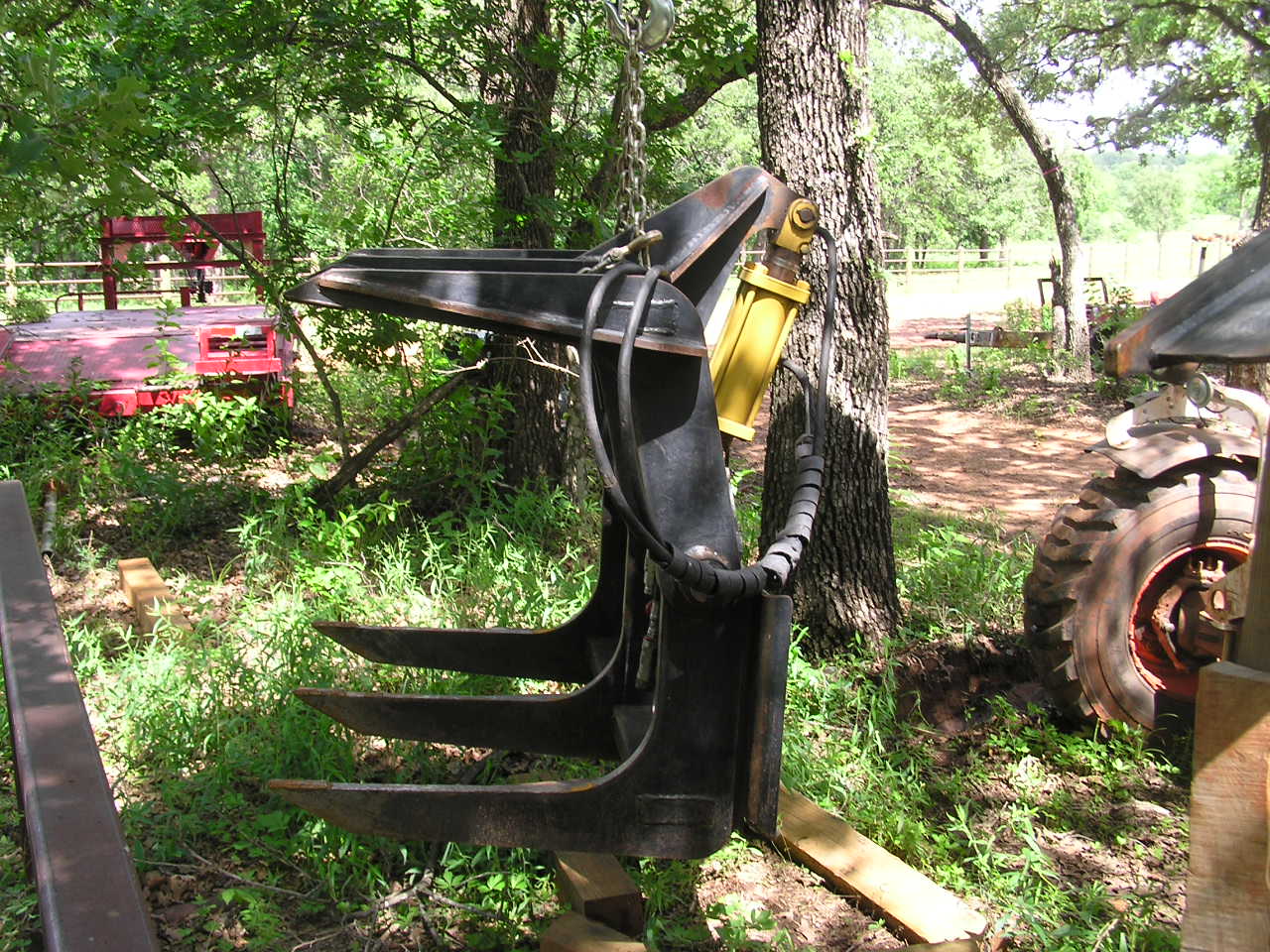

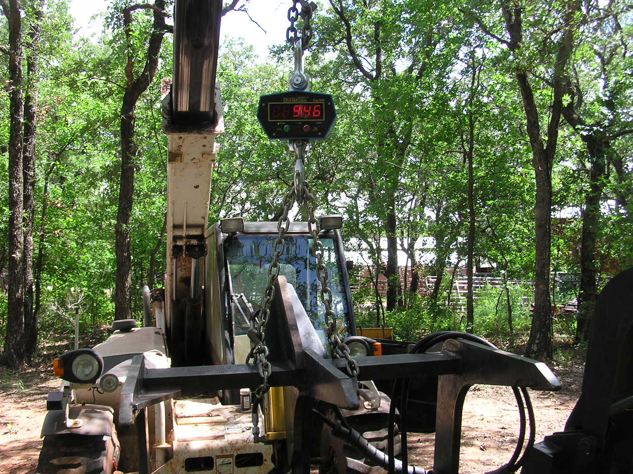

Yep, 1" thick and the frame that is tubing on most grapples, is solid bar on this one.
44" wide, weighs 946 pounds.

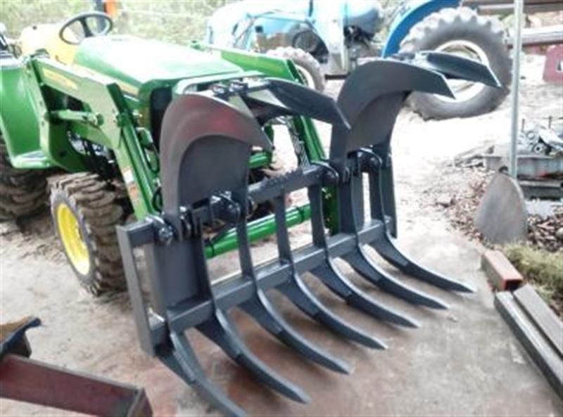

LC.Root_Rake_Grapple_Tractor_Attachment.IMG_20120601_083326-405x300 (Medium).jpg
www.TheRakeShop.com / Root Rakes Grapples Attachments & Skid Steers
