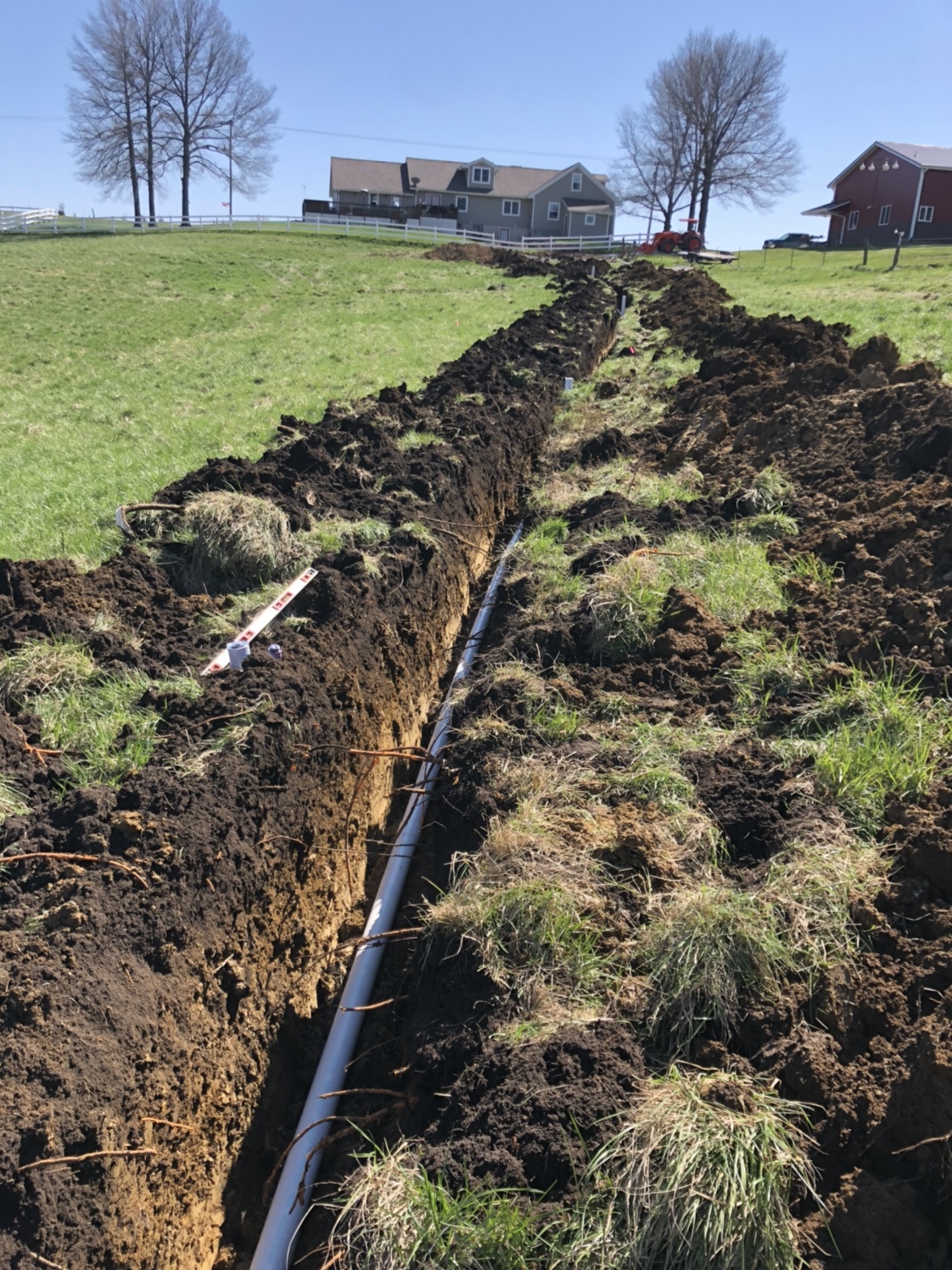

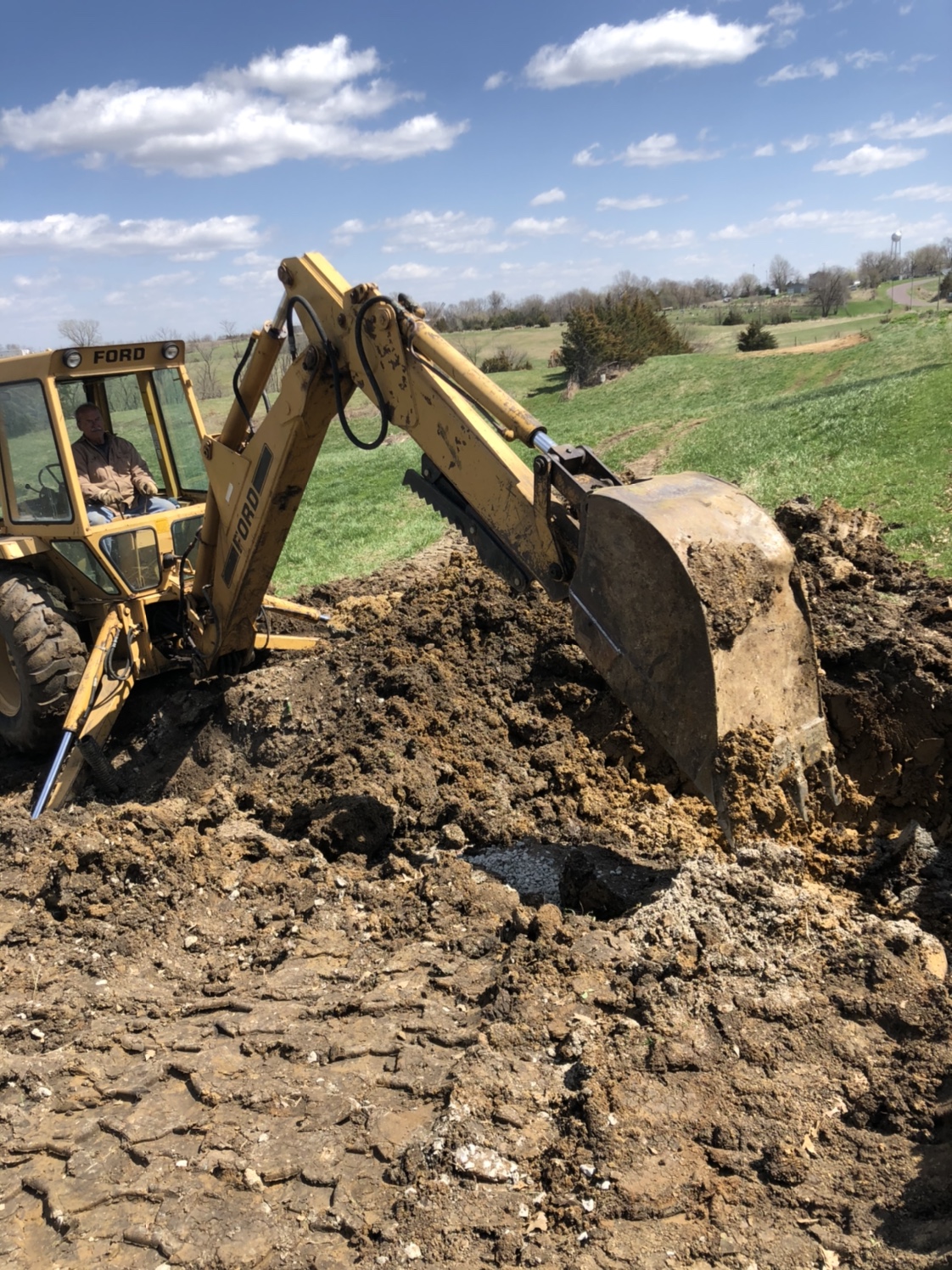

Richard brought his backhoe over and dug the hole for the septic tank today. Supposed to be here around 10:00 tomorrow morning. Got a couple of pipes spanning the hole for the night. Going to run a little over 400ft if pipe to get it back behind the pond. Last couple of years the run off has played **** on our pond.

#36
Tank installed, and 460 ft of pipe laid today! Still need to get all the dirt filled back in, but we were at least productive today. And I’m worn out! If my family had to depend on me to run a shovel for a living, we’d all be a lot skinnier! It’s been a great project, and after today I feel like we did it right! I like knowing what is going on from the house out now too! So many questions about what was happening before all of this.
