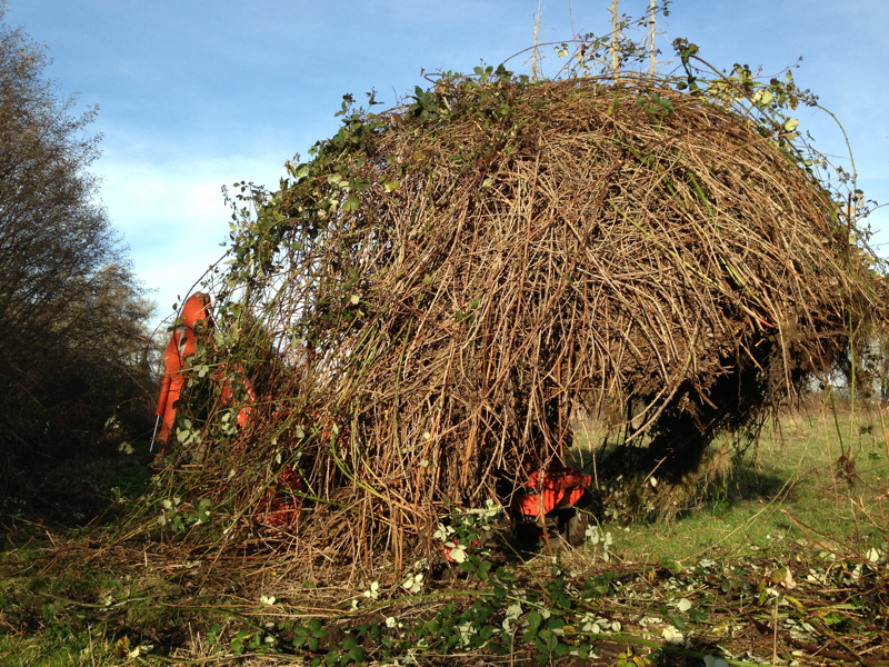

Where is all this brush coming from that you guys are filling your grapple with? .
The dirt. It grows upwards towards the sun. 60 HP machine underneath for perspective.

What are you guys doing with a grapple on a CUT that you need a large opening for? Most of the talk on here is it would be better for brush. Where is all this brush coming from that you guys are filling your grapple with? I think the main advantage of a larger opening on a grapple would be for handling a larger log (not very many here over 30'') or moving a larger stump (that a CUT may not lift). So my question is why do you need a larger opening for brush? It takes a lot of brush to fill my grapple. Are you guys moving piles around with your grapple? I think it is great that EA is going to be offering a grapple with a larger opening to meet their customers wants.
In my case the brush is coming from abandoned farm pastures on conservancy land that haven't been mowed in 20-30 years. Lots of briar and bushes as well as weed trees. I prefer to uproot and collect for burning rather than just bush hog as the bad stuff just grows back faster than good grasses. Also, if I can eliminate brush, other volunteers will routinely mow the fields with lawn tractors but they won't if there is a lot of stubble or debris as occurs with bush hogging.
