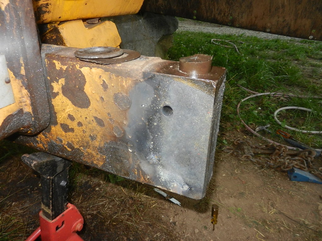

Is the pin hardened? If it isn't you could use a mag drill to get a hole through the middle. A half inch hole is enough. You might have to tack weld a plate to the beam to hold the mag base. With the hole you can use a standard Oxy/fuel cutting torch to split the pin. I had to do the same thing with the angle pins on a Cat D4 blade. They were about 2.250" in diameter. The previous owner had driven in pins and they had rusted in place. A 20 ton jack wouldn't move them.
I presume it's hardened. We had a mag drill on it and the pin just laughed at us. He had used same drill on the steel of one of the stabilizers (call it 1/2" thick) and I was amazed at how it went through "like butter" and it barely scratched this pin. Actually, that's about all it did was scratch it. You could see the circular scratch and that's all.

If file wont scratch it then it probably got harden from all the heating, if cobalt drill bit wont drill it then the only other drill bit to use is expensive carbide drill bit. I think lancing is still a good option.
It's not my drill but it was an annular bit (??) and I think it was carbide. Now, it might have also been dull!!
Still, it didn't work.

Caterpillar service has their own branded lance they use on service truck. They deal with seized pins often. Call your local CAT dealer about sending their mobile service tech to lance out the pin.

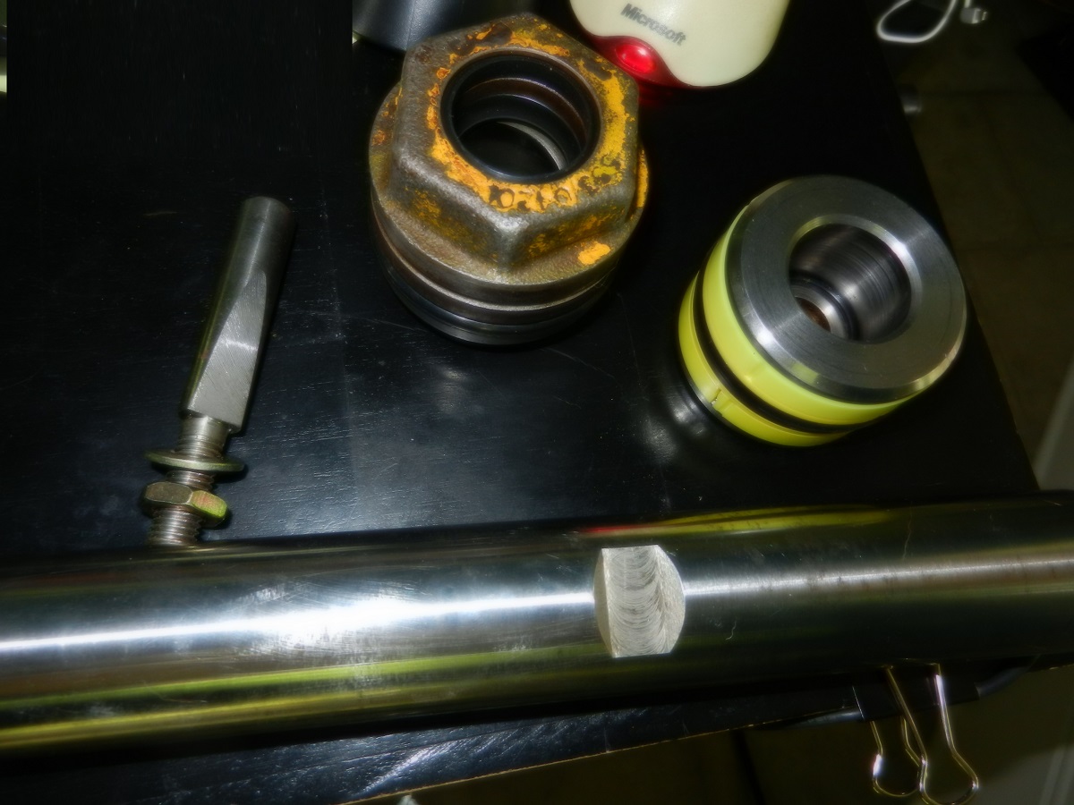

Yes - that tapered cross pin is what we call a cotter pin. What you would normally call a cotter pin, we would call a split pin. And remember any circlips(snap rings) you may leave under the bonnet (hood) or wing (fender) when collecting your spanners (wrenches):D
