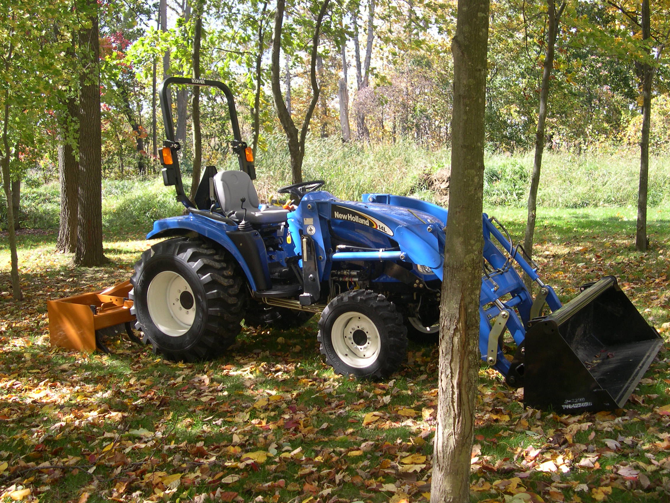

Here is a picture of my little tractor. Brand new. Didn't even scratch up the bucket yet.

NICE... Kinda envious of the Woods BB. Looks like the 65" is the perfect size for this tractor. What is your experience?

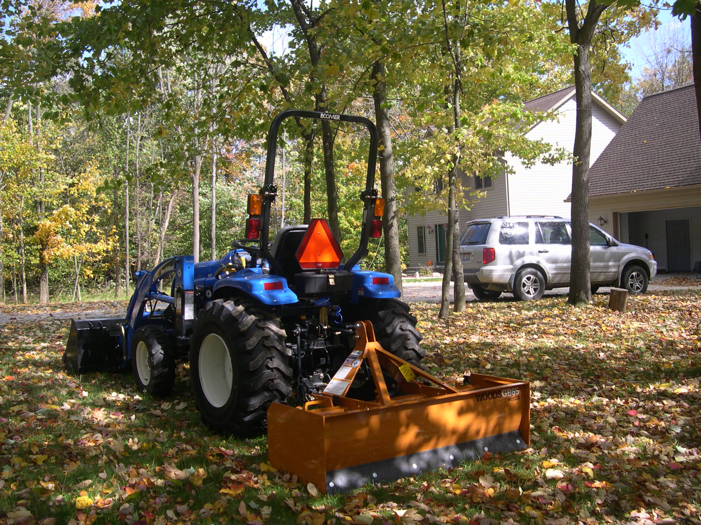

I was going to get a Landpride 66" or the Woods 65". That's about the right size. It covers the track of the rear wheels and not much more. A toothbar would be nice. So would a set of pallet forks. First thing I want to get is a snow plow for the front. Here is a picture of the scraper.

Thanks for the pic, think you made a good choice. I like a lot of the stuff Landpride makes, but am beginning to think that the Woods BB is just slightly better. Maybe its more of Gannon's reputation coming through.
