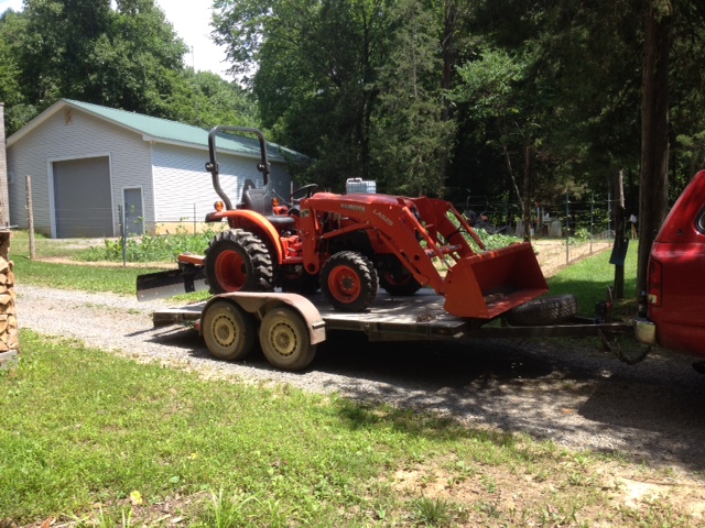

Picked up the L3901 today from dealer in Harrisonburg, VA. Nice unit! It is a little lighter than my L3130. Initial impressions are good. Have to get it hooked to the bush hog and see how it handles. SSQA, Filled rears, LA525 loader, Landpride RB1672, R4 tires.
