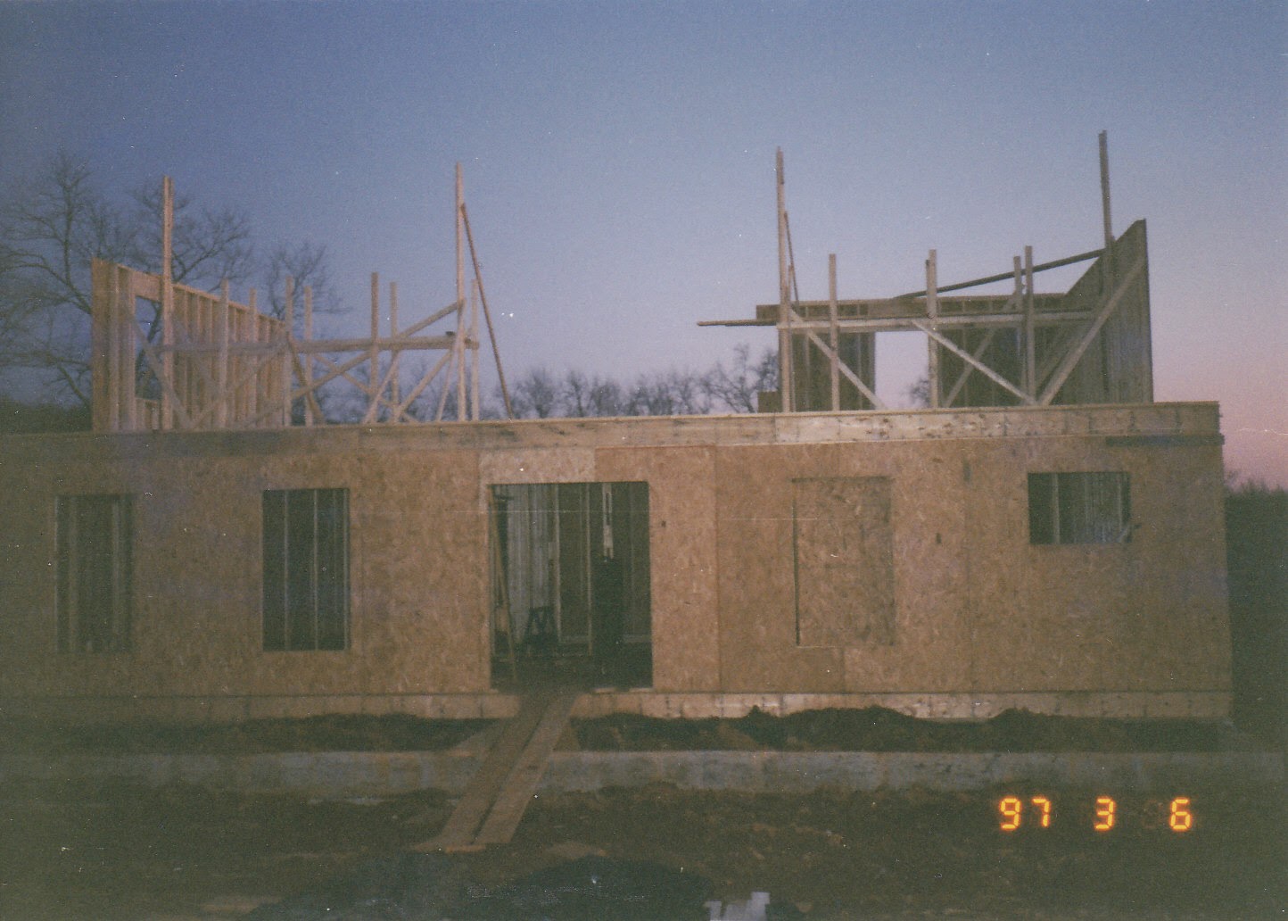

19970306 Thursday
bad news......
50 mph winds blew down 2 of the back wall sections. My wife found out before me, and was afraid to call me at work and tell me. She told me when I got home from work.
My neighbor saw it, and added more bracing to the left wall to save it.

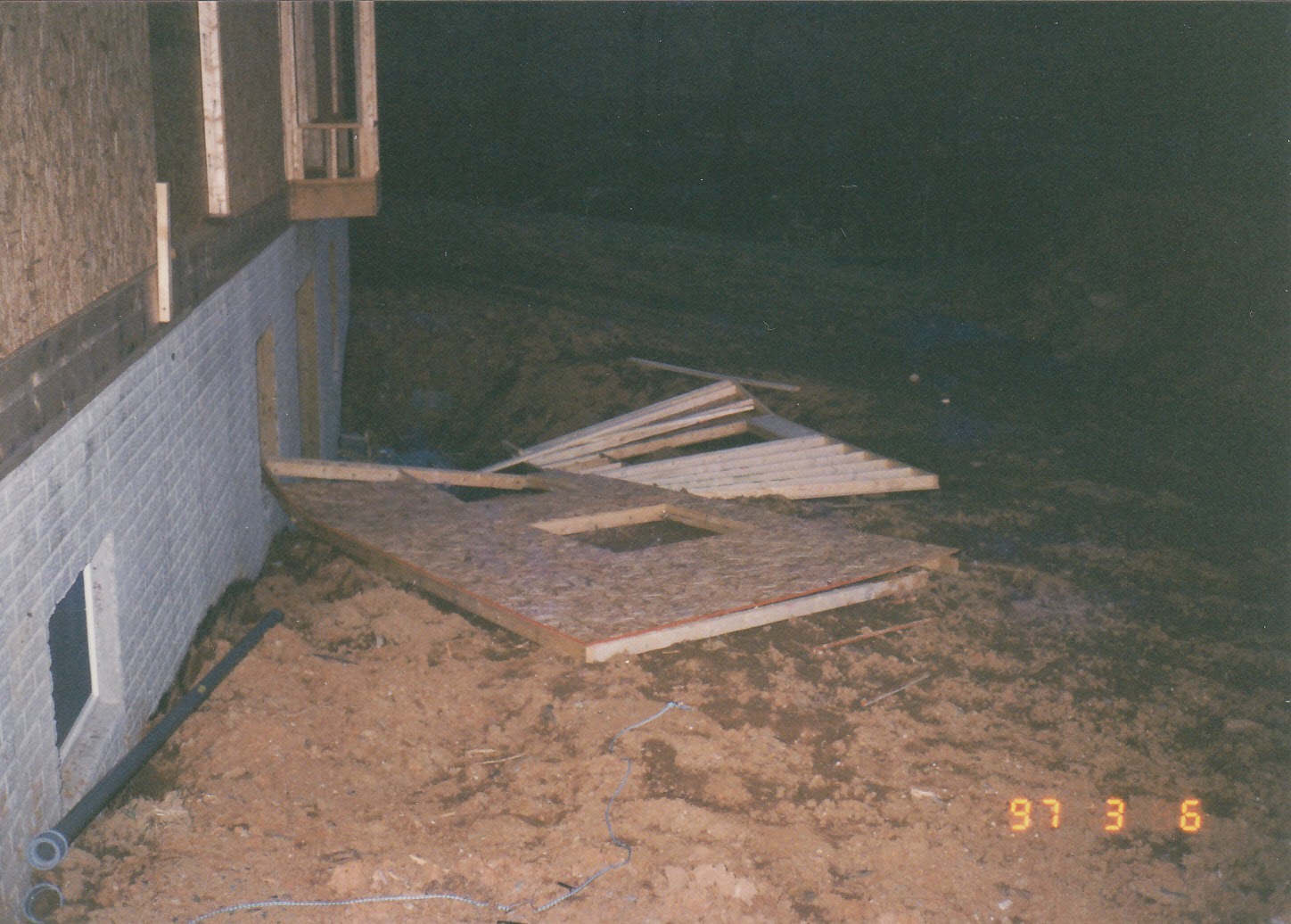

19970307 Friday
Took off work to repair the damage.
Was able to reuse most of the walls that fell. They weren’t broken too bad.
I pulled them back up onto the 2nd deck with a rope. My dad had brought me a 1” diameter rope in case I needed it. I threw it over the house, tied it to the wall header, and used my truck and pulled them up. I don’t recall how I managed to do this by myself, but I did. I did break the rope a couple times. The rope is still hanging in the back of my shed. My dad gave me some kidding about breaking it.
View from on top.
One section hit in a basement window opening and broke the bottom plate, so that got replaced.
The other one had a few breaks, but was also salvaged. By the end of the day, they were back in place.
At the time I didn’t analyze what went wrong. My theory, looking at the pictures, is when I stood those 2 sections and the left wall the night before, I braced them as always, but I had not nailed them together to each other. The right back section had sheathing attached that would get nailed to the middle section. I had to reach out the window to nail the sheathing that overlapped the 2 sections.
In the end I lost 1 day and a few broken pieces.

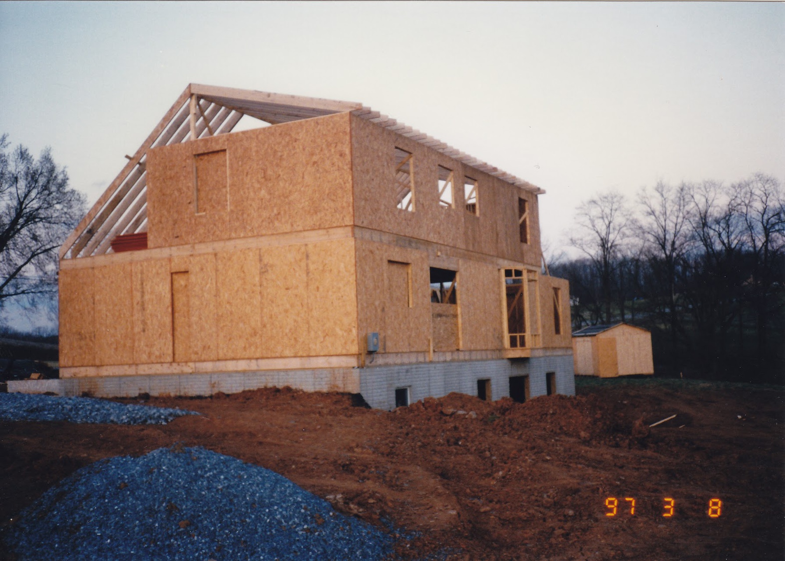

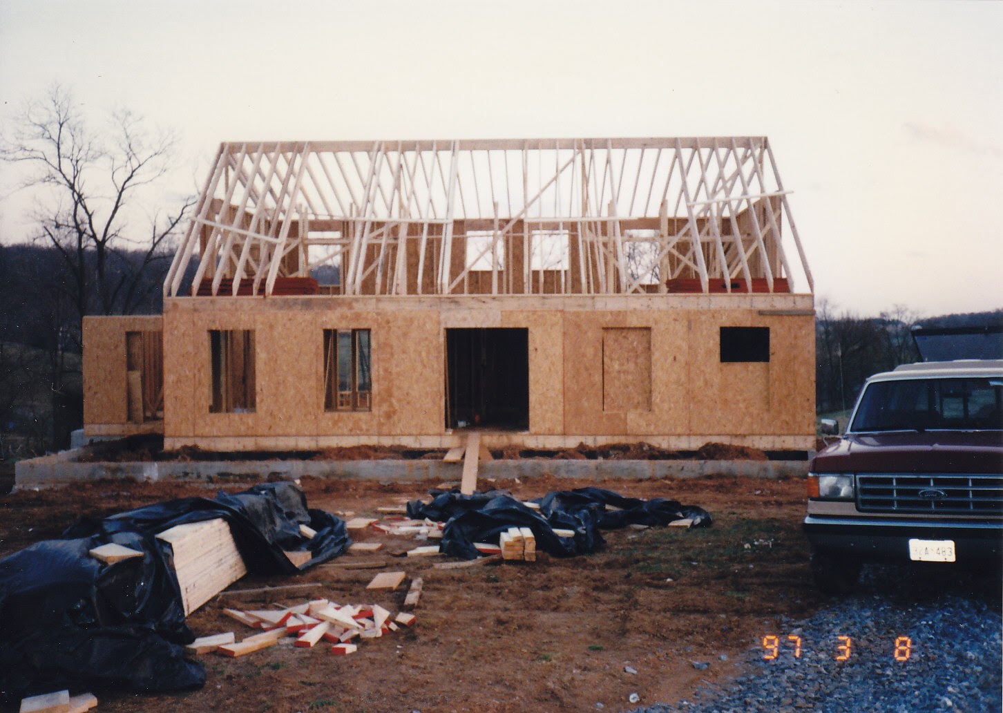

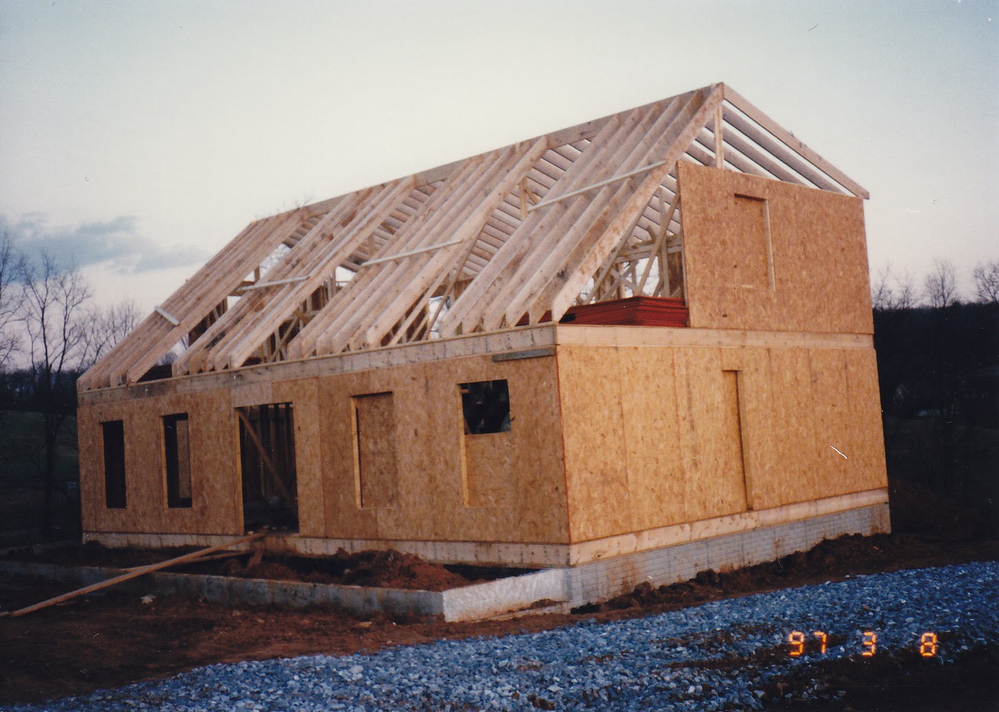

19970308 Saturday
Busy day.
Started by attending a church breakfast.
Had help from Don 10 hrs, Stacy 1 hr, Bert 4 hrs.
Installed all rafters on 2nd story except for where the dormers go.
