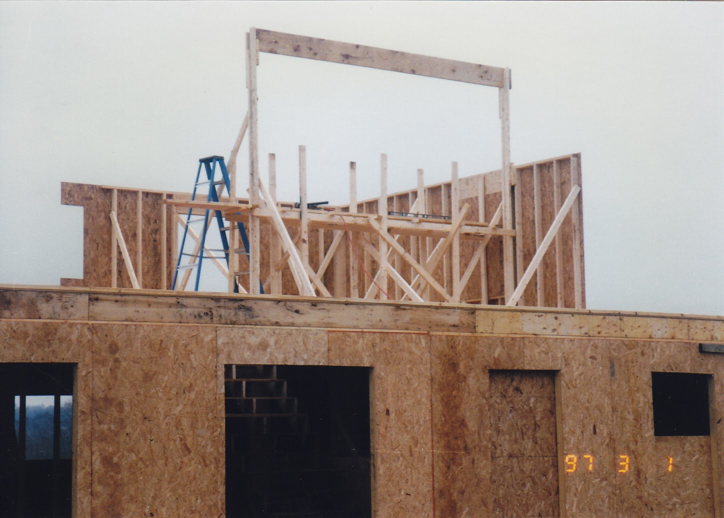

   / This day in 1997, of my house build #166
Setting those second story ridge beams is when you question the wisdom of having a two story house!!!!
#167
Setting the beam wasn’t hard, just built a pole with a pocket to hold it at both ends.

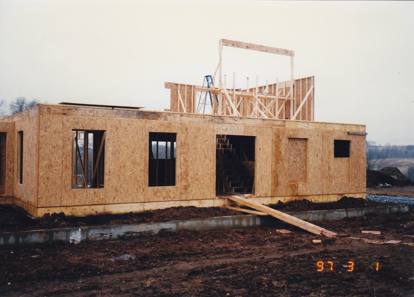

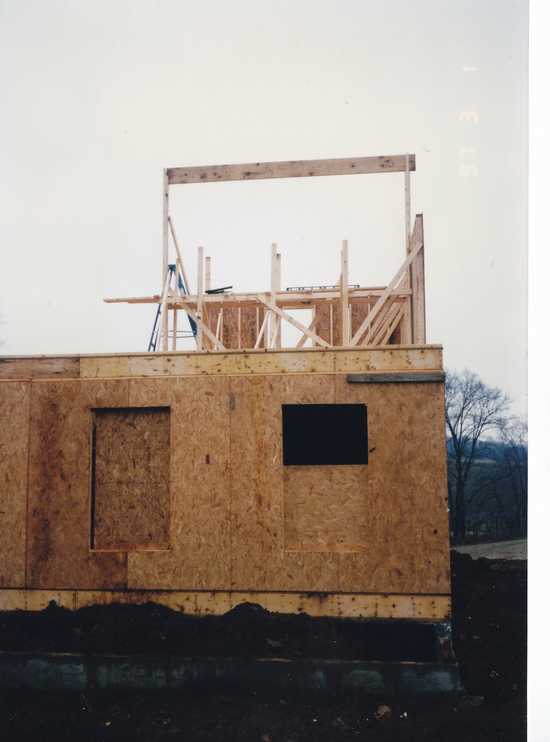

19970301 Saturday
Rain in the morning, so I installed the electric panel in the basement.
Installed temporary stairs to 2nd floor.
Installed right side ridge beam, cut and installed 1 rafter to check size.
