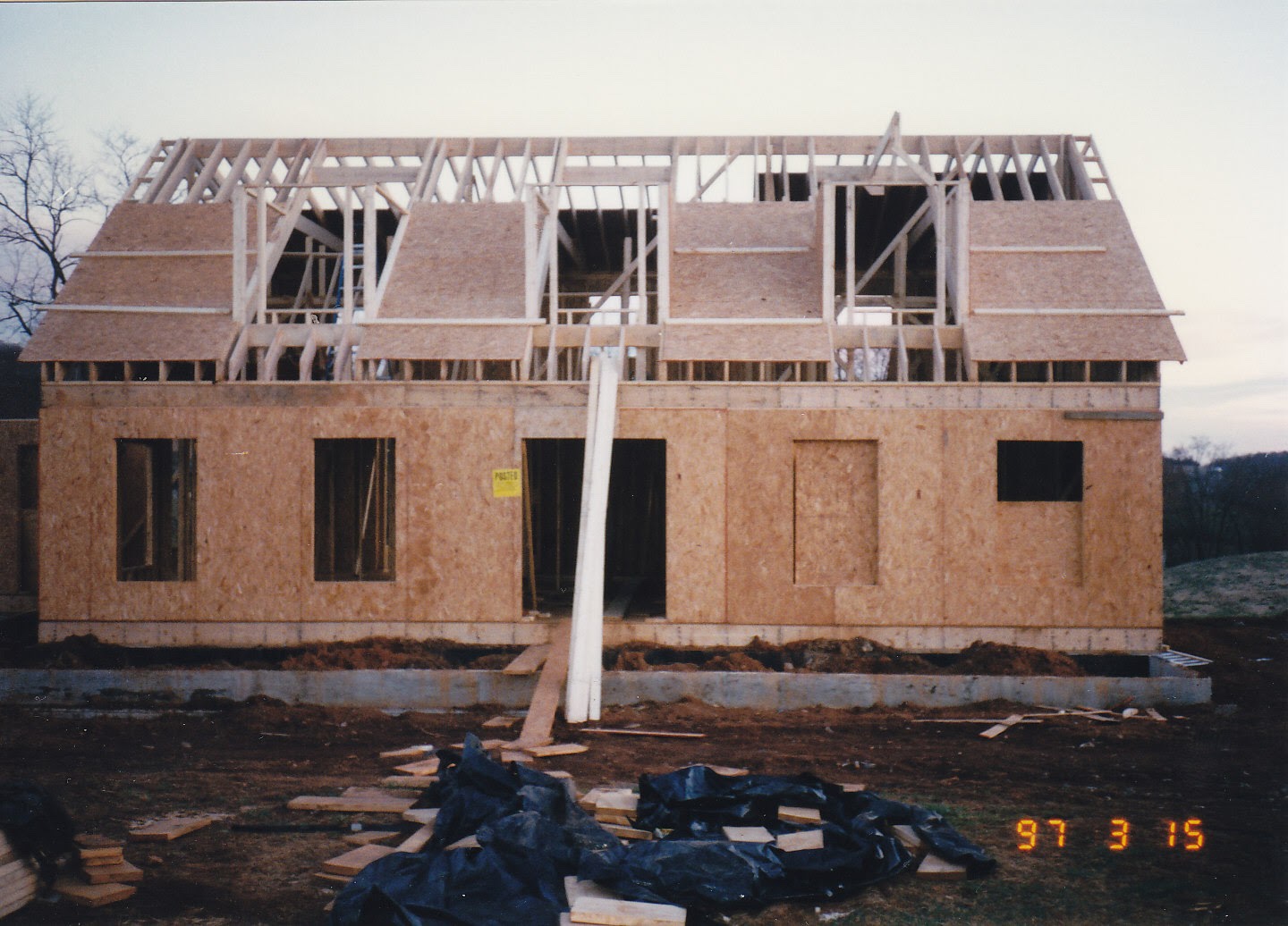

19970315 Saturday
Hutch helped 5 hrs
Closed up rest of right side of house.
Built 3 dormers except for rafters. The dormers end 2 ft from the edge of the house as I did not want them too long. Because of this the windows are raised higher than the other windows.

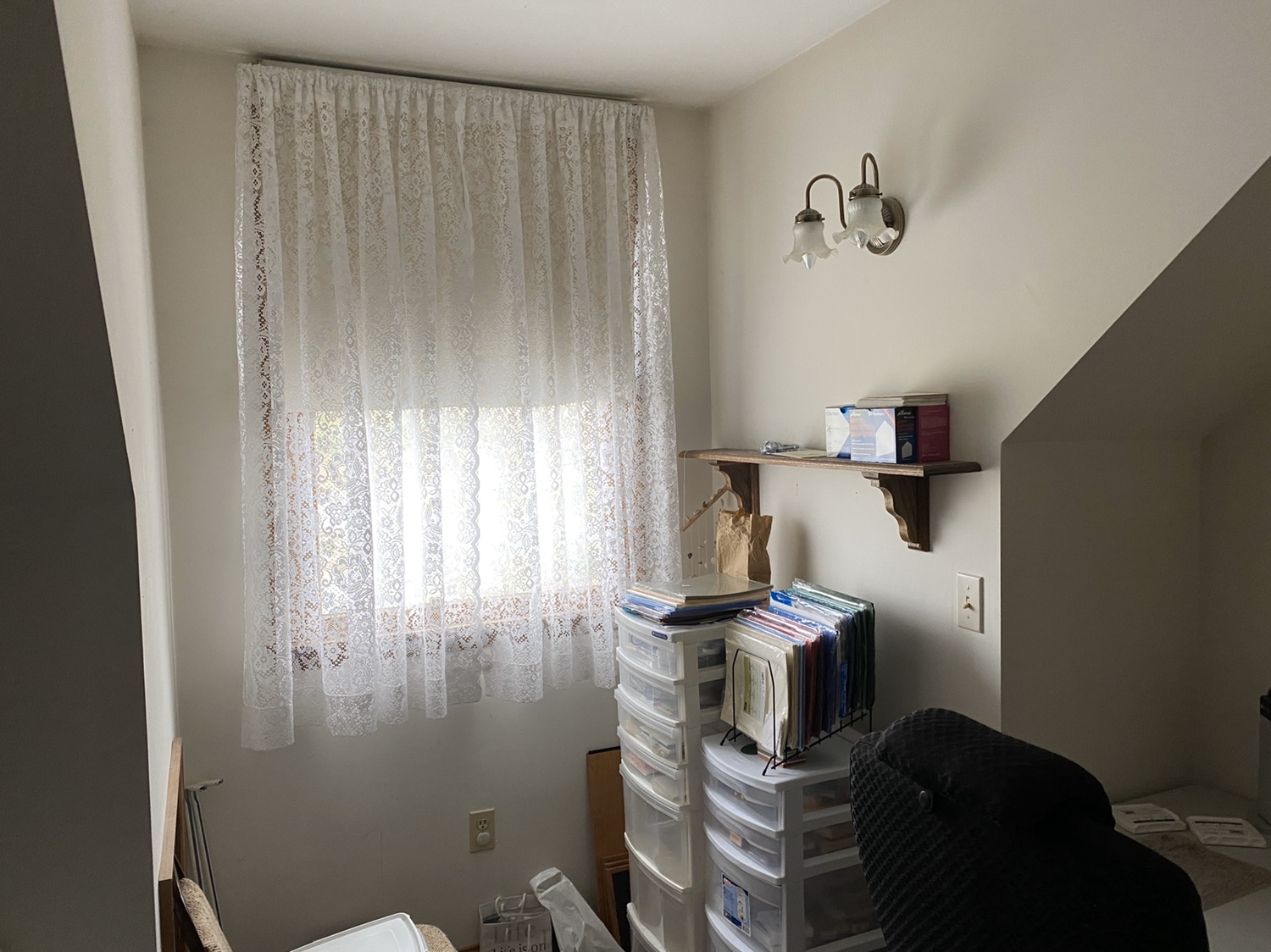

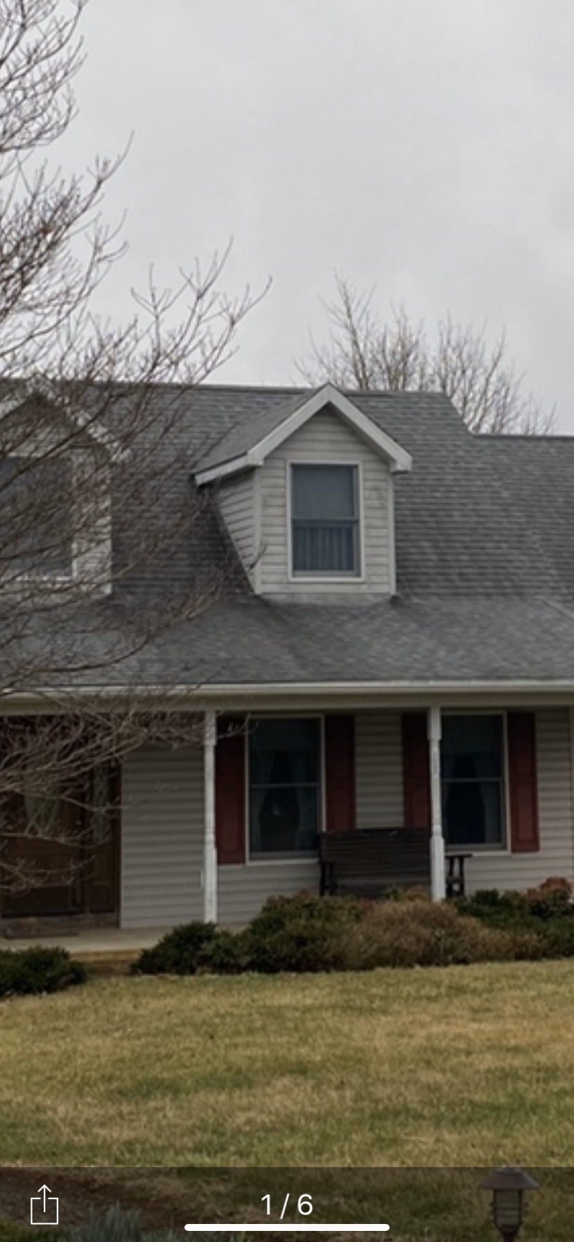

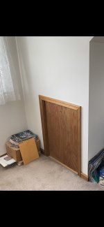

Dormers are 5’ wide functional space. Right one used to be the boys bedroom, now wife’s craft room. Front wall is at the 5ft height which I believe is code as lowest space allowed on a sloping ceiling. The attic space is accessible by doors in the dormer.
Middle is part of our walk in closet.
Left is part of master bedroom. There are access doors to the attic space

It’s a cape cod front, the dormer is in the front roof, which is why the ceiling slopes.
If the wall was full height it would be an ordinary box 2 story house which I didn’t want.
When I started designing the house it was 2 story plus a 3rd floor attic with dormers. (And a 2 level front porch). I decided that was too big. Then I dropped a floor, made the back full height and made use of all the space.

Here is close up of dormer from outside.

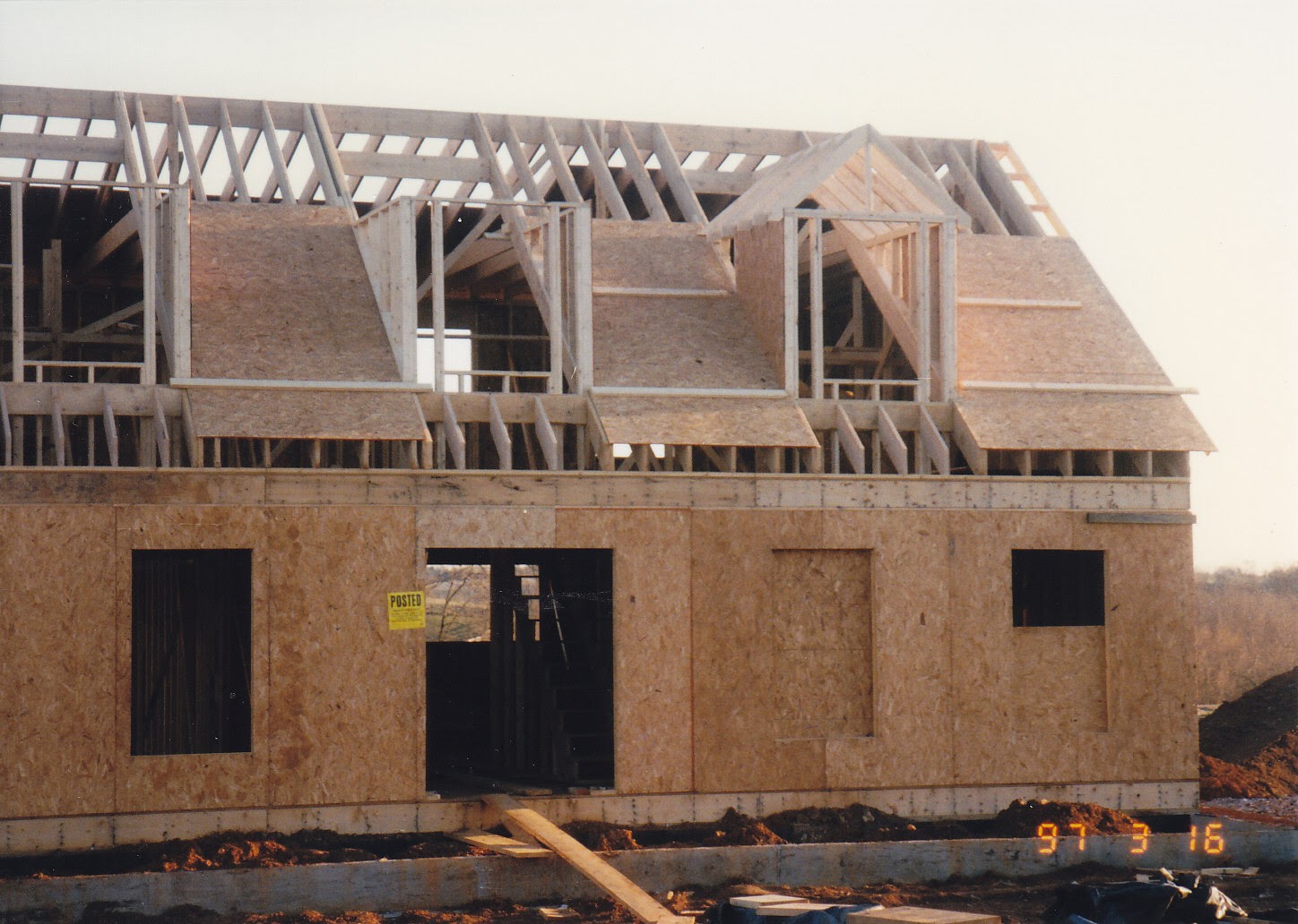

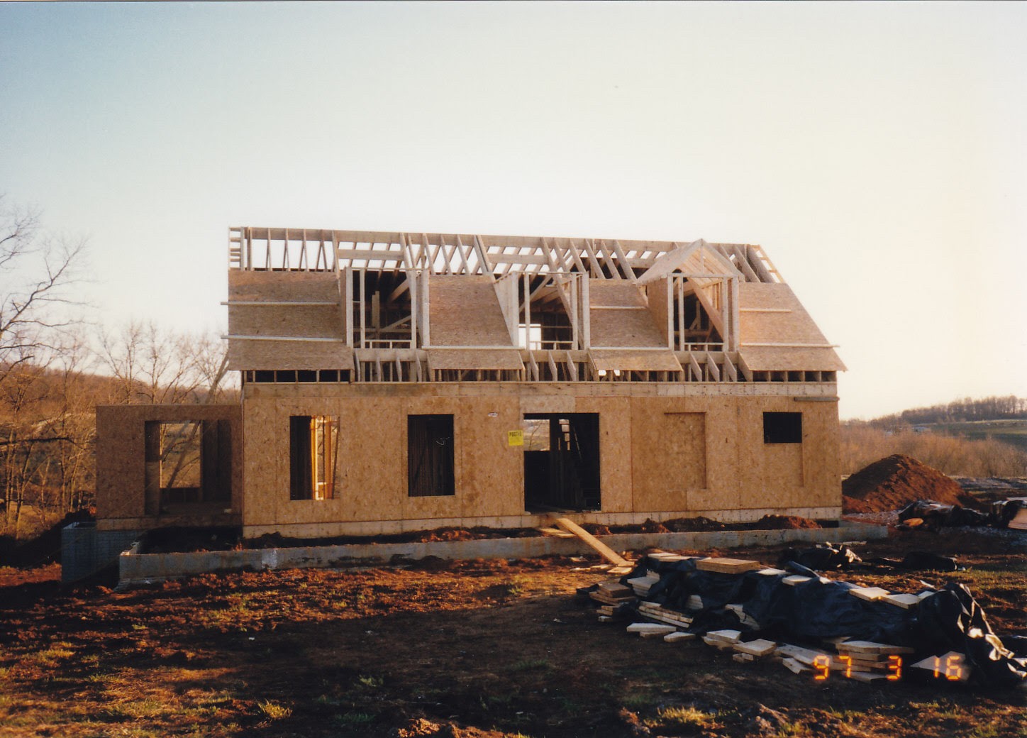

19970316 Sunday
Install part of rafters on right dormer.

19970318 Tuesday
Took day off work.
Rafters on middle dormer, done with 2 dormers except the overhang.
Got Electric Permit. Had to take/pass code tests for service entrance and house wiring.
