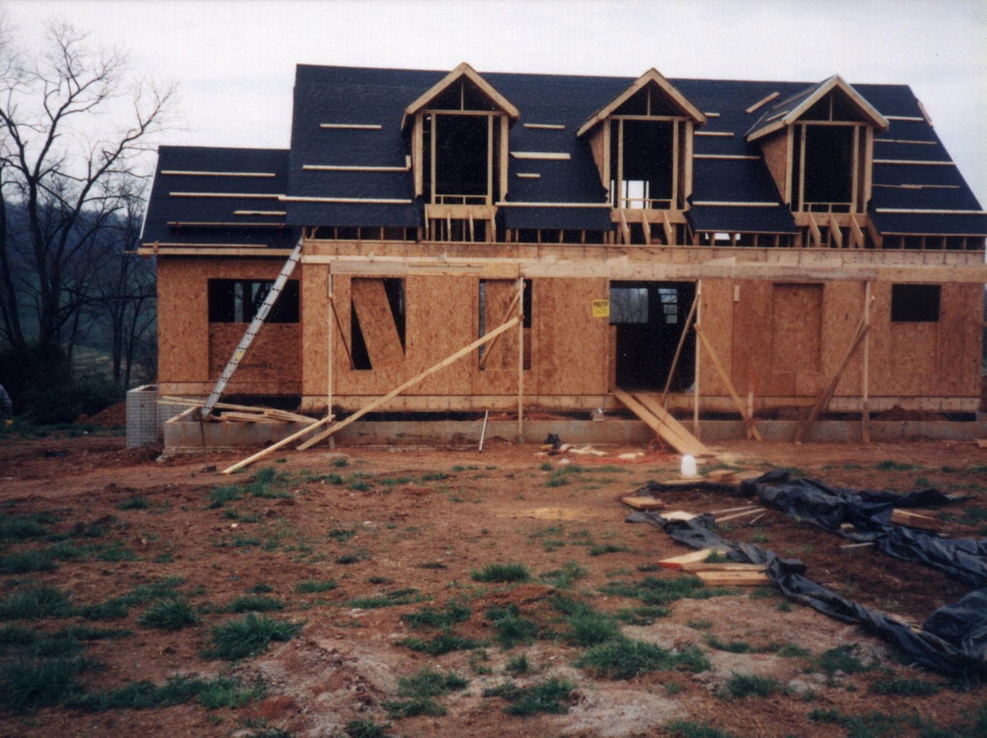

19970412 Saturday
Hutch helped 6 hrs
Dad helped
Work on front porch header till rain came, then worked on upstairs interior walls.
Moved window opening on upstairs left side. Since I raised the 10 ft extension, the roof line was at corner of window, so moved window closer to front.
Worked out well, as our bed is on that wall, and window is on other side of night stand instead of partially behind it.
