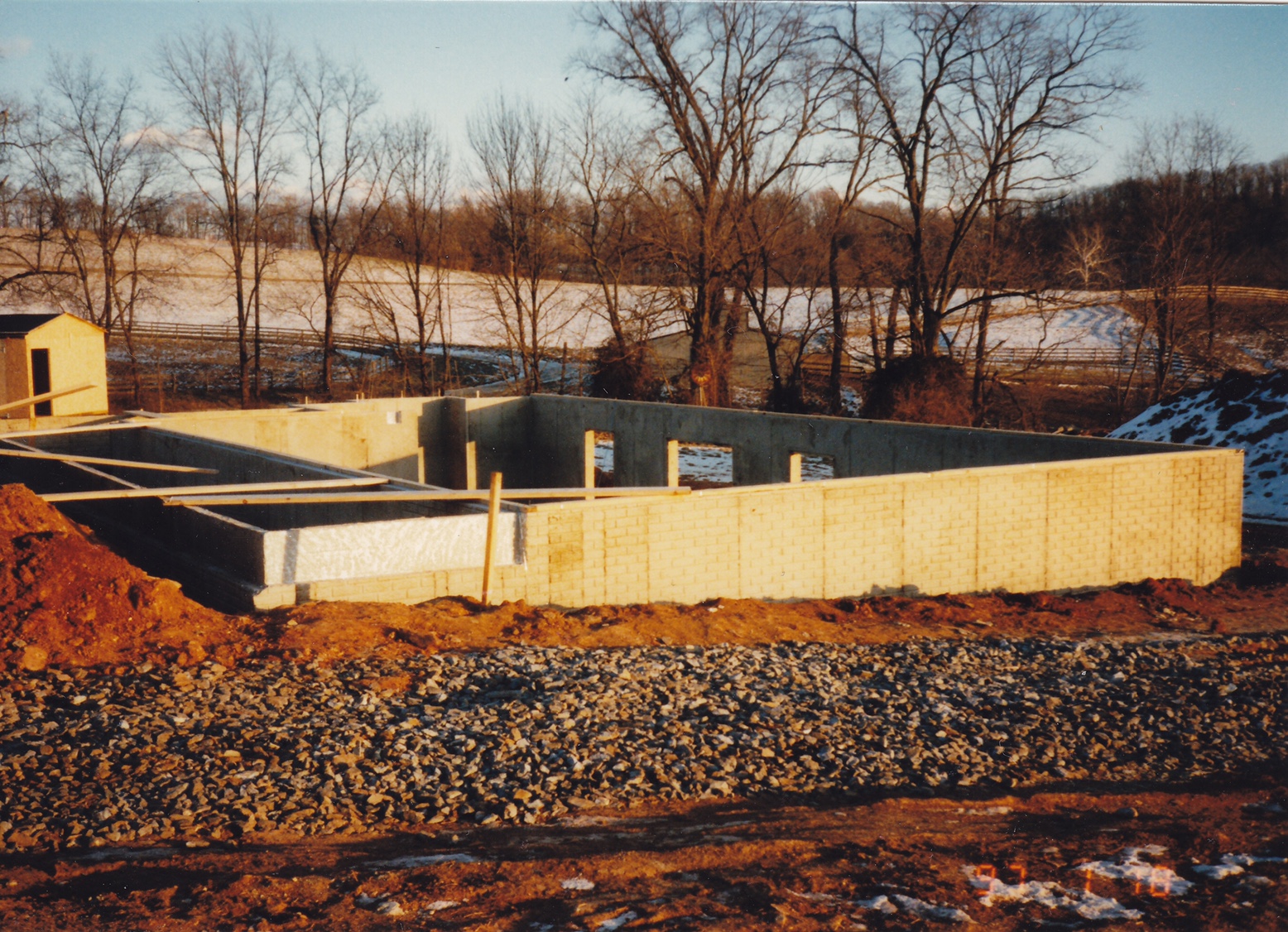

19970117 - first floor lumber delivered.
I used a spreadsheet to track every size of lumber required, including header material. My builder buddy ordered my first lumber, as he could get a much better price. IMG_3148.JPG
The basement forms were also removed by this time. To make the 4” brick ledge along the front of the porch, they put styrofoam inside the forms to create the void where the brick will go. Once the forms are removed, the styrofoam is then removed, as you can see in this picture.
Foundation walls are 8” thick.
